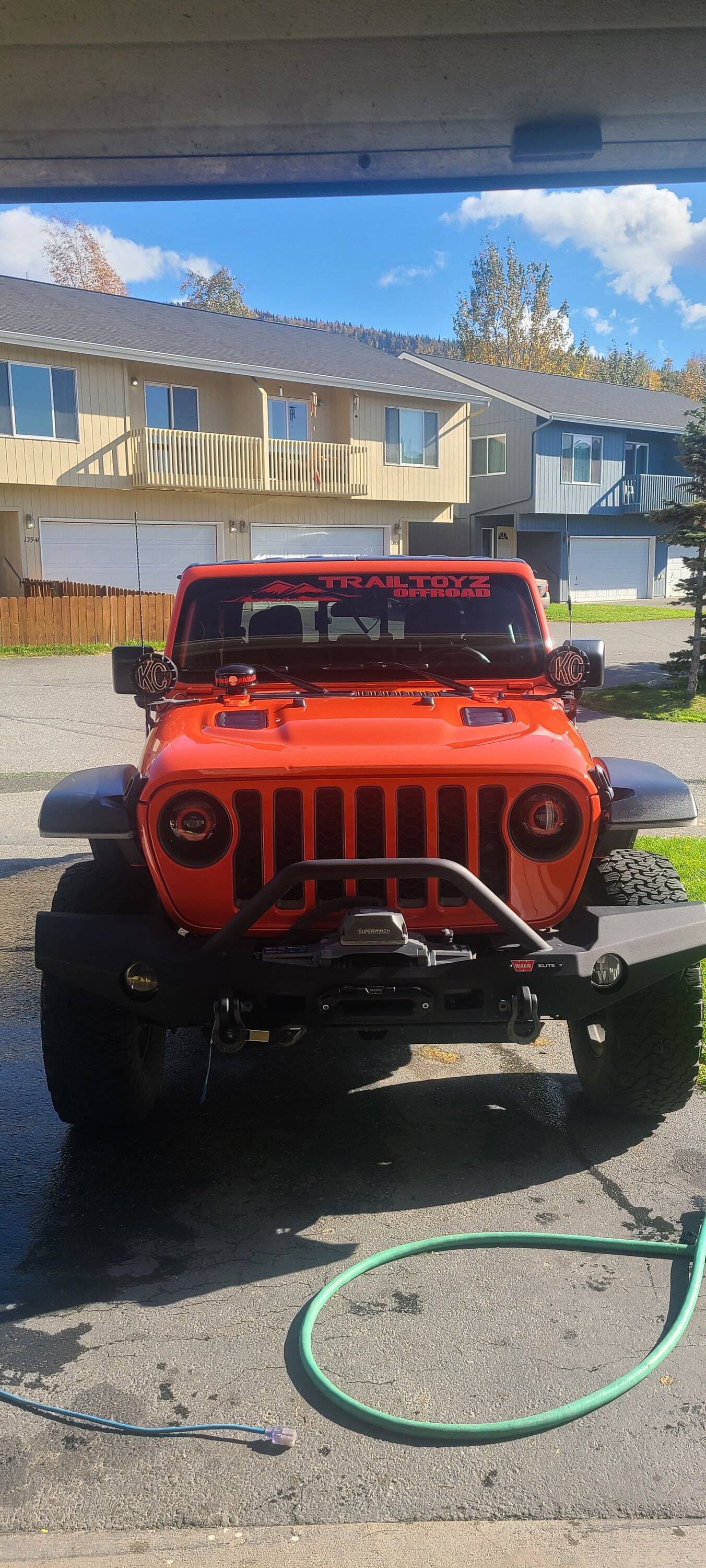

I bought the Hauk because it looked pretty badass compared to the competition. That and it didn't run externally where a tree would rip off a plastic snorkel. It looks a little goofy with the full extension but it looks a lot better than the big plastic ones. At least I think so. It's too bad they went out of business because they made good products for people who are offroaders.
Jeep Gladiator Diesel gladiator snorkel 20220917_145826
