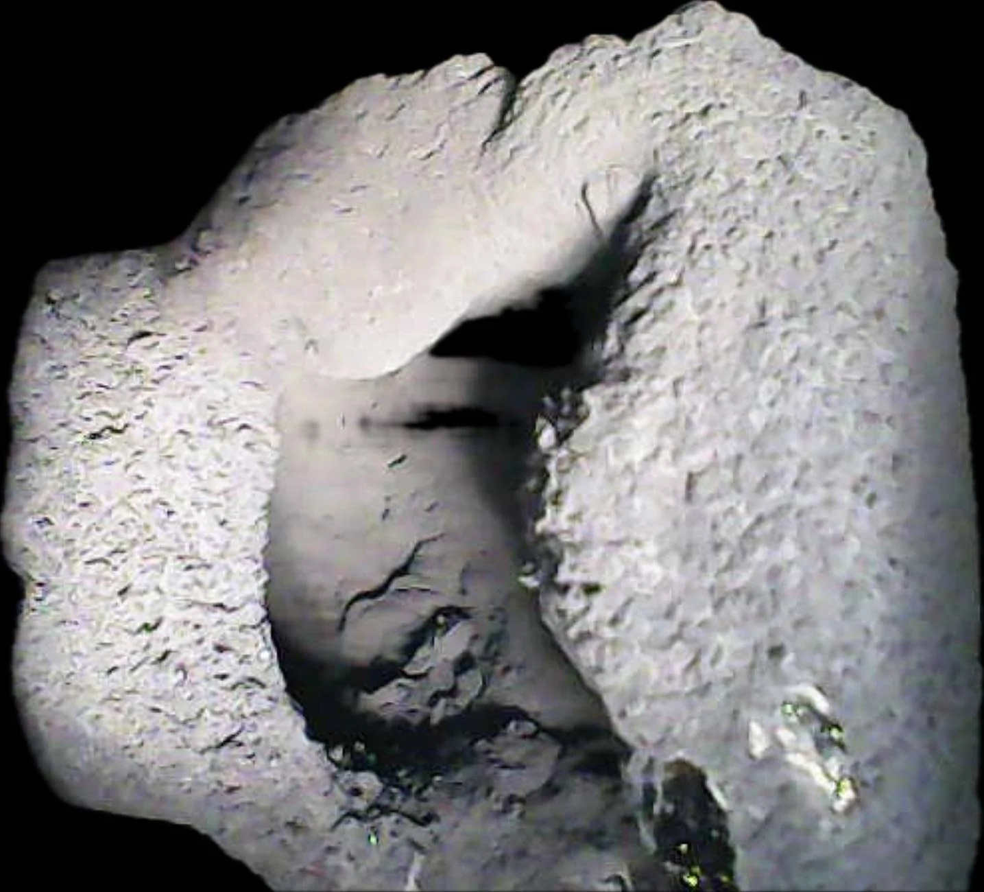

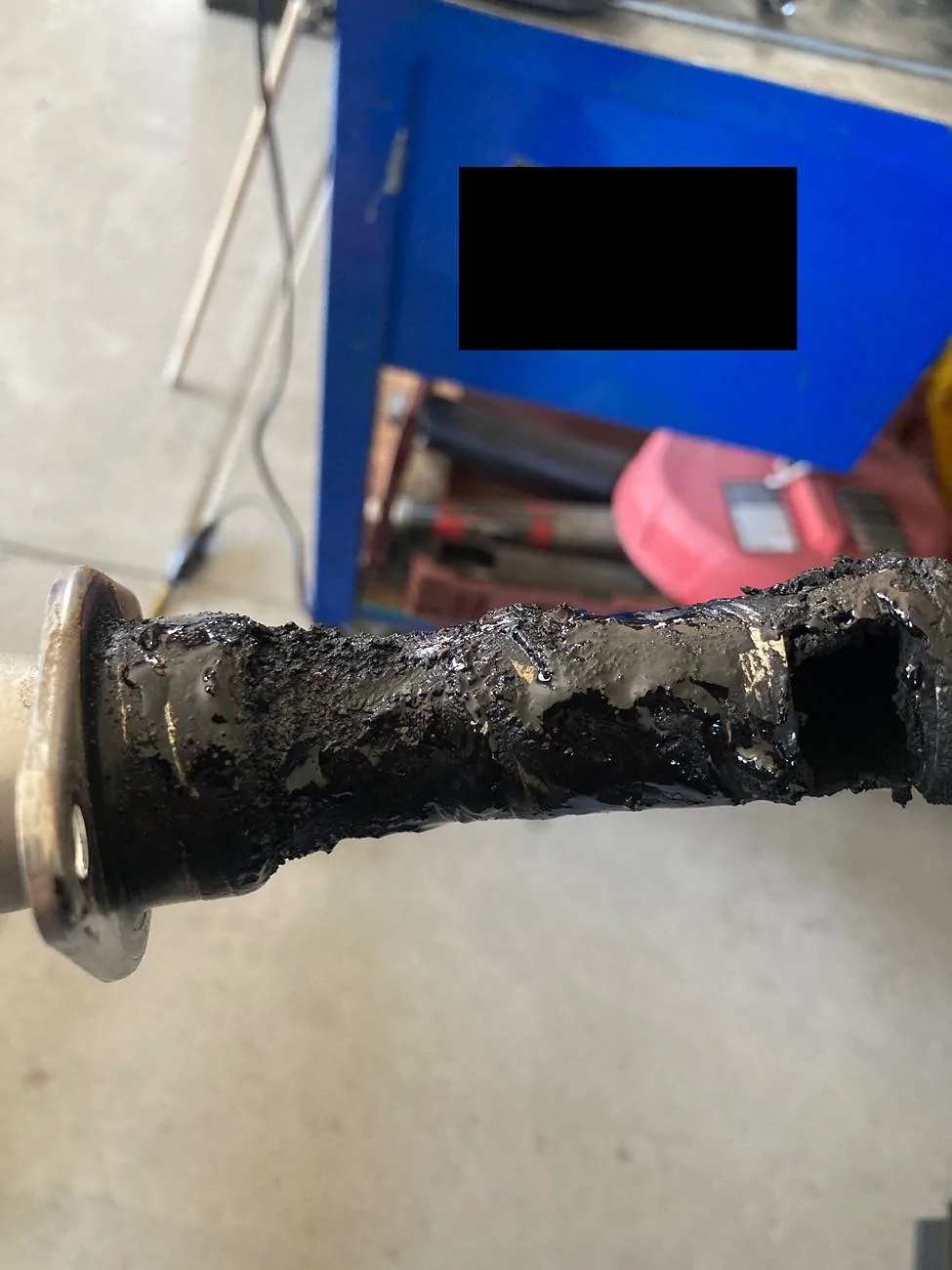

One big repair cost that will be ongoing with the eco diesel is the intake replacement every 100K or so.( P200A/B codes)I'm going to post an entire teardown and replacement thread when I do mine next weekend. parts are 600-1000$ by themselves and if ya pay for the work it will be at 1000$ minimum labor to get it replaced because the intake ports should be blasted as part of the repair as well as checking the EGR cooler since it will likely be near plugged at that time too. You can thank the EPA and Jeep for willingly producing something that now has an intake as a consumable item that WILL require replacement. Oh and it will likely happen right after the powertrain warranty expires like mine did and Jeep will tell ya to F' off on assisting in the cost of repair as has been my experience so far on all of the issues I have tried to get addressed. Most people that have experience with diesel know that they inherently cost more to maintain, but forewarning, the emissions systems required by tier 4 are destroying them prematurely, and the hidden/undisclosed ownership costs that I am starting to see are significant enough that I would hesitate to buy one again. It's not like the eco is a true tow capable workhorse like the one ton motors( which also share the same fate from EGR). I love my truck and plan to keep it and work these maintenance practices into it because I still can't get anything close to what I have from any other automaker, but it will be the last NEW jeep I ever buy. Jeep has become number one in my book thanks to Stellantis and the cheap out practices that make jeep truly junk from a longevity point of view..
Jeep Gladiator Purchasing Used Gladiator, WANT DIESEL EGRaug24
AUG 24^ before I cleaned it....
Jeep Gladiator Purchasing Used Gladiator, WANT DIESEL EGR 7.11.25
Today^^^^^
Today^^^^^
Today^^^^^
Jeep<------ I have been a six time owner, but after this^^.....πŸ–• πŸ–• πŸ–• πŸ–• πŸ–• πŸ–• πŸ–• πŸ–• πŸ–• πŸ–• πŸ–• πŸ–• πŸ–• πŸ–• πŸ–• πŸ–• πŸ–• πŸ–• πŸ–• πŸ–• πŸ–• πŸ–• πŸ–• πŸ–• πŸ–• πŸ–• πŸ–• πŸ–• πŸ–•
I’ll be looking for this write up. I’m running a diesel at 126K, and have been showing those codes for a little while. Still runs and still has power and great fuel milage, so I’ve been planning this as a post-season project.
