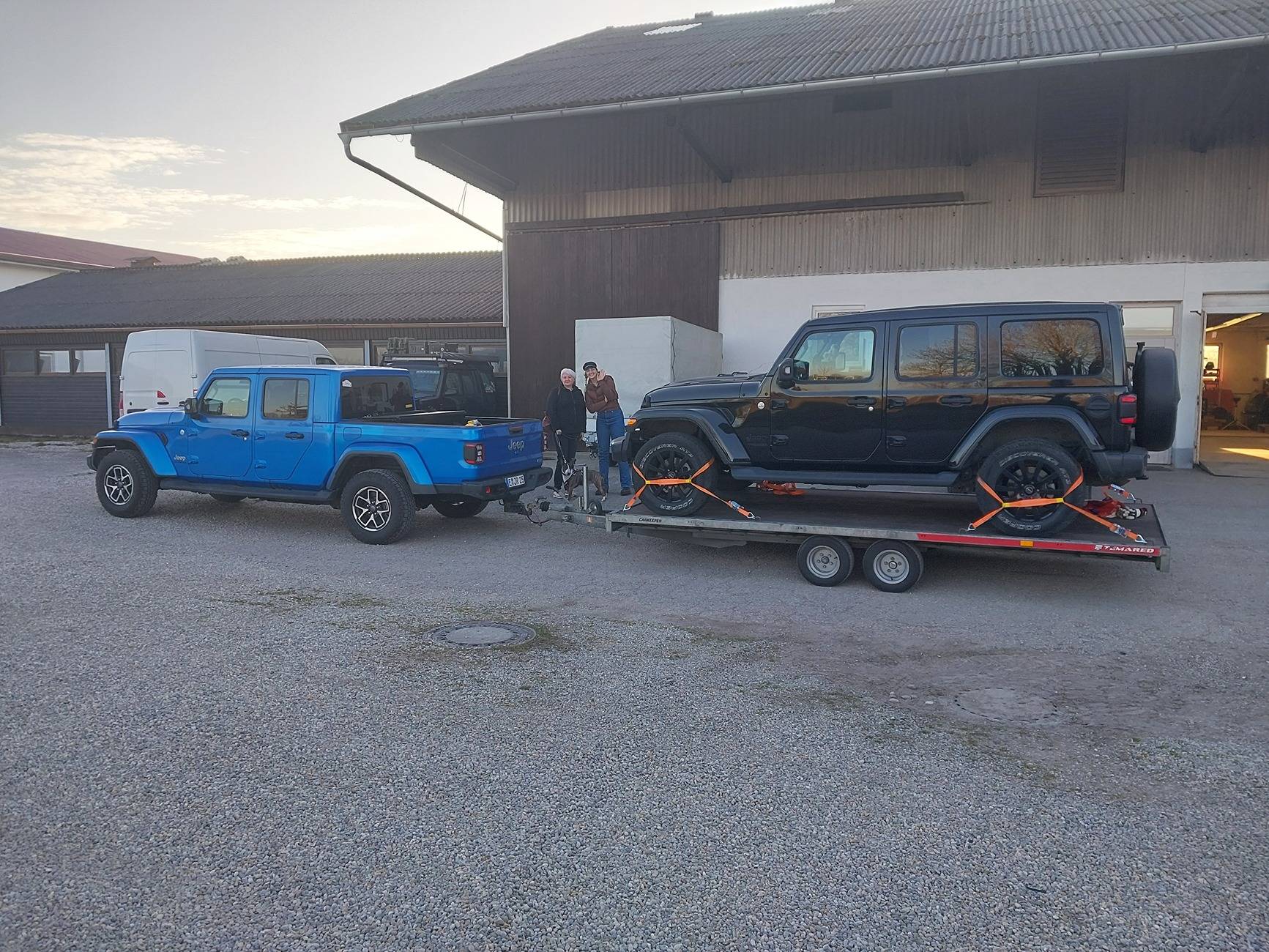

-What is your overall experience with the EcoDiesel's?
-Would you get the diesel again if you had to do it again?
-How has maintenance/replacements parts gone for the diesel engine since it is no longer being produced?
- Love it, great mpg, fantastic driving behaviour, no issues so far (40K KM)
- immediately
- No problem for me so far
