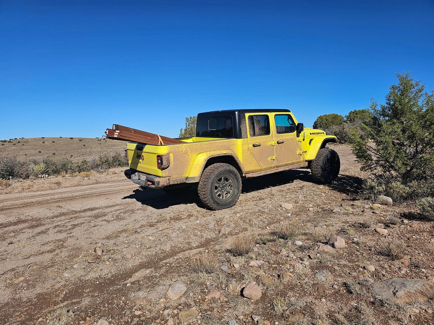

I know everyone says this, because logically being taller and less aerodynamic with larger tires would reduce those things...if they were the limiting factor in towing and payload. What if they aren't at all? What if the limiting factor for payload is in fact the very soft factory springs? Any aftermarket lift spring would actually increase the payload capacity as they all have higher rates than stock. What if the towing capacity is really limited by the cooling system and even there mostly because of the stupid Davis dam test that is required for towing certification and must be run when it's 100⁰ outside? If you don't tow up steep grades in the desert heat, I'd argue the lift and tires would have 0 effect on your tow capacity. All that being said, our Jeeps don't even get a GCWR rating on the door placard like most trucks so there's both no way to really calculate the difference from added weight or for a cop to try and enforce it anyway. The Jeep site is so terrible odds are even if you were hauling commercial and hitting the scales they'd only bat an eye if you were exceeding the max tow rating of 7700 pounds. The rest of us are never getting weighed. Nobody cares if you're still towing 7k with your lifted truck rated at 6k to start. We can't change the ratings either direction. Lowering the truck, putting smaller tires, heavier springs, and improving the cooling system would logically make it tow better and handle payload better... but doesn't change the ratings. Lifting it and putting bigger tires on it will obviously make it handle those tasks worse... but again doesn't charge the ratings. If there's one thing I've learned building our cabin it's that the JT is capable of hard use. From an 8400 pound trailer in my lifted mojave on 37s towed 600 miles including large grades without issue (the largest gains 4k feet in 20 miles but I ran it at night in the winter so heat wasn't an issue) to 1800 pounds of pavers in the bed 50 miles including the 20 miles of washboard dirt road. The metalcloak 3.5" springs haven't batted an eye.
Jeep Gladiator Diesel JT Ready For New Gears ⚙️ 20250212_135703
Jeep Gladiator Diesel JT Ready For New Gears ⚙️ 20251124_124516
