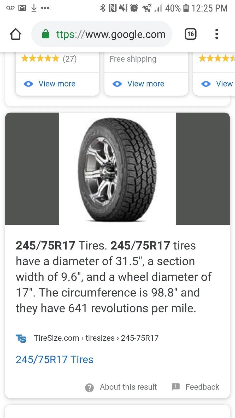

I think all the springs & control arms are the same length just different spring rates the shocks are different on Rubicon, if you read the specs Rubicon is 11” clearance & all others are 10” so the tires are bigger on Rubicon 33” vs 32” & front fenders on Rubicon are what 2” higher or 1 1/2” I’m not sure.
To gain an inch in ground clearance the tires OD would have to be 2" greater, gain is in radius or 1/2 of OD

All of that being said, I would assume the lowest point on the differential would dictate "ground clearance" at it's lowest point, because it they mounted anything body related lower than that, they rode the short bus to work. OR the tire on the Sport/S/Overland is a 29" tire (which is most likely the case)
bgenlvtex
Bruce
Jun 8, 2019
1,314
1,971
Texas/Alaska
2020 JTR
I get it,(although the important number is static loaded radius which is not shown) but here is reality.
If the lowest point considered for "ground clearance " is the bottom of the differential, you can put springs in all day long and not change that.
Now, like I said, if something mounted to the body is the lowest point then that obviously isn't true and springs would affect "minimum ground clearance", but if someone at FCA "engineered" a body fixture that is lower than the bottom of the differential on a Jeep, they need to be beaten.
Something isn't kosher with the advertised tire dimensions ETA or ground clearance one or the other.
