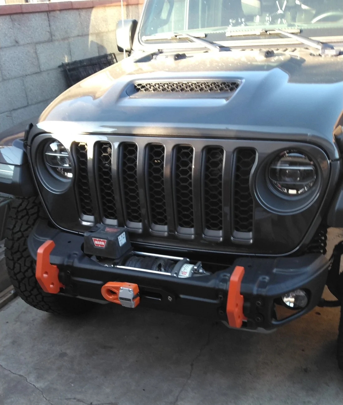

I have the Arcus front winch bumper with a Warn M8000S. It's been on my 2021 since 2021, when I bought the truck new. First mod that I did to the truck.
Painted the Arcus tow hooks orange and never looked back. No front skid plate trimming. I bought some 1" spacers for the front springs to bring it back to stock look but I haven't installed them. Front end dropped about 3/4". It's Rubicon factory height with the winch. I don't wheel this truck hard and it's my wife's daily. I never noticed bottoming out, truck still rides like a dream. No issues at all with the original shocks. Haven't touched the suspension. We don't drive it like a desert race truck, because it isn't.
I used some kydex to cover the backside of the driving lights because they are exposed to tire splash and stones fling on the Arcus bumper.
Almost 70K miles on the truck now, and other than batteries, nothing has failed. Put new 35" Falken AT4's on it a couple months ago. No rub. Original Falken AT's lasted 66K miles. Never seen a AT tire last that long, so bigger Falken AT4's it was.
