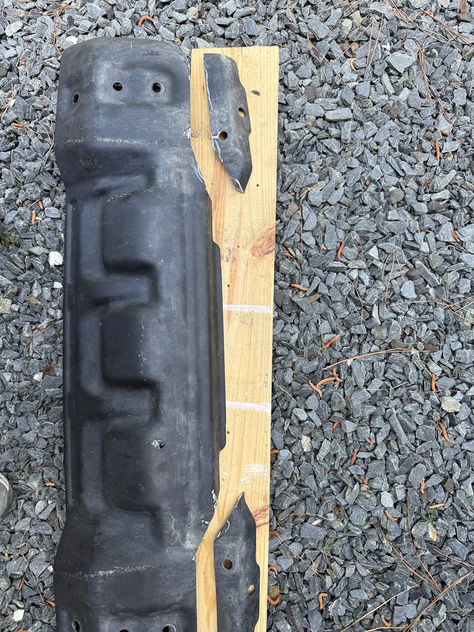

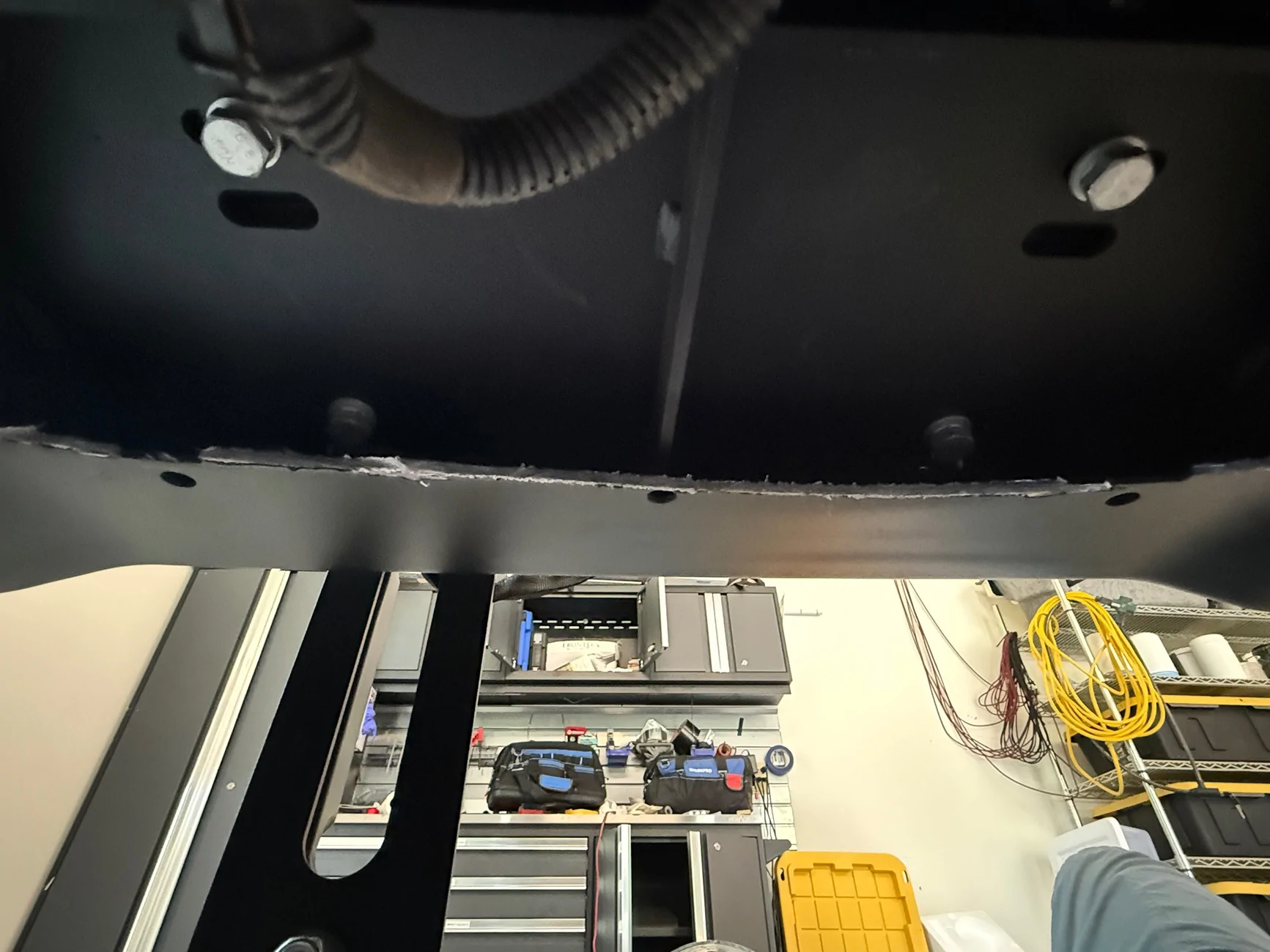

Were you able to use the OEM skid plate?
Short answer yes but I had to trim a little off the corners of the skid plate ( on my rubicon) as well as some small tabs on the aluminum bumper on the bottom.
Here are a couple of pics of what I did. I still have to paint the trimmed areas before I do the install But I’ll post a completed picture when done (probably tomorrow).

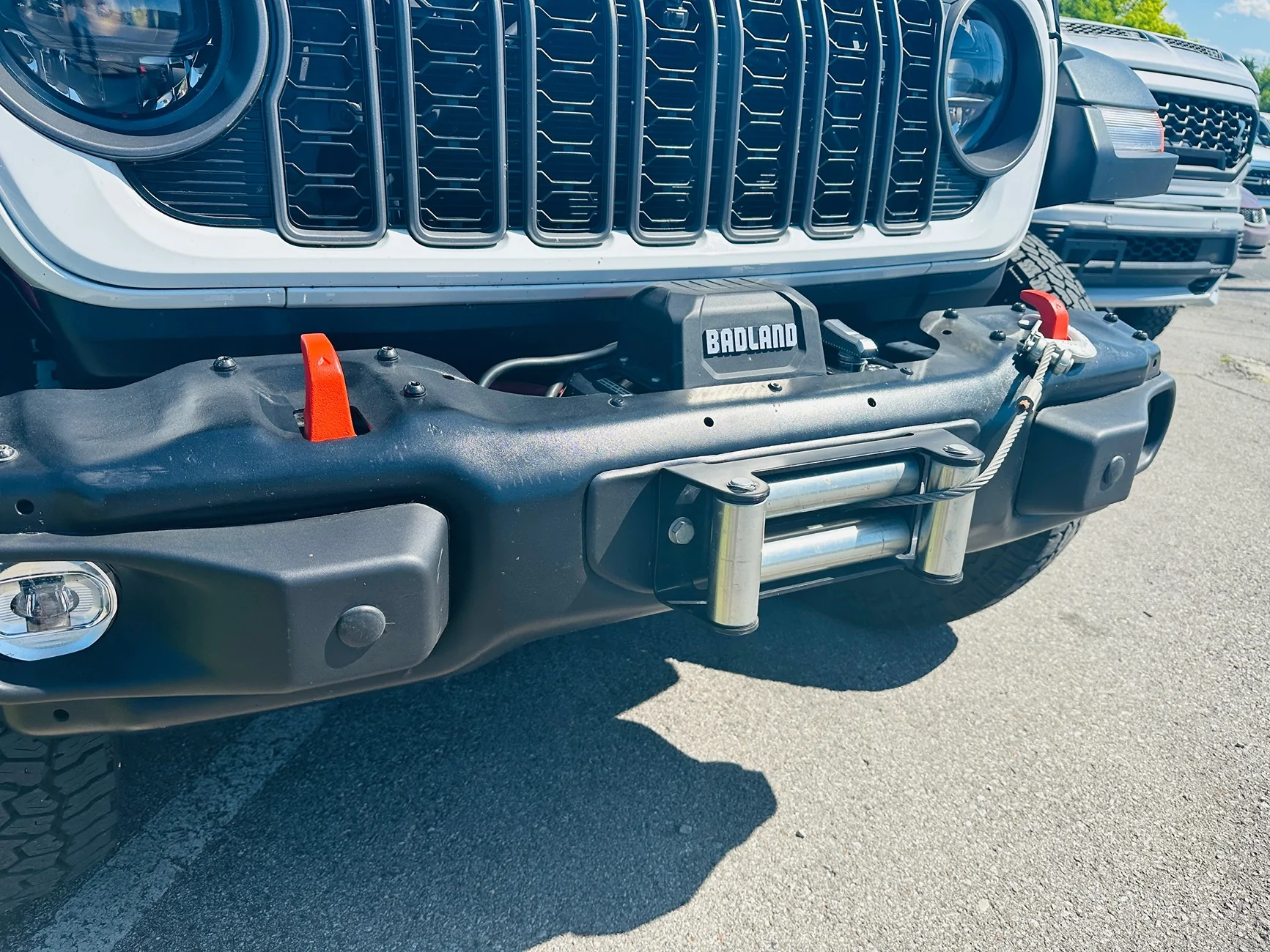

There’s a thread here about using the eBay aluminum bumper with a winch.
I decided to give it a shot as I
like the OEM look but didn’t want the weight of a steel bumper.
Im almost finished (just have to tiddy up the wiring) but so far I’m really liking it.
I have the AEV suspension kit so it’s designed for a winch…
I like this bumper except for all the holes around the winch rope slot.
Mopar sells both an offset and a centerline fairlead adapter plate to cover those holes.
