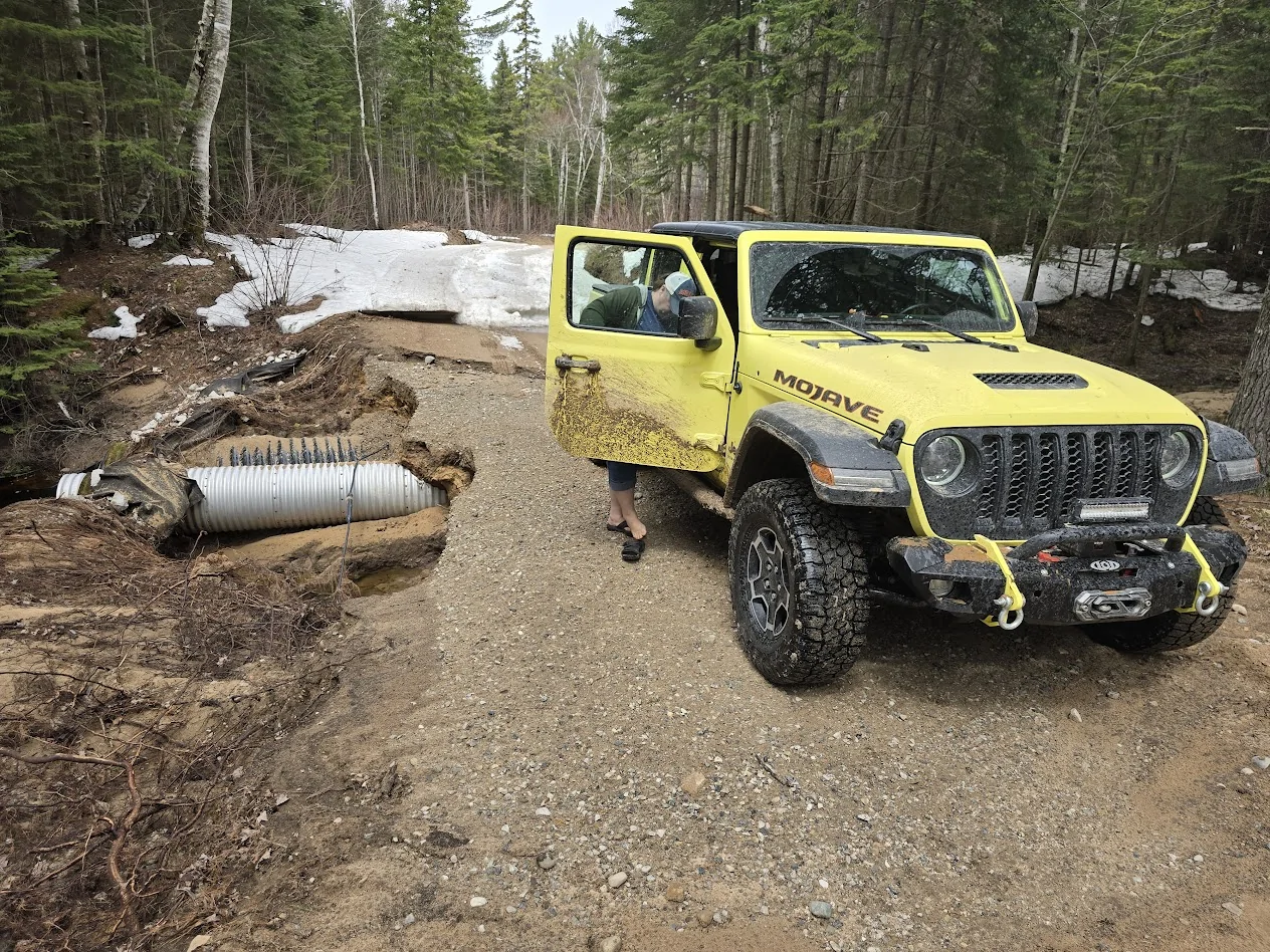

LOD Black Ops steel bumper, Xbull winch, not a problem for me.
Must be driving too slow or something.

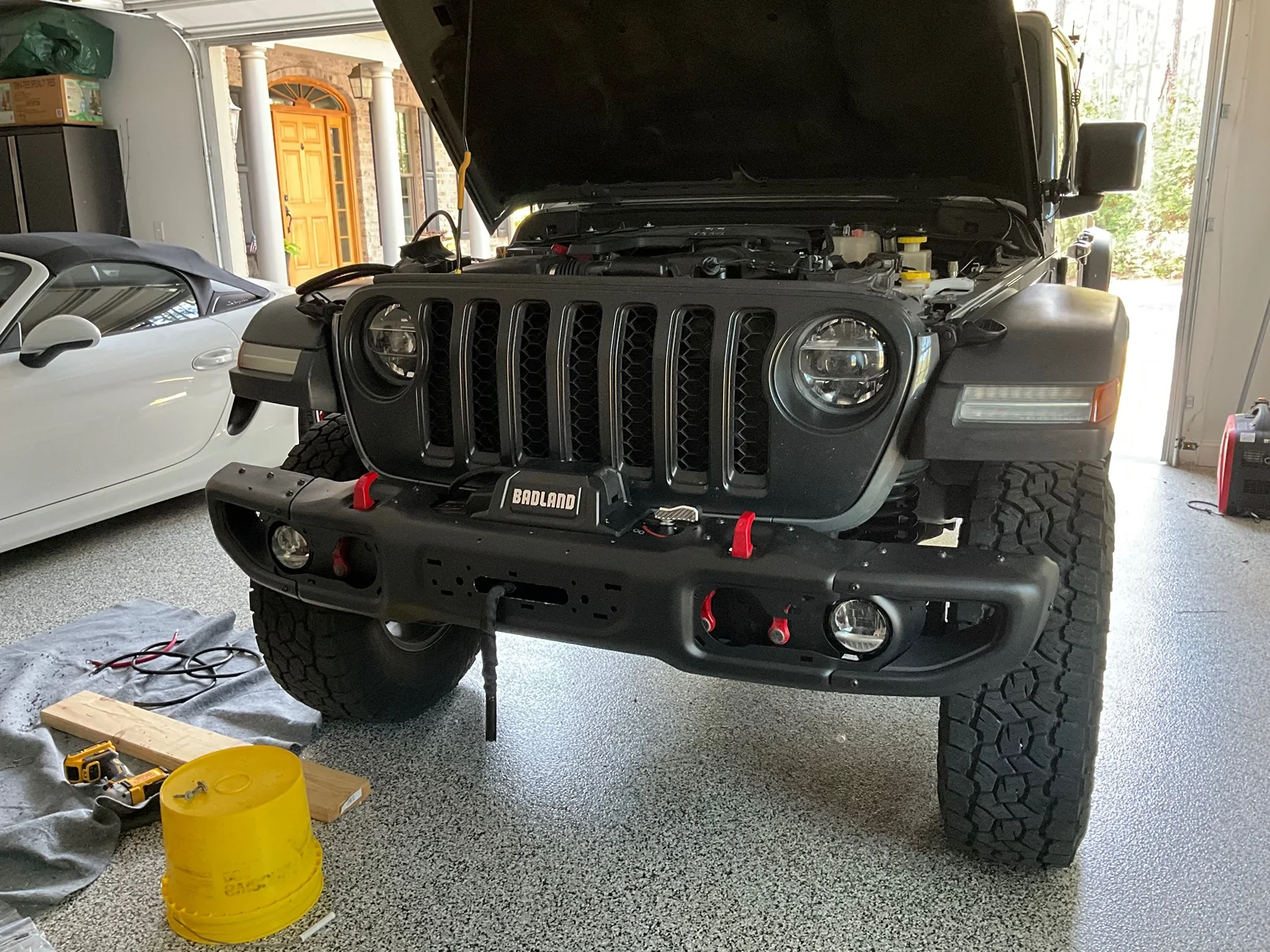

There’s a thread here about using the eBay aluminum bumper with a winch.
I decided to give it a shot as I
Jeep Gladiator Does a winch/bumper affect a Mojave IMG_0589
like the OEM look but didn’t want the weight of a steel bumper.
Im almost finished (just have to tiddy up the wiring) but so far I’m really liking it.
I have the AEV suspension kit so it’s designed for a winch…
The LOD mid bumper is on my list of choices.
