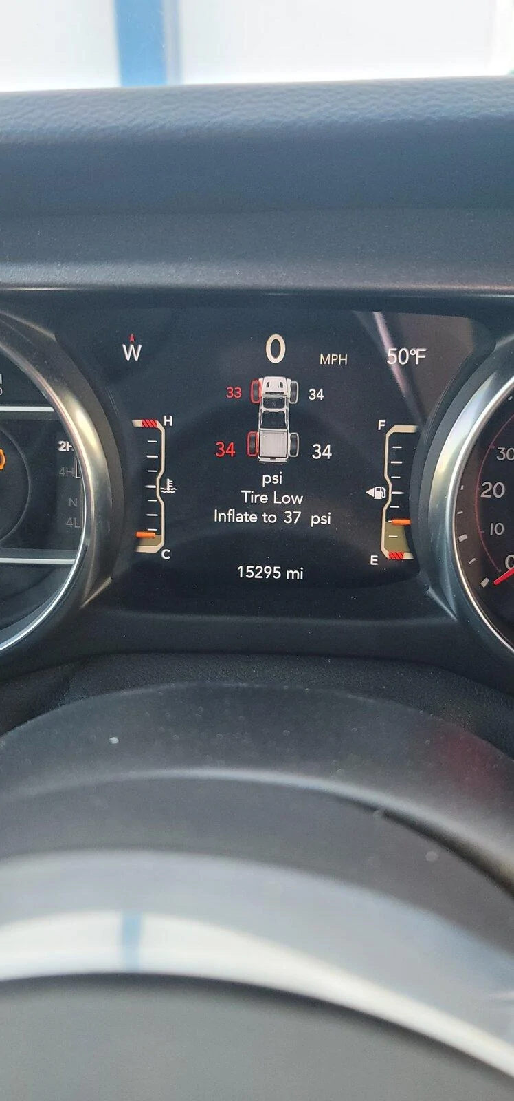

This just popped up on my Dashboard I've always ran my pressure this low and and now it says to inflate to 37 pounds but but only on the driver's side. Is anyone have any suggestions on how to remedy this or should I make an appointment at the dealer

Strange mine were the same psi this morning, no issue. Try driving it and see if they change, maybe they are red because they are not reading.

My wife's 2014 JGC just starting doing this but only for the driver side front tire. All are set for the required 34 psi. But she constantly gets low tire warning and it freaks her out. Dealer isn't aware of a fix yet but I say it must be a software glitch. Gotta love technology.

Take 5 psi out of each tire in red. To make sure it reads, drive around the block until they change in pressure.
Air back up to 34 psi and see if they change color.
I hate the whole Nanny electronic BS. Yes it's handy to have when you actually have a problem and it shows you which one. But to suddenly show low when it's the same pressure on the other side is idiotic.

If you just had a major temperature swing (Hot to cold or cold to hot) that is usually the easiest way to set those off. My left front is throwing a PSI warning. Started earlier this week when a cold front came through, went from 75 in the day to low 50’s at night. Last few days we’ve barely made it out of the 40’s and the sensors just being finicky. They’ll usually sort themselves out after a while.

Ya the system goes red at what ever it's set for then will not go back till 37.
Think it's 33? Not sure.
Tazer you can set the psi warning to what you actually want it to be.

My tires were at 32 psi this cold morning and I got no warning. I need to top them off but no warning

Air it back up to 37. It won’t go off until then. It dropped below its preprogrammed minimum pressure.

Mine does that too but it Wants me to inflate to forty! ?

My JT and the wife's Cherokee will do that on cold mornings if the pressure gets down to 29 (or 30) psi.
The odd thing is they want to be pumped up to 36 psi before the warning goes away. 31 to 35 psi is not good enough.
One of these days I'll get out the jscan and see if I can lower the tire pressure limit.
I asked the dealer to lower the pressure limit on my last visit and they told me they were no longer allowed to by corporate. I pointed out that the limit it wanted didn’t even agree with the pressure limits on the door and they didn’t GAS…
