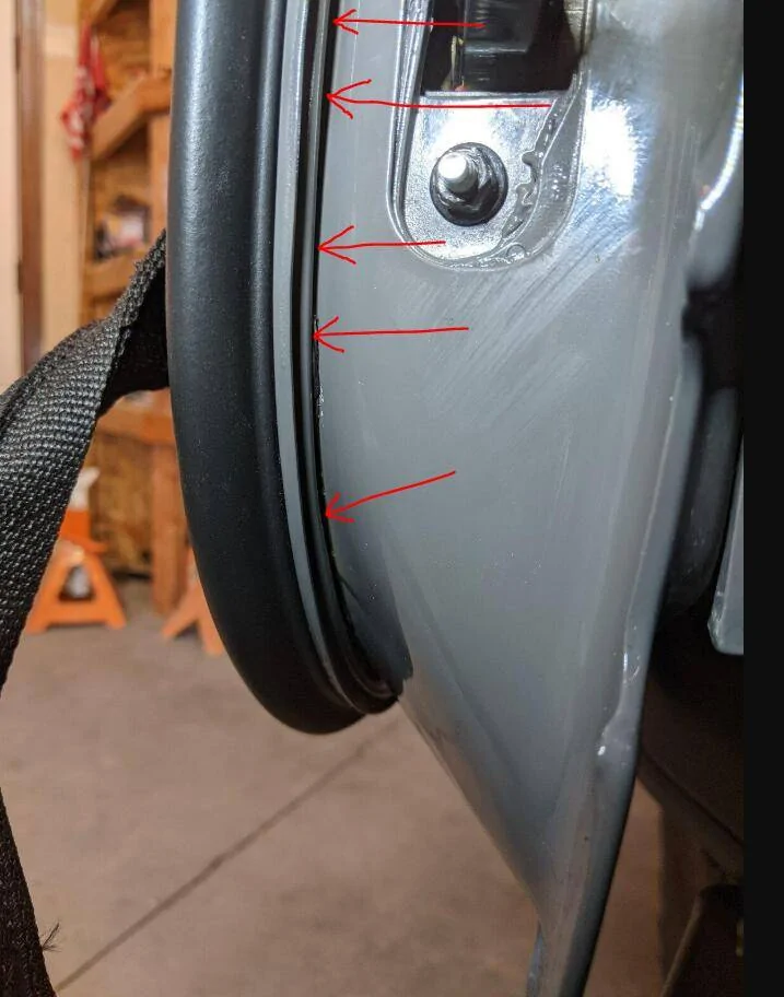

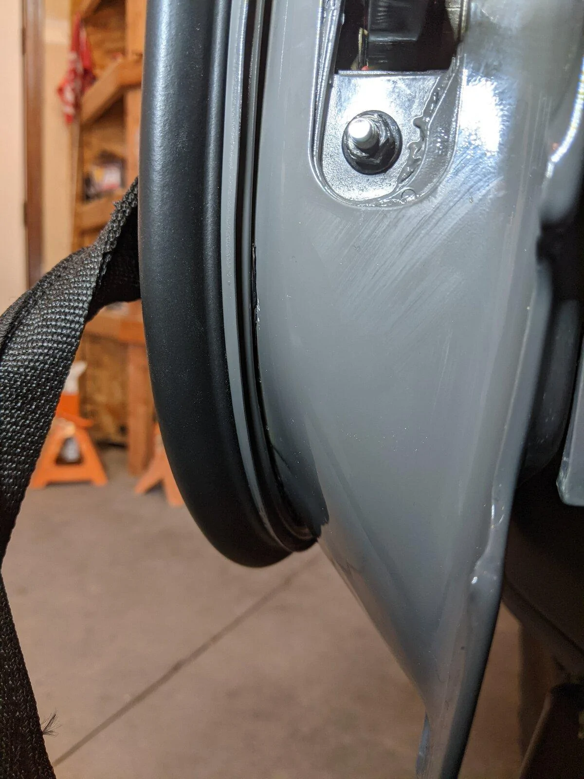

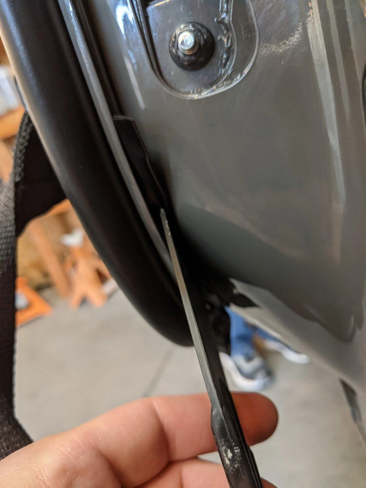

Ok I think I found a fix, just need someone else to verify it. This is a very easy and simple fix for now using electrical tape. I found that the outer door frame next to the door check is flexing/rubbing the interior door frame. You can test by pulling out on the corner of the door frame to see if it stops. I just forced some folded tape between the seam on the corner and it work.

I don't have any pictures, but the post by GRcrawler shows the seam where they put the tape. I just squirted Boeshield into that same seam.
Boeshield T-9 is a lubricant and protectant. It is a thin enough liquid to penetrate and it takes a while to dry, so it creeps quite well.

Added one of GRcrawler's pictures with arrows showing the seam.
I found their post just now. I’m definitely going to try that. So boeshield dries and ends up working similar to tape, but can be used without having to pry the metal apart? If I’m understanding that correctly, I like that better than prying.
