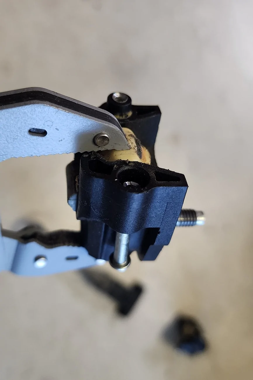

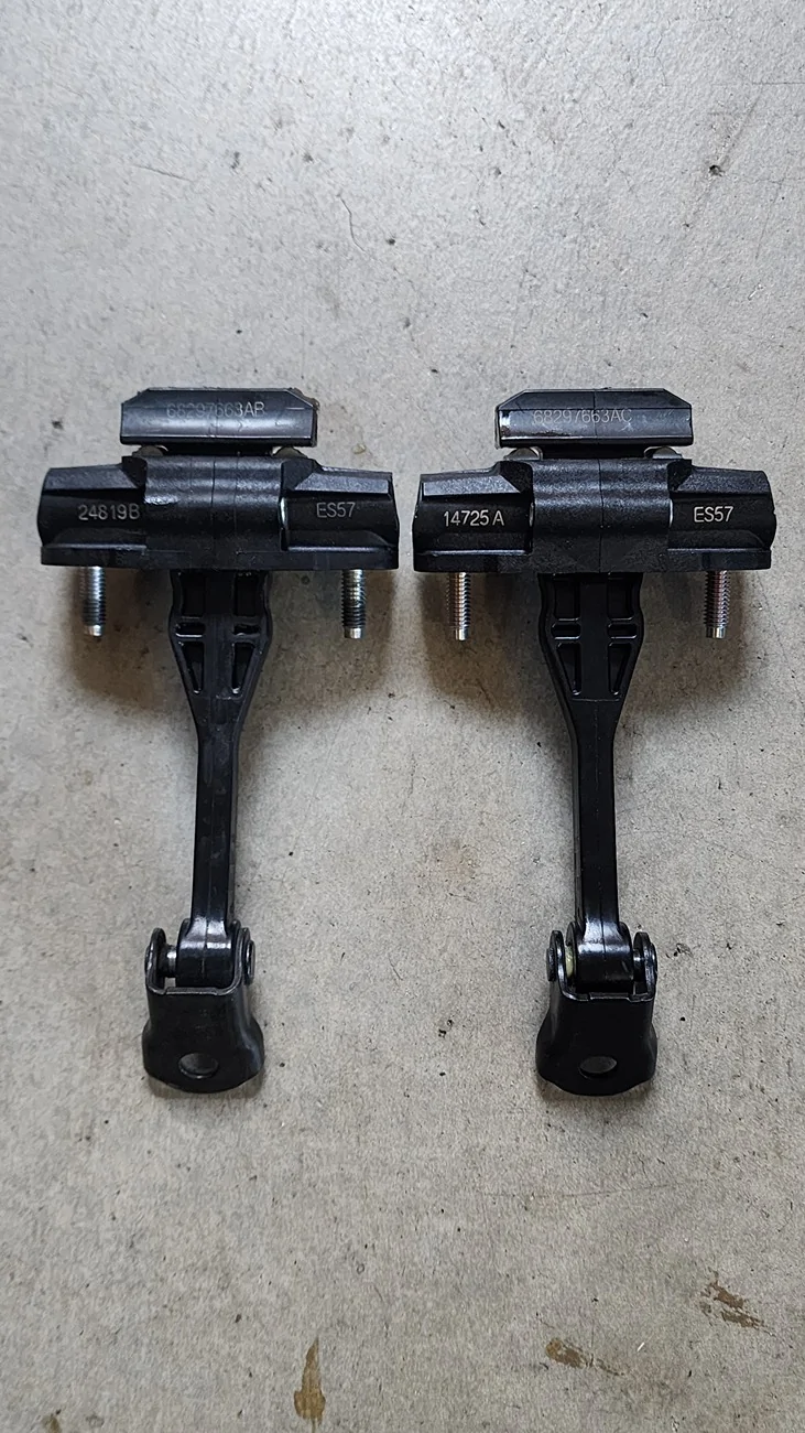

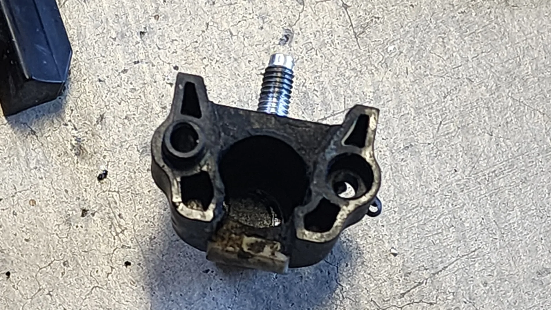

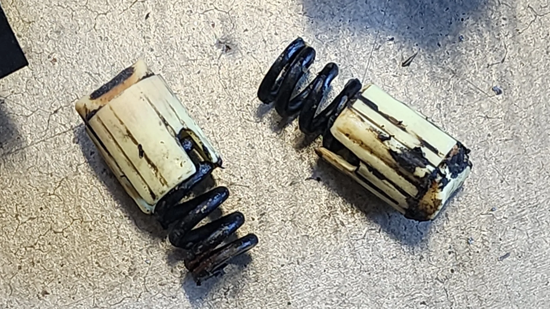

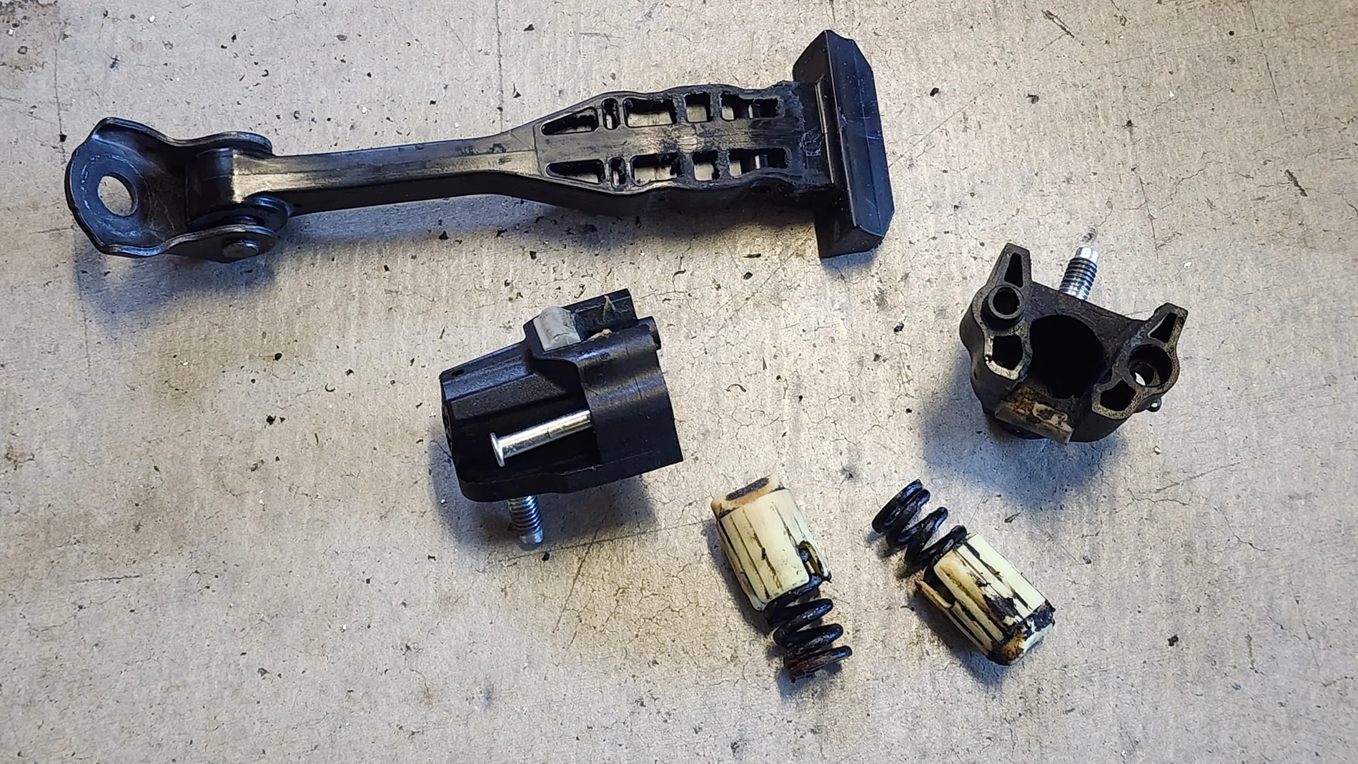

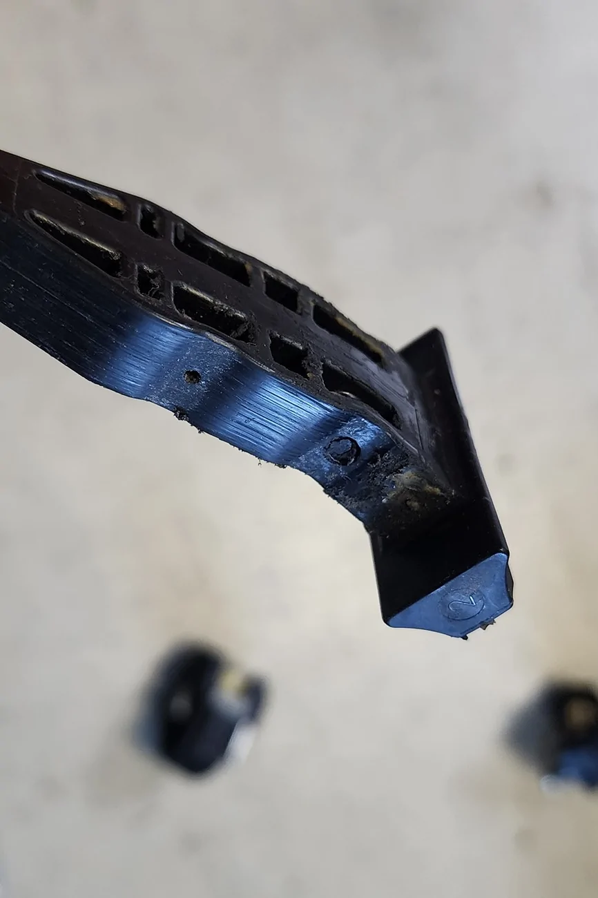

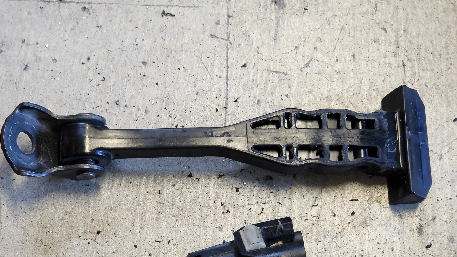

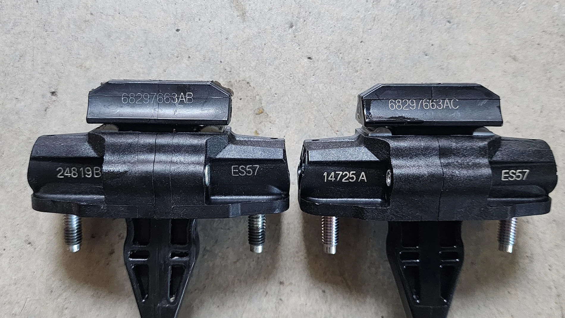

Replaced the door check, and noise gone! New one on right (68297663AC). I couldn't get the old one to make any noises, even after drilling out the rivots and taking it apart. Looked like just normal wear. No cracks or broken spring.

Darn, I wasn't able to take pictures with the door panel off. It was easy to remove the outer panel. I disconnected the cables and harness to take the panel off completely. Then, I removed all of the 10mm hex bolts on the inner panel. That allowed me to be able to reach in a little bit from the bottom opening. I let the old part drop into the door, then I used a long screw driver to push the old part back far enough for me to grab it with my fingers. To get the new one in, I used a fish tape (zip tied the door check bolt hole to end of fish tape) to pull it from the opening. Hope my description makes sense. Let me know if you have questions. Took about 30 minutes.
