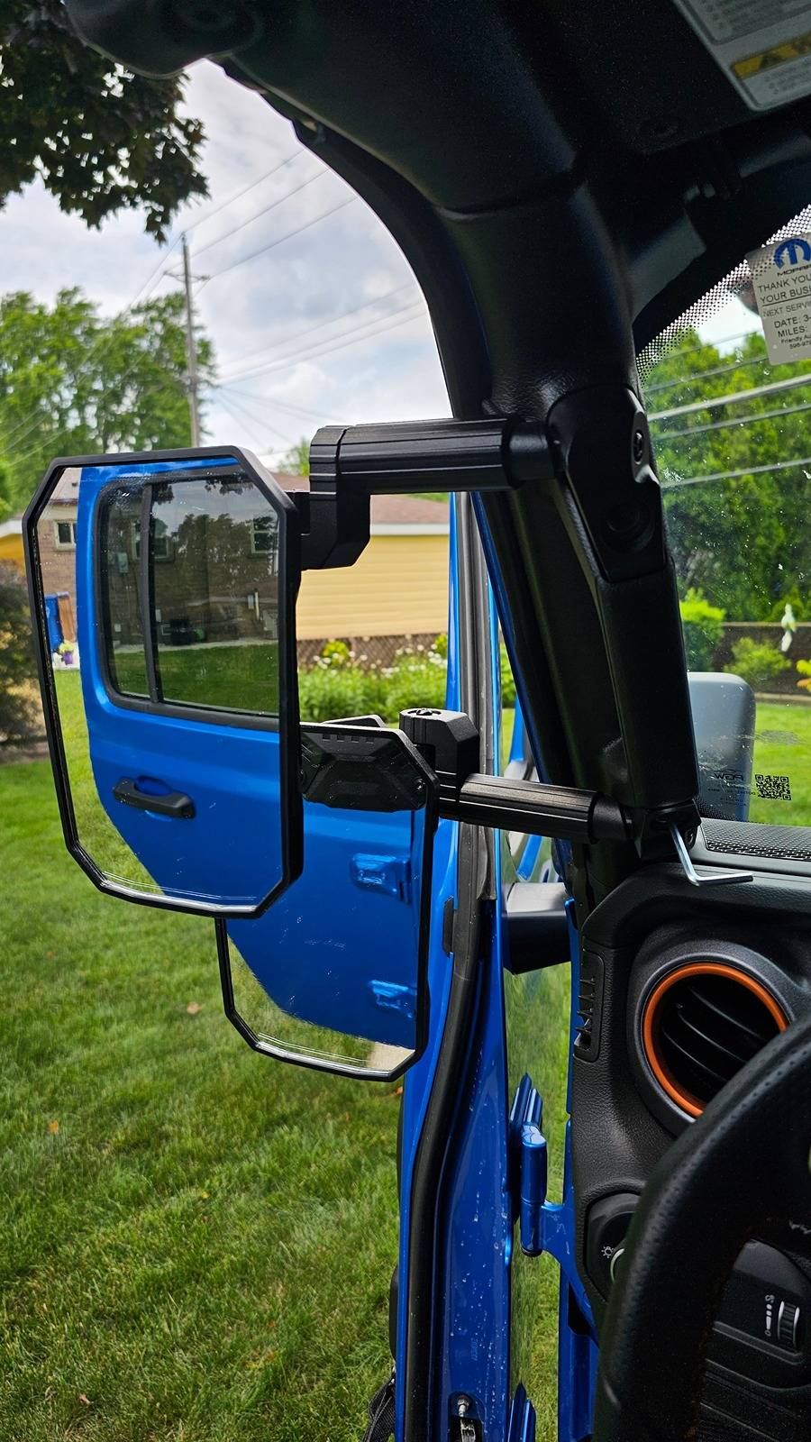

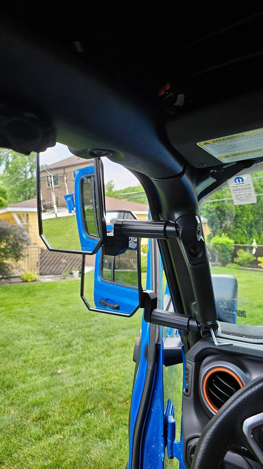

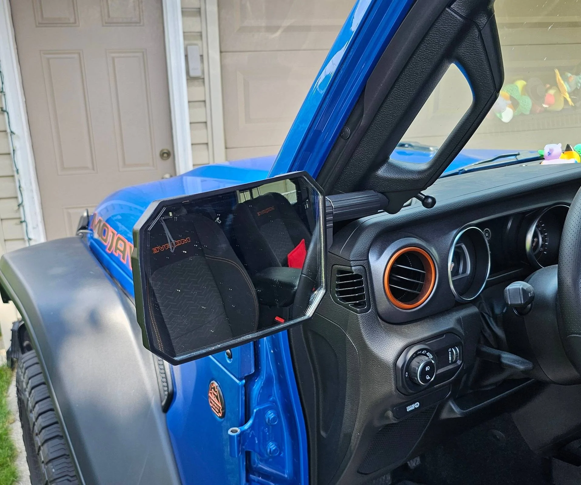

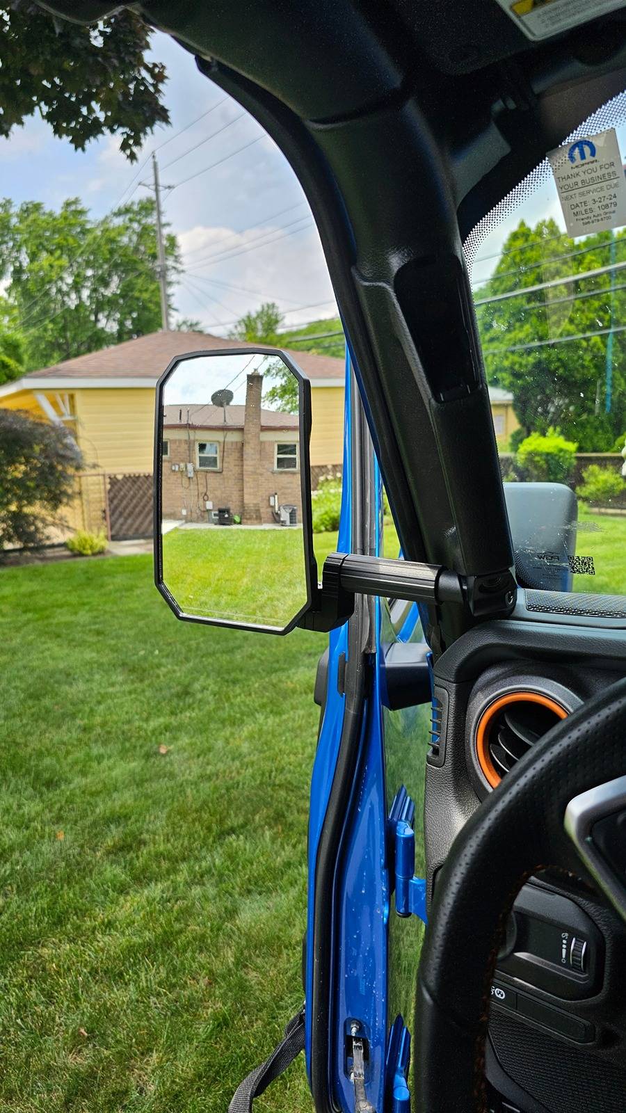

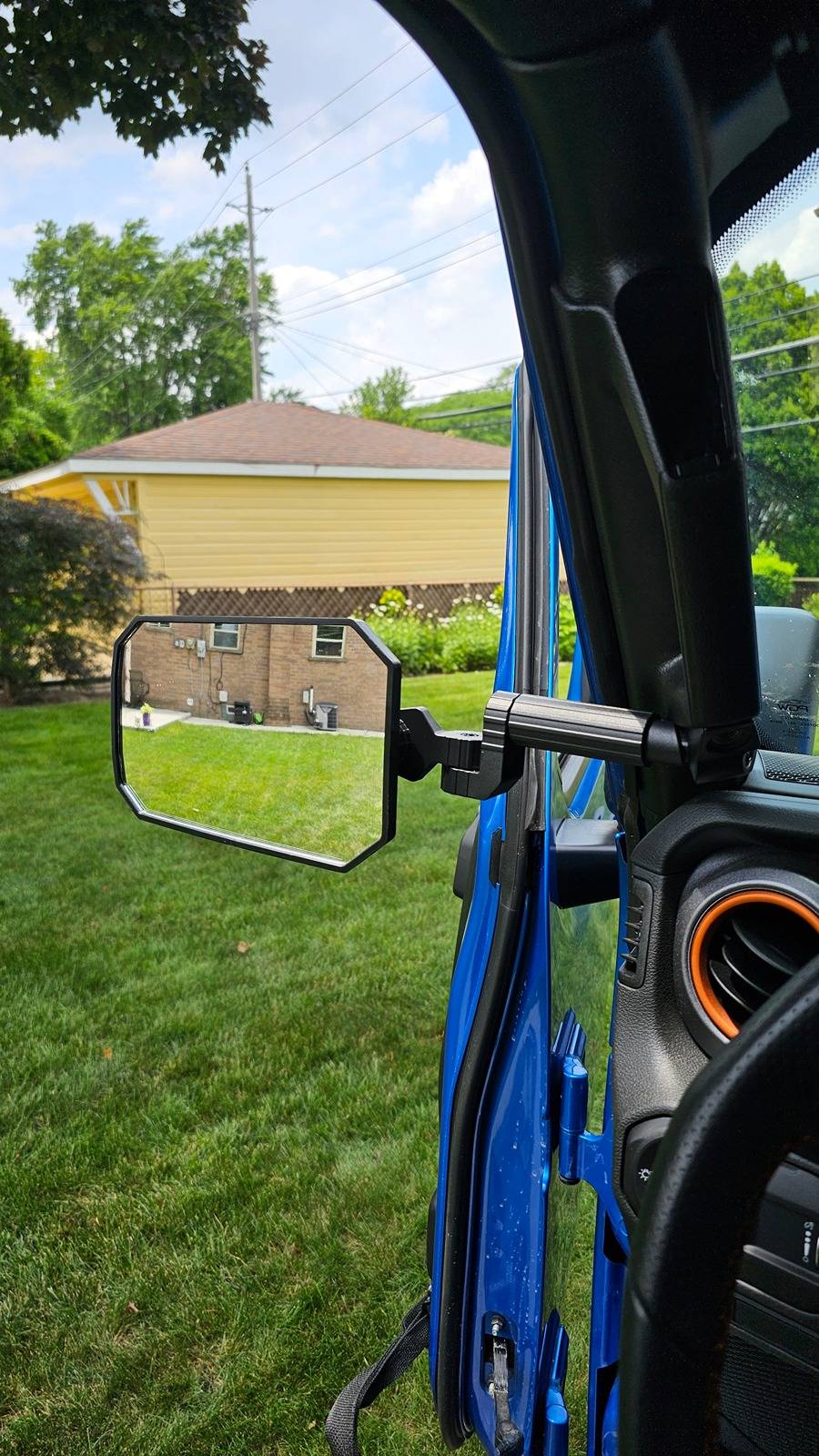

I installed driver side of the Joytutus mirrors today, in both positions, with pics for anyone interested.
Pros:
Big flat mirror, so perspective is not overly distorted. Actually has more visibility than the stock mirror. Not overly big like I had worried either.
Cool looking backside with the American flag, which can be taken off or painted. Lots of options on placement and orientation, and can be angled every which way. Solid metal parts for the arms and grab handle mount.
17mm ball for accessories mount is a nice extra, and can be removed, but I wish it was 20mm to work with Bulletpoint accessories.
Cons:
Plastic mirror body and mirror, but the American flag backside addition is metal. Shaky, but it's such a big mirror it's still easy to see what you're looking at. Needs hex key to install/remove from the mount, but @King Nothing and @JeffreyDV have found knobs for that, which should make for easy add/remove. But..
Perhaps overcomplicated in how it achieves articulation, so there are 3 points to tighten for positioning. If they don't stay tight in storage, it will need adjustment every time, which means hex key is needed regardless
I wonder how it will do bouncing around on the dunes, and if those positions will hold tight.
That said, I'm going to keep them for now. It got the job done well and I like the position and great visibility. But if it shifts offroad easily, I'll still consider getting the Gevinfa version, or simplicity of the American Outlaw mirror. Or solid Kikbax with foot peg bonus.
Now on to the pics.
I installed both positions simultaneously to better pick a favorite.
Jeep Gladiator Doors off mirrors 1000006617
Jeep Gladiator Doors off mirrors 1000006620
Jeep Gladiator Doors off mirrors 1000006660
It was clear pretty fast I didn't like the upper mount position, far too "in my view." I could easily imagine it blocking my view, like pedestrians in a crosswalk before I turn.
So I went with the bottom option and made it even lower yet by swapping which mirror was on which arm. Notice how in earlier pics the L of the bracket is going upward for the bottom mount. And in the following pics, it's facing down.

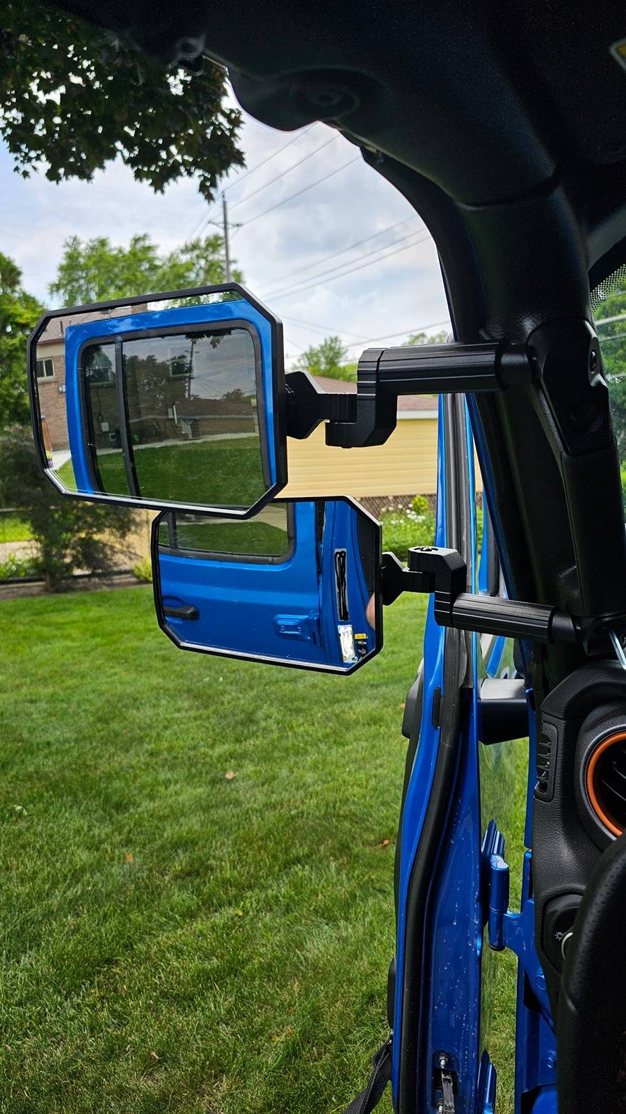

Jeep Gladiator Doors off mirrors 1000006633
Jeep Gladiator Doors off mirrors 1000006635
Jeep Gladiator Doors off mirrors 1000006636

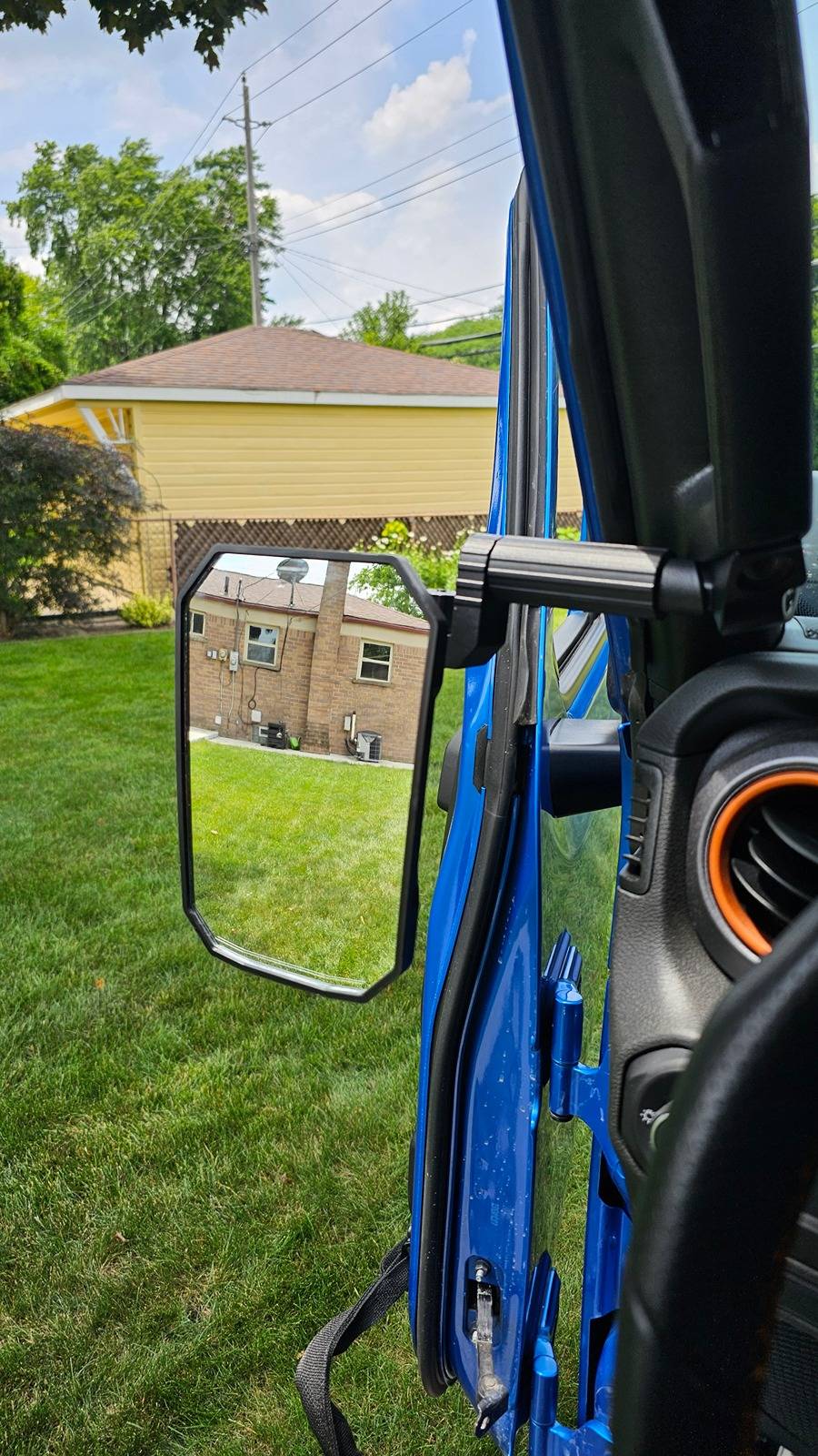

For those that like the top mount position, the same swap could be done to raise it up a little more.
As mentioned, it articulates every which way. So you can angle toward your truck if you like having it in your view, or out to see more of the road. Same with angling upward or downward to see sky or ground. However, you've got to tighten 3 points to lock it in, so probably best to not adjust on the fly and risk loosening them up. Though I did pull/push the angle some while driving and it kept.
The protective sticker was still on in all pics; much more clear once peeled off.
Jeep Gladiator Doors off mirrors 1000006648
Jeep Gladiator Doors off mirrors 1000006642

Mine are mounted as depicted in the last photo. I like that position, had to move the flags from one mirror to the other so they wouldn’t be upside down. On our bumpy suburban street I haven’t noticed any shaking. Definitely too many pivots points but I’m sure I can get them tight enough so they won’t loosen. I store them under the front seats when not in use. Before I got these I was using UTV mirrors that I mounted to the grab handles. They worked ok but were a little small and vibrated more than I liked. The biggest plus was I could fold them in when the doors were on rather than having to remove them.

How does this one tighten? Looks like there's a knob which I'd think locks it's position (vertical, horizontal) as well as how close it is to the Jeep. How does it lock the rotating part, that allows angling up or down?
Is the entire thing metal?
Yeah there's a knob on the back side of the mirror. You loosen that up and you can move the mirror in and out, or adjust it to be vertical or horizontal.
The mirror housing is plastic, the arm it moves on is plastic. The part that installs in the grab handle, and the base that inserts into that is metal.

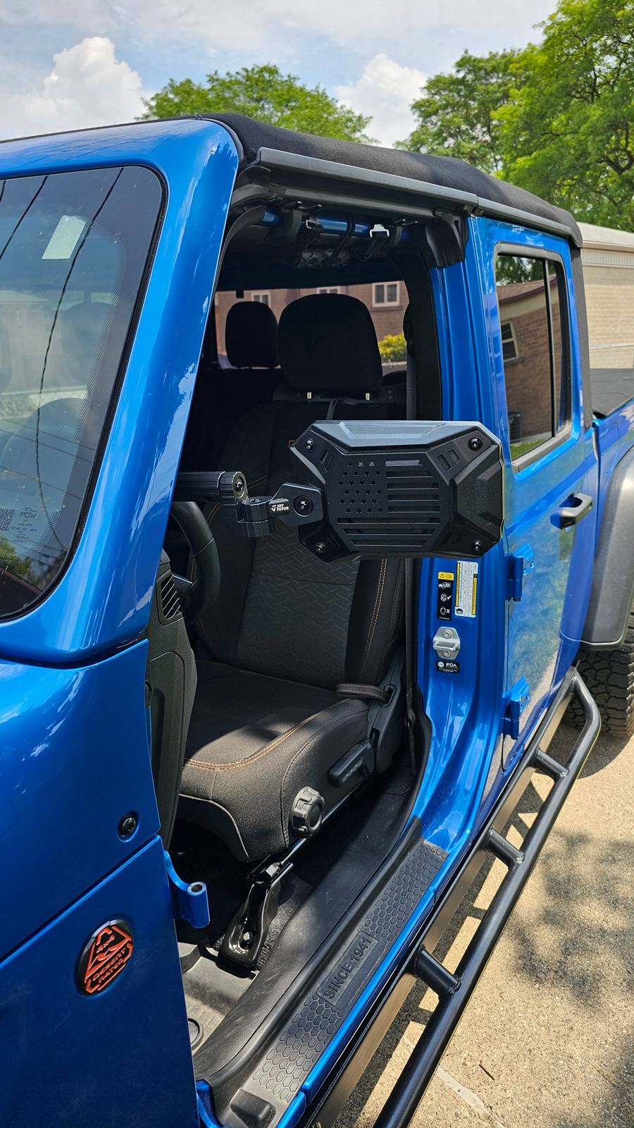

I ended up buying the Joytutus mirrors that attach at the cowl, because my driver's side grab handle is my Voswitch JL800 and the ball mount style that attach there are incompatible.
Best picture I took of them is below, you can zoom in and see the mount, one bolt out, one bolt in. They use a hex key bolt instead of a torx, which is super lame having to swap tools and it's even a different size hex key than the one used for all the mirror adjustments.
They bounce/vibrate all over the place and will move position at 70+ on the interstate. Highways / town driving was fine and saw no real movement of position but there was some minor vibrations and bouncing.
Totally worth the money to stay legal. Also woohoo for being an idiot and taking the doors off for the first time when it was 96 degrees both days the doors were off.
