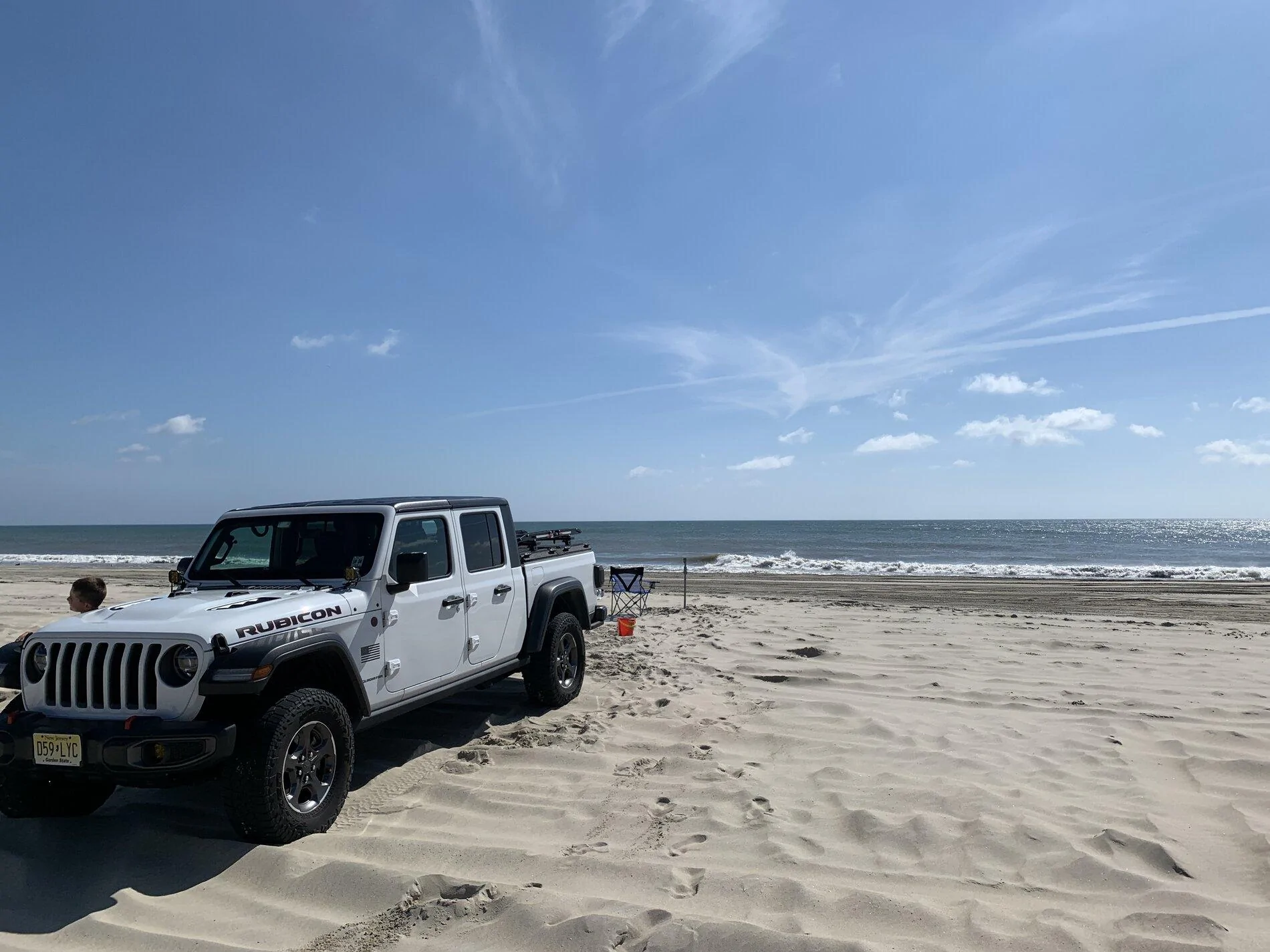

I put mud terrains on my rubicon and it handles better on Ft Fisher and Ive never let the air out. To me they have better traction so long as you dont spin them to dig but those lugs are also what help pull you in the sand. Ive always been told AT tires are better but I'm not convinced of that any longer. I really want to try a Mojave to see if its truly that much better driving out there. It could sway me to trade since I really dont do much rock crawling on the coast lol.
I don't have personal experience to comment on the difference between A/T and M/t as I have never run a true M/T tire. That said I have read and watched some stuff lately that seems to support that M/T tires are actually better in sand than A/T. Either one will get the job done.
That said I did air down to 20 psi on my stock Falken A/Ts when visiting OBX in July. No issues whatsoever.

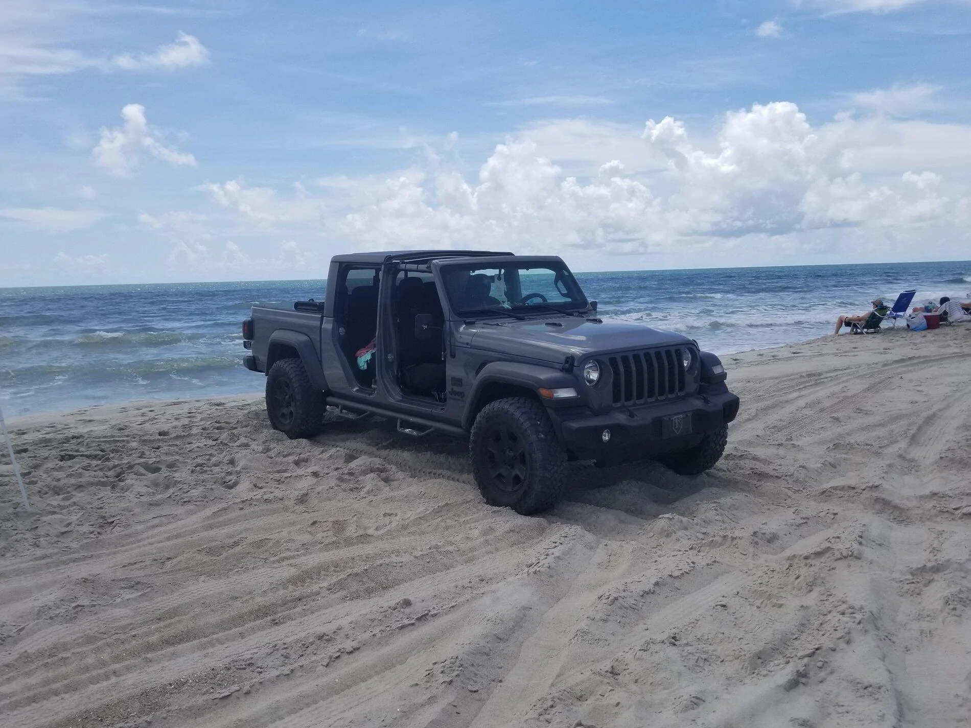

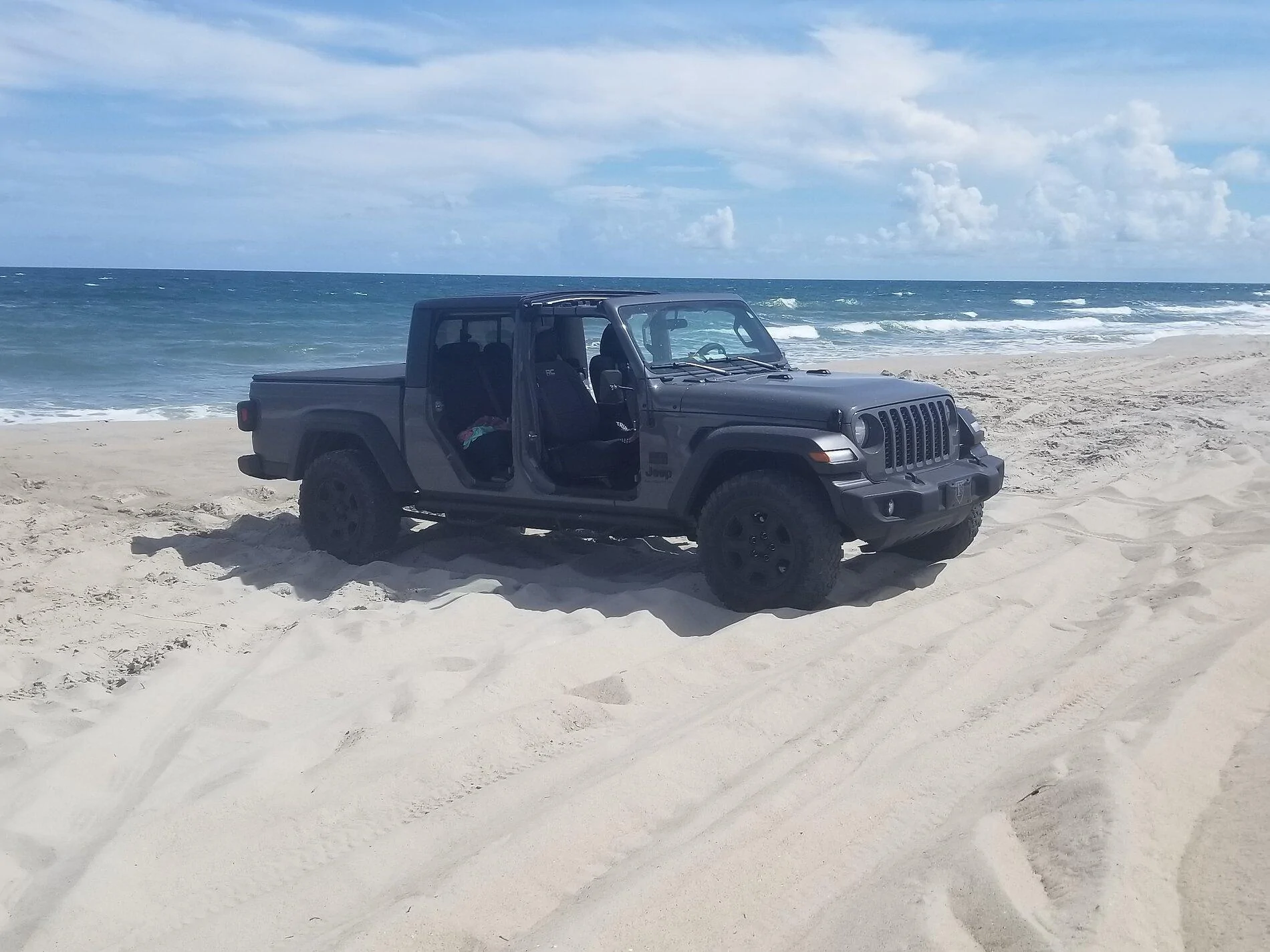

Ft. Fisher in August. Mojave take off 33s MTs on manual trans 20 Gladiator Sport S. Aired down to 20psi and 4 high. Traveled with no problems on the sand. Air down and take it easy and there won't be any issues. :like:

What a beautiful long stretch of beach that is! - and you can cut across to the other side of the dunes in a couple of places where the tidal creeks flow through and connect to the Cape Fear. I've been thinking about carrying our kayaks out there and exploring them one day.
The only thing about Fort Fisher in my JT is that in those areas closer to the entrance where so many vehicles are bouncing through the sand, it creates humps that will bounce me like crazy if I drive at the 15 mph speed limit. It's because all those trucks going the same speed bounce at the same places and make the humps more pronounced over time. Drive 15mph and you create a resonance that increases the bounce more and more as you go. The bouncing goes away almost completely when you go 20 mph because it disrupts the resonance. I know it seems counter intuitive to speed up rather than slow down, but it works.
Anyway back to topic, yes these trucks are happy as can be on that sand. I was backing up out of my spot facing the ocean one day when fishing with my daughter, and landed both front and back tires in some deep ruts. I mean we actually dropped down into them with a thud. It was that really soft sand and we were deep, so I thought we were done. She looked at me with some concern, I shrugged and gave it some gas to see what I was dealing with. We hopped out of those deep ruts without one bit of spin. That was with stock diameter tires at 20 lbs psi in 4H. My daughter looked at me and said, "Dad - I can't believe you just drove out of that hole like that!"
I can't count the number of times I've gone around guys in 4x4 trucks with huge tires that were being pulled out. There's just something about these Jeeps that are superior in soft sand.
