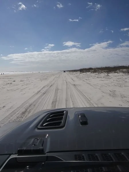

I have taken my Jeeps (JK, JL, and now the JT) to the Outer Banks every year to drive in the sand. They all have had manual transmissions and 4HI works best. I admittedly never air down and have never gotten stuck. I apply the same techniques as driving on ice in NJ where I grew up: steady speed, no fast starts or stops, and gentle turns. If I did get stuck, I would air down, as I carry a compressor. I also have started carrying traction boards, which I have yet to use.

The Rubicon T-case is not a concern, it just means you might be in a higher gear or higher RPM's than a non Rubi T-case.
It is my understanding that the Rubicon RockTrac 4:1 transfer case has the same gears in 4H than the transfer case in the other JT's. The difference is a stronger case and lower gears in 4L.
I use Off Road + and 4H in sand when traveling long distance. It keeps the RPM constant and seems to keep the transmission cooler based on my observation of the Off Road + gauge cluster.
