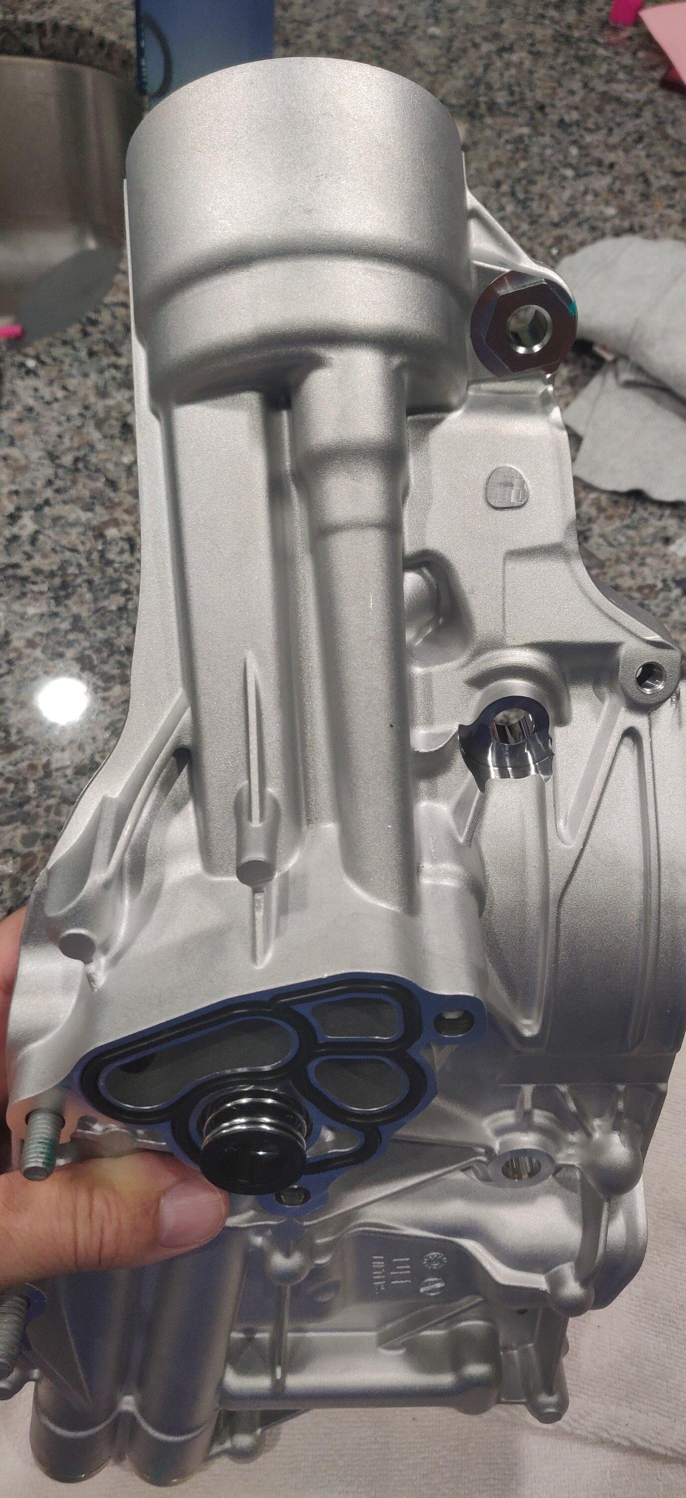

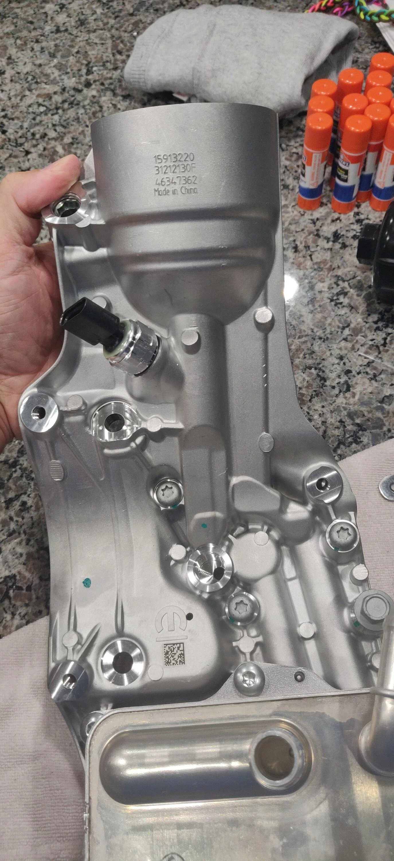

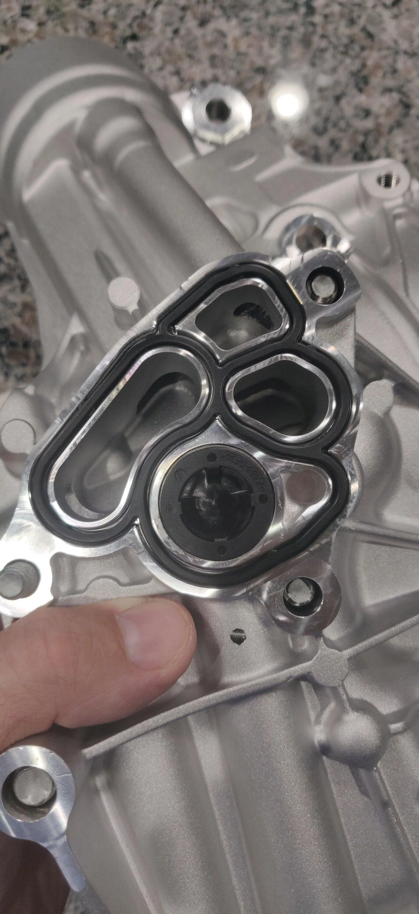

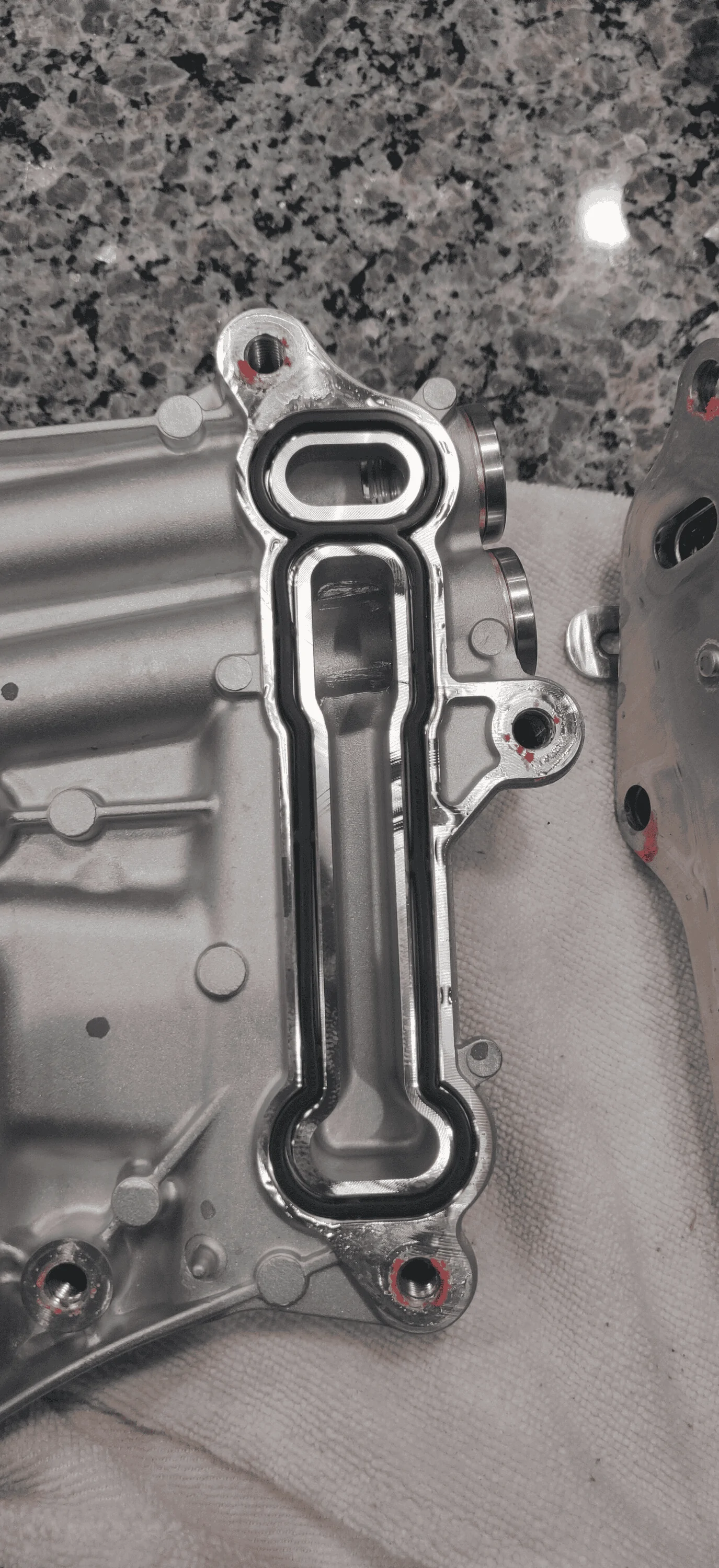

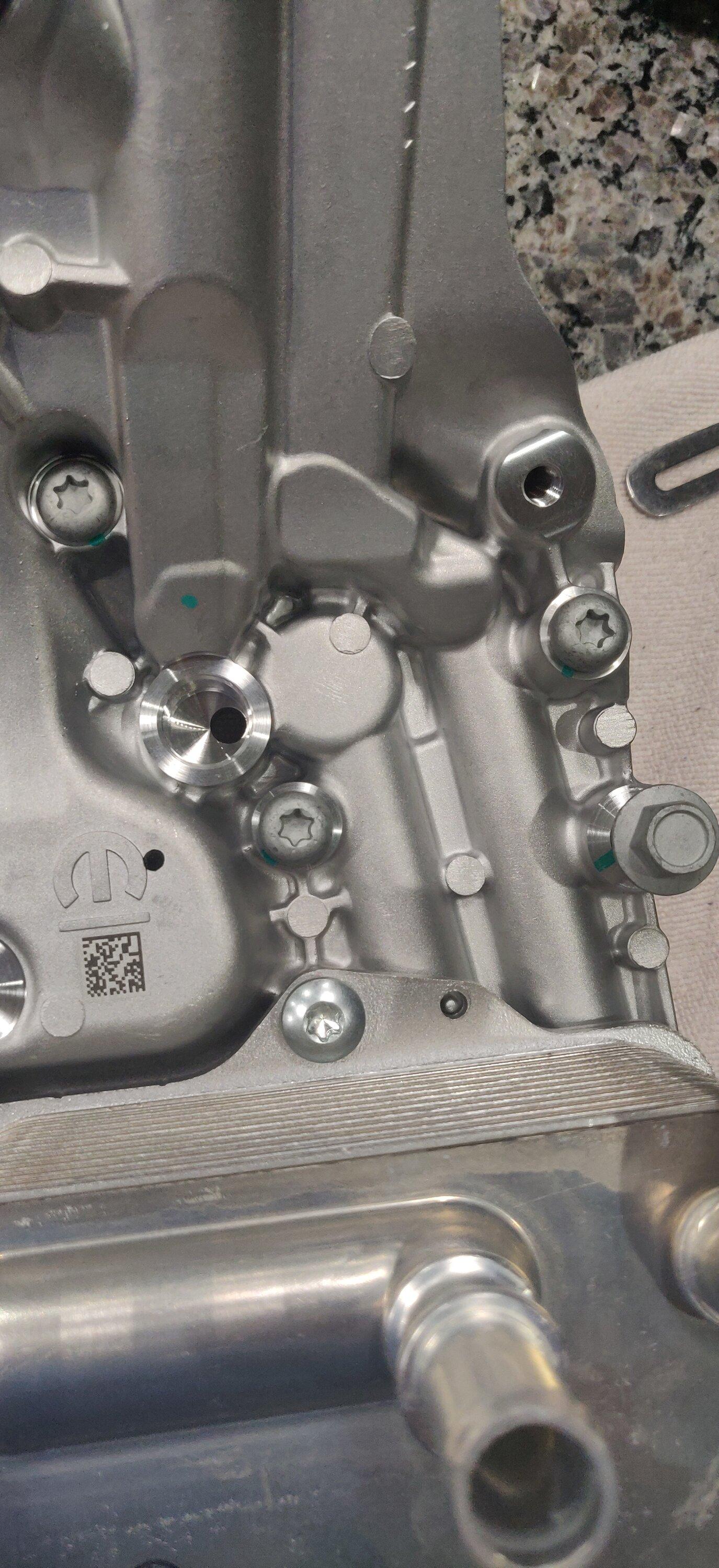

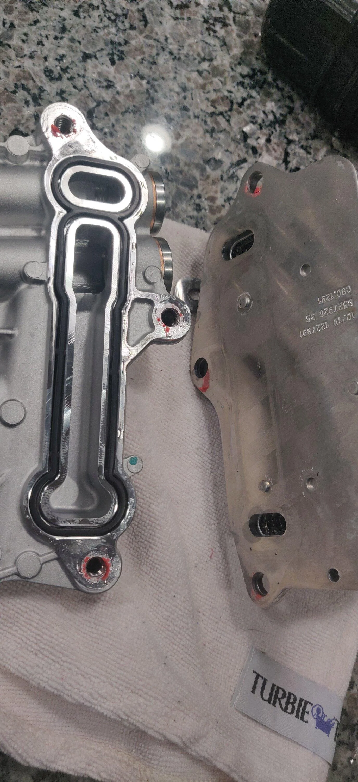

Got the oil filter housing today. Short version is that things look great. Best we can deduce is that the middle port on the right side is the feed from the engine into the housing. From there it goes thru the filter and to the oblong port on the left. It splits in that port and goes back into the engine and into the heat exchanger. After the exchanger the oil enters back into the engine thru the bottom right port. We're pretty sure that black circle is a tstat for the oil to allow the oil to get to temp. The top right port is for the oil to drain out of the filter cup when you remove the filter. We believe the sensor that came with the housing is the temp sensor and it's installed in the oil flow coming from the engine before it enters the filter and the exchanger. So when you're under the Jeep the rear port would be the feed and the front port would be the return. I don't see any benefit to making a block off plate like the 2nd gen had. Plus it would be an absolute PITA to get all the bolts out to install it. The coolant does not pass into the engine like the 2nd gen, it just goes in and out of the exchanger.

So it looks like the two plugs on the bottom go to the same place as the in and out for the oil filter?
11,444
30,505
Question. Is the temp sensor before or after the heat exchanger?
If the black do hicky is a tstat. Wonder what the temp setting is?
So......we can use the 2 plugs on the bottom to plum in the cooler without issues. And they are 18mm. And this has been verified.

If the oil travels how we think then the sensor is before the filter and before the exchanger. So basically it reads the hottest oil possible. I believe the plugs are 22mm not 18. Haven't gotten that far yet, but yes it appears using the plugs does the exact same thing as the NOECO delete plate did for the 2nd gen motors.
Not exactly. The filter supplies the engine and the exchanger and the exchanger has its own return port.

Ok maybe someone with engineering/fluid dynamics exp can help me here. If you use the ports to run to a cooler in paralell with the current exchanger.... Do we get a x volume flow through our cooler? Or does oil not push through the additional resistance and continues to flow through the factory exchanger?
It is full flow and return so there should be no major issues with that. But only X will flow through the new cooler and the rest is still being heated/cooled by the coolant run heat exchanger.

Looking at this picture. You have the 2 plugs and the heat exchanger passages. Oil will take the path of least resistance. Think most of it will flow out of the plugs. And you will still get flow through the heat exchanger. The percentages, I don't know. For full flow through the plugs. You would need a block off plate.
I agree with you. With the positive results that @Samfamaz has seen I don't think the benefits outweigh the work involved with removing and blocking off the exchanger. You would have to remove the AC compressor to get to one of the bolts and I haven't even looked to see what has to be done to remove the AC compressor. That being said I will still be taking measurements for a block off plate just in case it does come to that, but I don't think it will.
