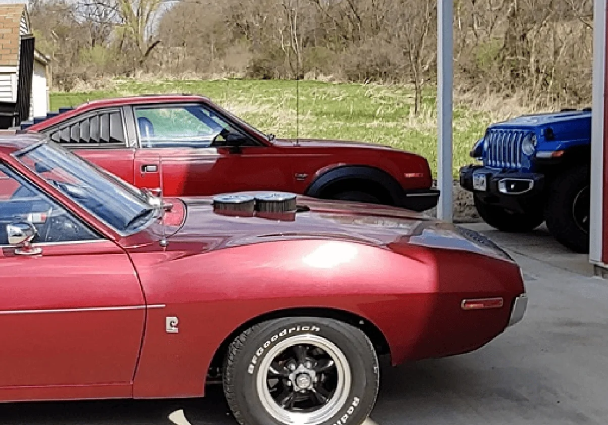

Mine was because I left the car sitting under the maple tree out front for the night because the forecast was for 0% chance of rain, clear sky, etc.
Got up the next AM and found we got over 5" in one hour through the night.
Pulled spark plugs and water shot out over 30 feet when I gave the starter a quick bump.
Changed the oil 3 times that day, lucky as heck.
Things can bend and break if you get into a hydro-lock situation. I've seen bent and busted rods.
Totally agree - worth every minute and every dollar to change fluids after that.
It was only the third time that I could say there were no signs at all of any water in the crankcase or starbucks coffee in the oil filler tube on my car.
Nice Javelin!
