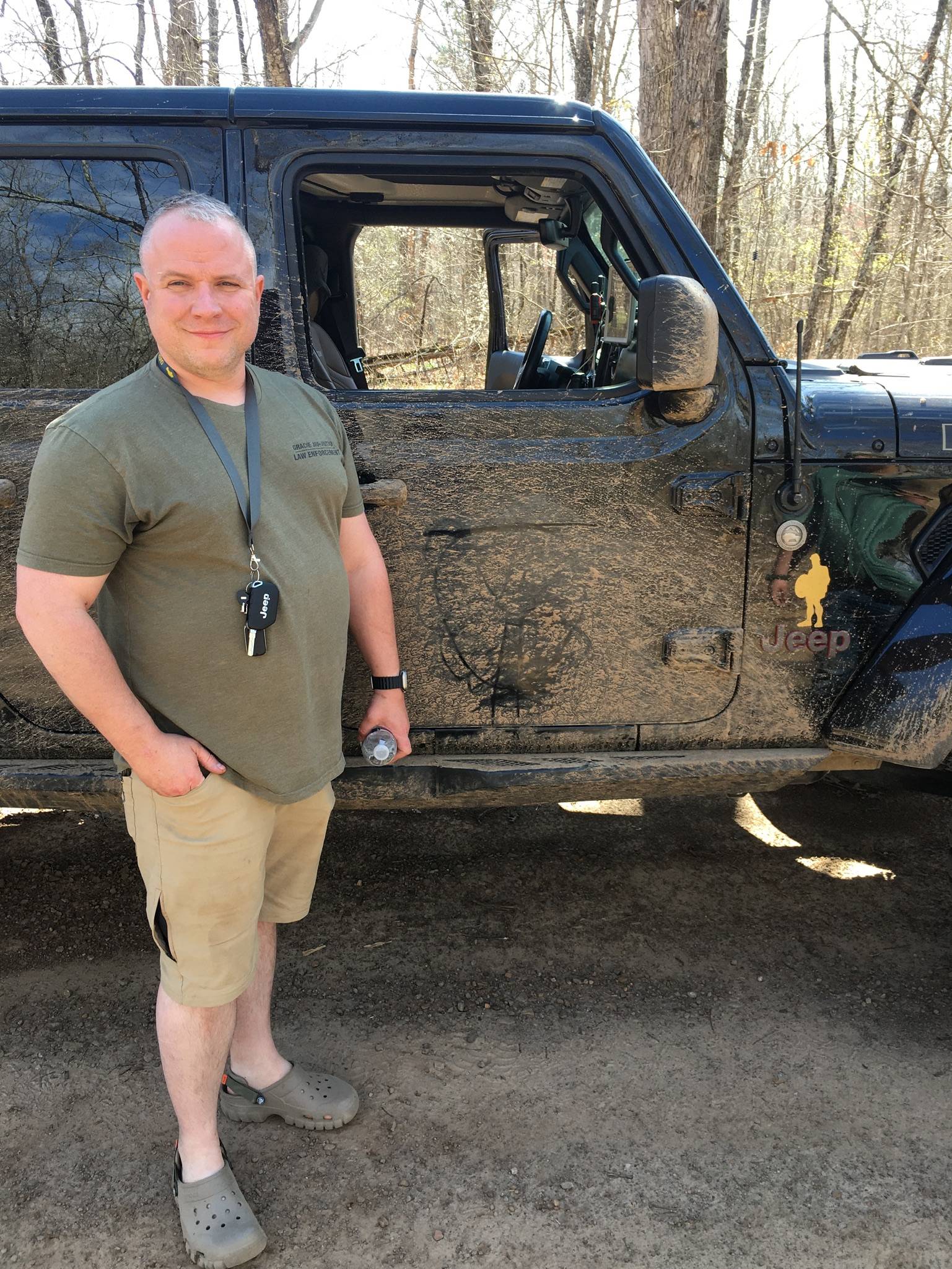

Do you have a video or pictures so that we can judge the water depth (and what components were potentially affected)? Did your engine make any sound when it died, and was your tailpipe restricted?
Unfortunately no, we were all worn out and trying to make camp. Should have been off the trail hours earlier but we kept re-routing around bigger streams due to the depth.
no weird sounds it just died. On start up it took a little longer than normal.
In the attached photo I put a line on my door about where the water was on the upstream side.

The upstream side was toward the airbox, so Barnadby'sdad might be dead right.
In terms of how lucky you are: The other ingress point into the engine is through the exhaust. When the engine shuts down, the water no longer has that pressure keeping it out. Looks like the water was just below making it through the headers.

30" is the limit - half-way up the door sounds like more than 30" lift or no lift.
Jeep Gladiator Engine died during water crossing 1680129085688
Lucky. A few more inches and you were getting into hydrolock territory.
