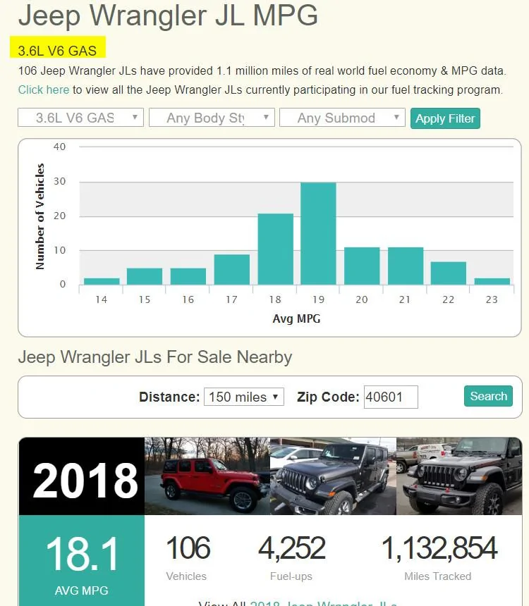

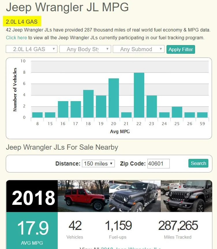

Apples to apples, the 2.0L engine gets the same or slightly worse fuel economy than the 3.6L. It also has myriad other "features" that will become problematic over time like coolant lines running under the vehicle, 48V battery system and wiring, multiple cooling systems, etc. And it costs more. And it requires more frequent maintenance and plug changes. I can understand why Jeep didn't offer that in the truck.
The difference in fuel efficiency between a JL and a JT with a bad engine is due to weight, aero, and the fact that the JT has a bad engine. It's not a 2.0L vs. 3.6L issue.
