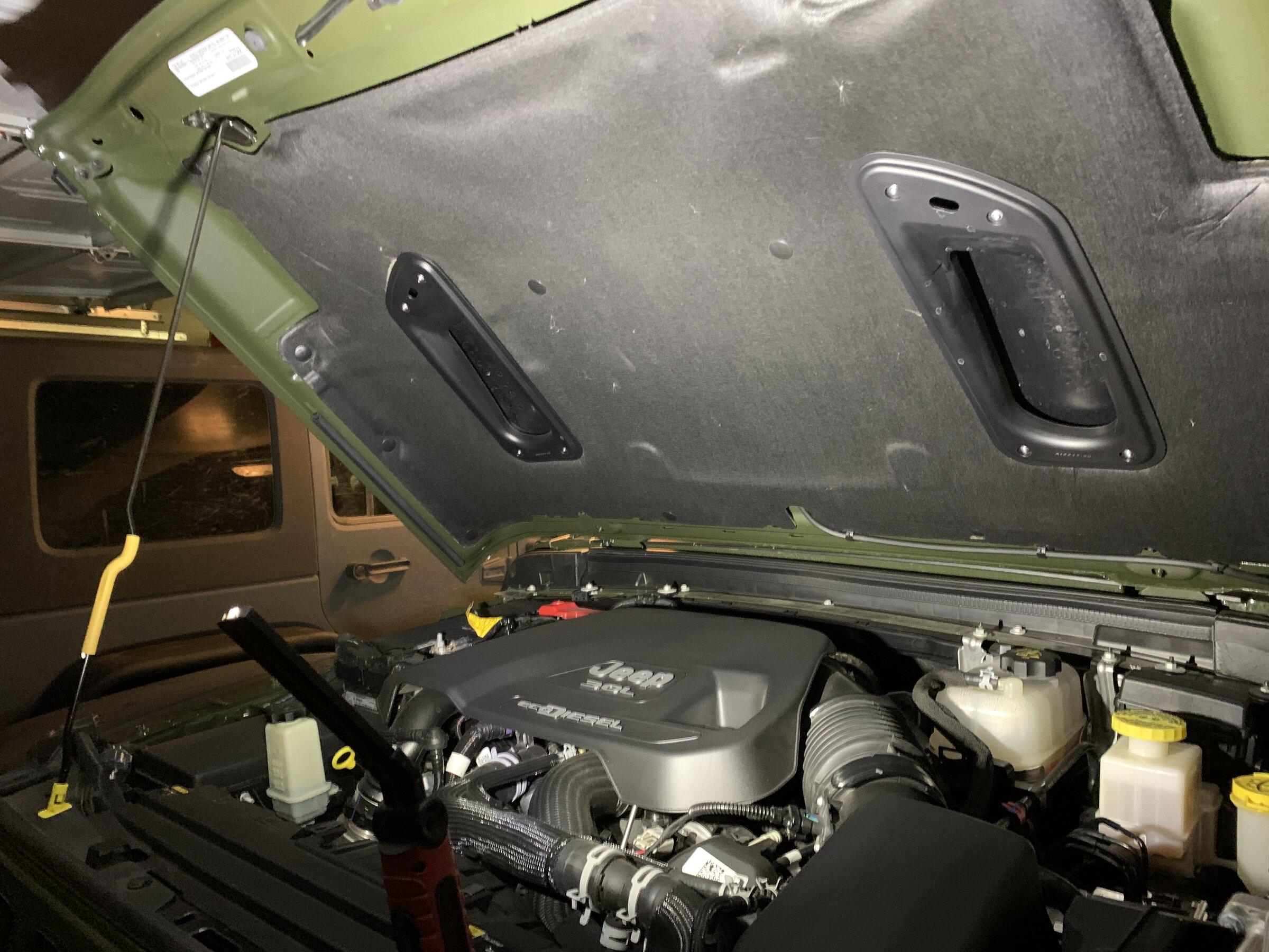

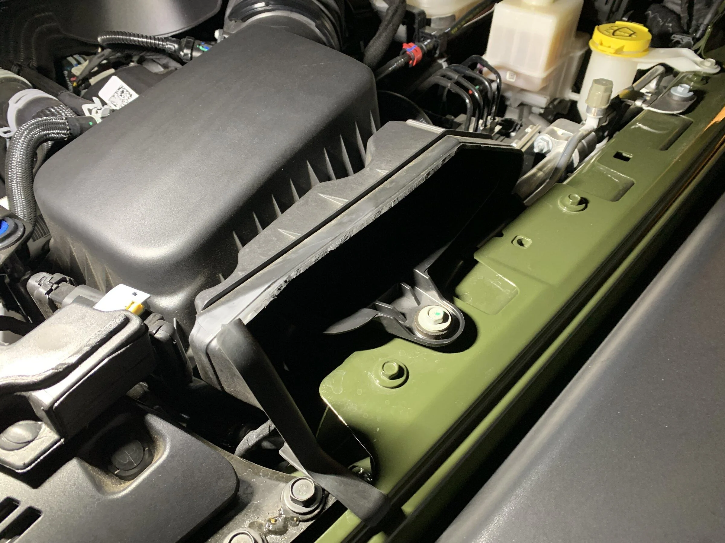

Trimming the intake boot as shown, is an easy add at no cost. AFE makes an excellent cover should you desire increased capacity for your final drives. SB scoops relieve excess underhood temps that the EcoD has in this platform. And gearing to your tire size is a wise choice should you want to run larger.
Did the air box mod make a noticeable difference in regards to intake temps, and/or acceleration, at normal rpm range, mpg? Have you documented the hood mod?
tonyS2022
Anthony
Feb 13, 2022
2021 Jeep Gladiator Diesel
Military
It did. IAT (Intake Air Temp) pre hit almost 200f on an uphill pull. This was accompanied by a progressive de-power with several network and one hard MIL that was basically "fuel request greater than anticipated". Post was 86f on a 65f warm day recently. Allowing some fresh air via the left scoop to enter made a significant difference.
Yes, it's all on a lengthly thread I did a few weeks back.
So, bottom line, would you recommend doing it along with the SP scoops? If yes, whats the difference between doing that and a cold air? The filter?
