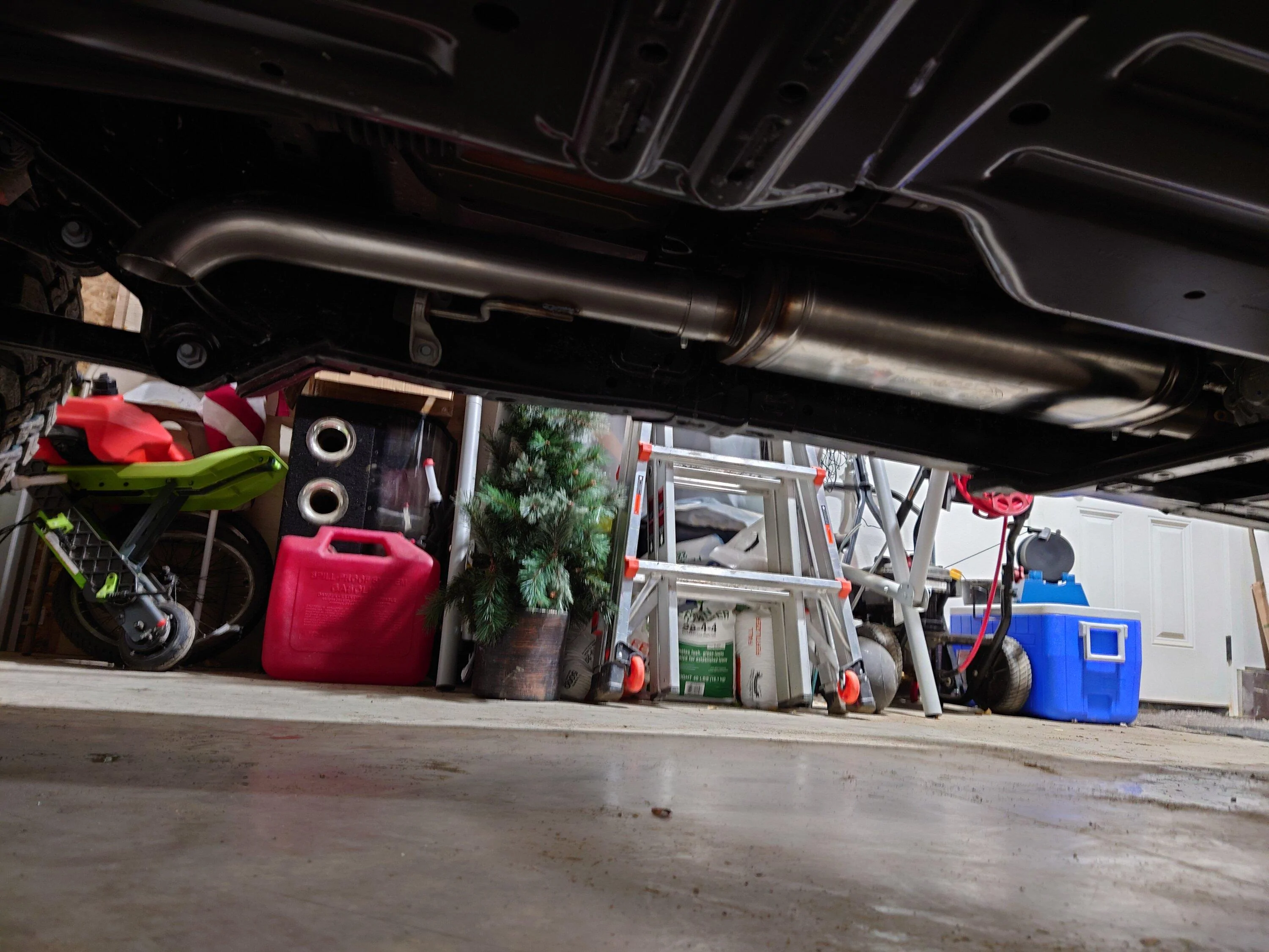

Installed my AWE Trail Edition cat back exhaust this morning. The most difficult part was removing the stock exhaust in one piece. I dropped the spare tire and removed the aluminum shield but it was still too tight to get it over the axle. I used a motorcycle lift under the frame just in front of the rear tire and the old exhaust slid right out.
