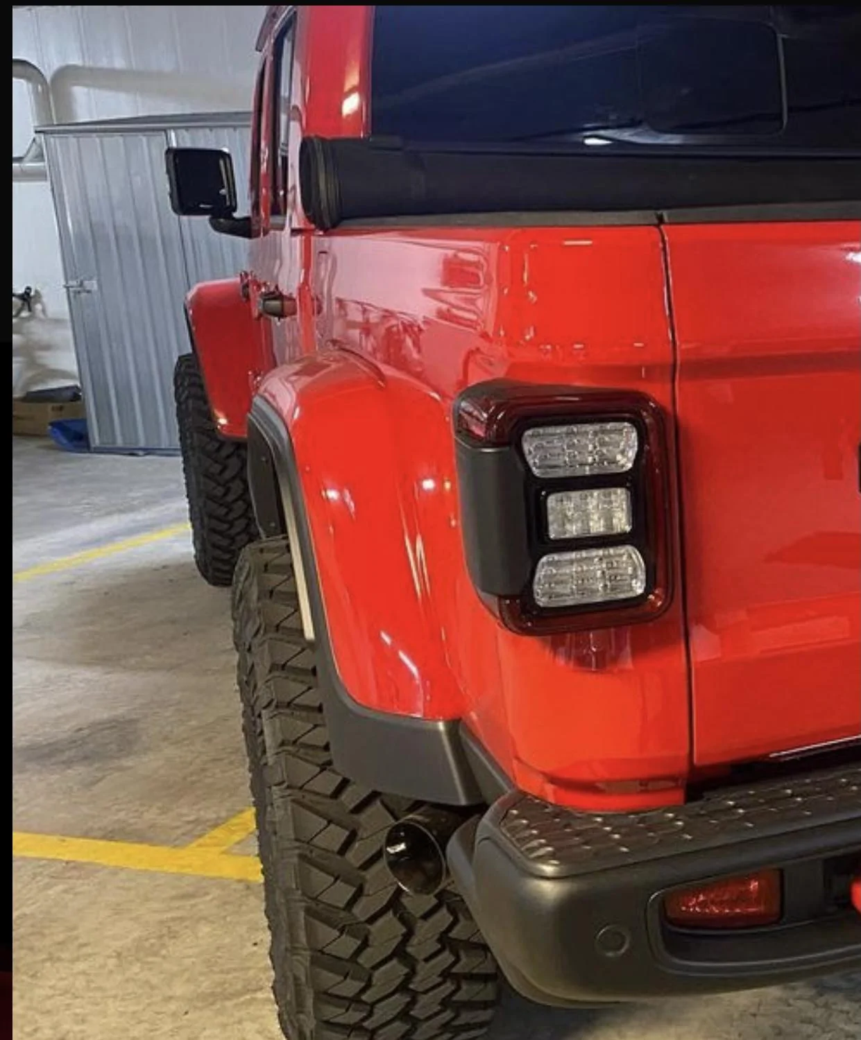

I know everyone here is very excited on the rear fog lights, but does anyone have any updates on the export LED taillights ? I really want to run them. Photo for reference.
Jeep Gladiator Export Tail lights on NA Spec Gladiator 4B831864-B974-4F67-99FE-46F1A6A1856F

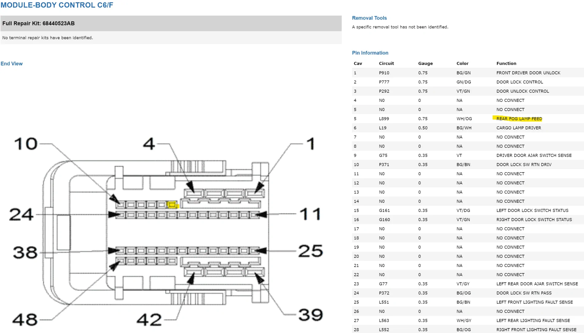

Not sure if this will help anyone, but the Rear Fog lamp feed appears to be in position 5, on plug C6 of the Body Control Module:
Jeep Gladiator Export Tail lights on NA Spec Gladiator 1608858012552
I’m still waiting on my lights to show up. They have been back ordered for a pretty long time.

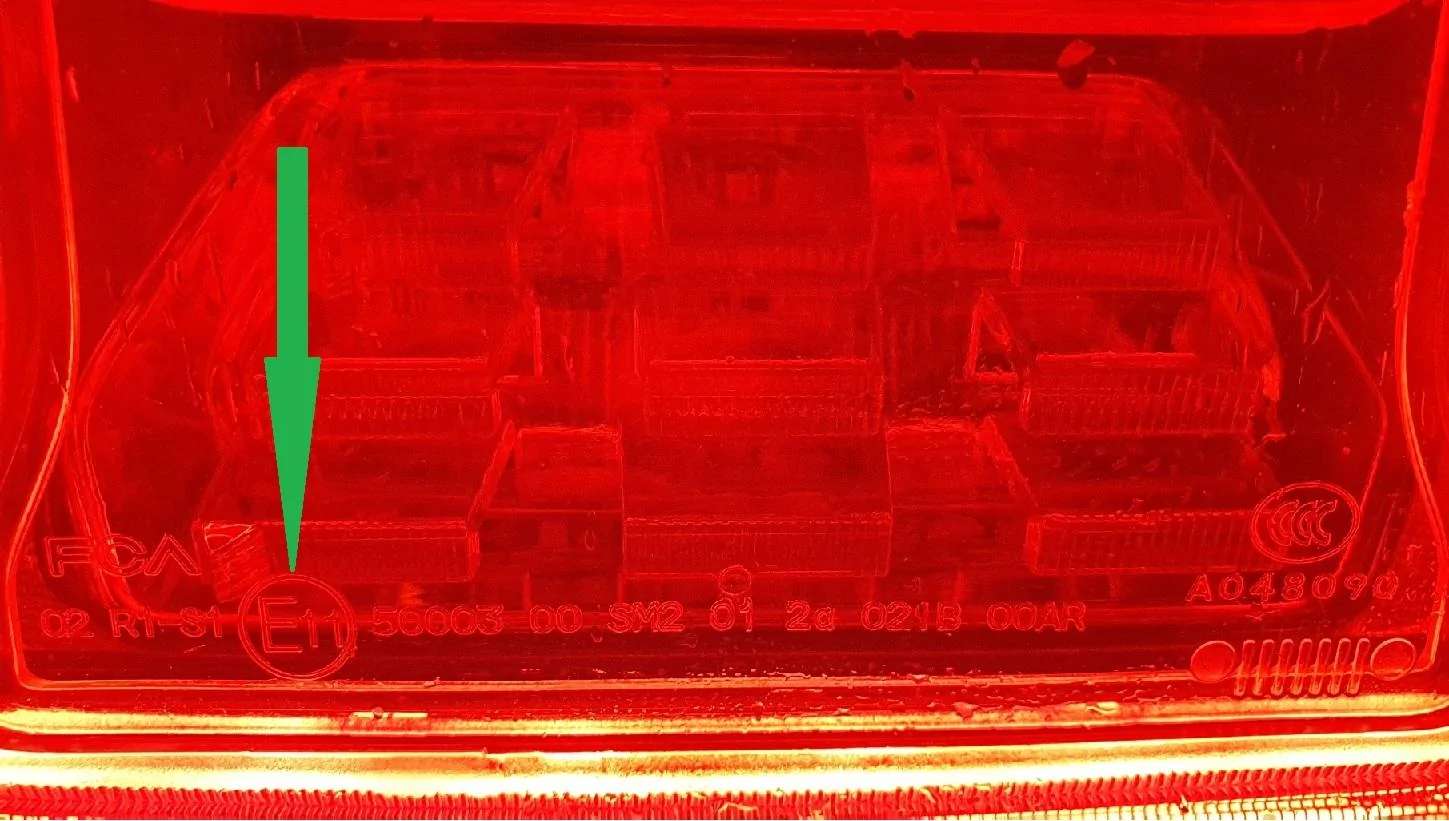

JTRUBI, when you will receive your export tailights, would you tell me if ''E11'' is inscribed on the base, like on UE JL tailights ?
Jeep Gladiator Export Tail lights on NA Spec Gladiator E11

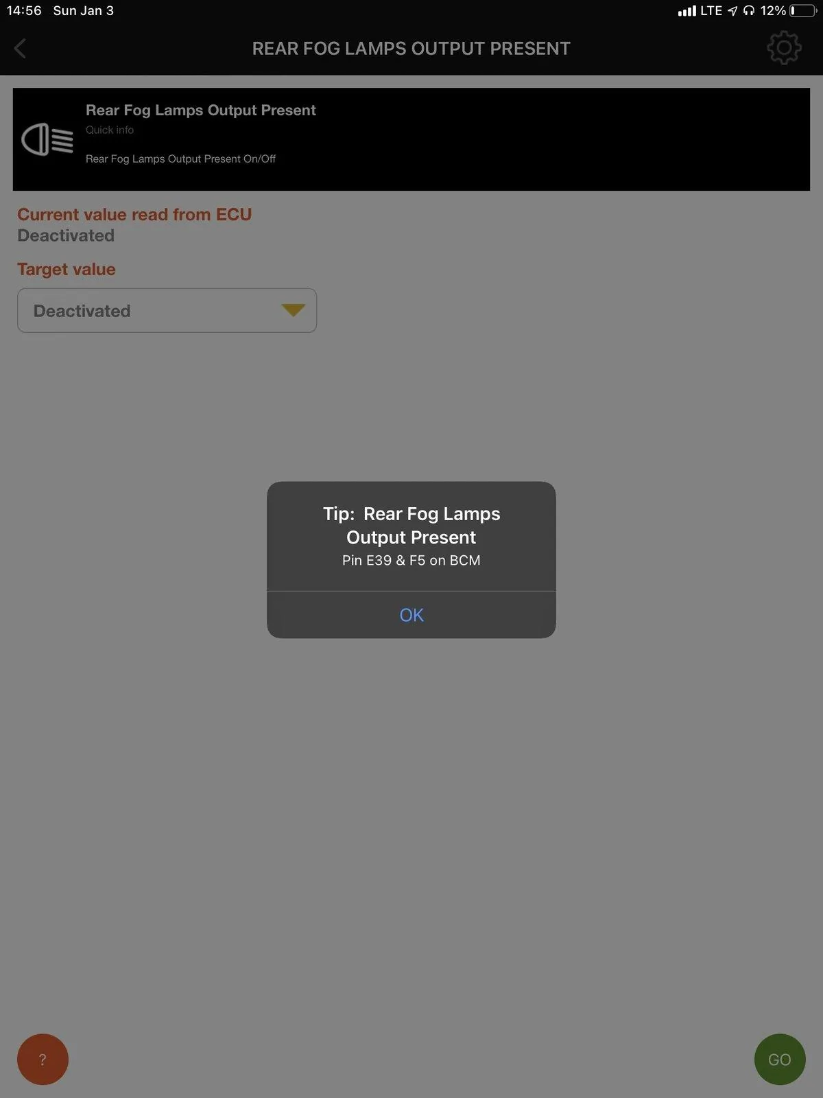

I was messing around with JScan today and this is what it showed in the activation of the rear fog light.
