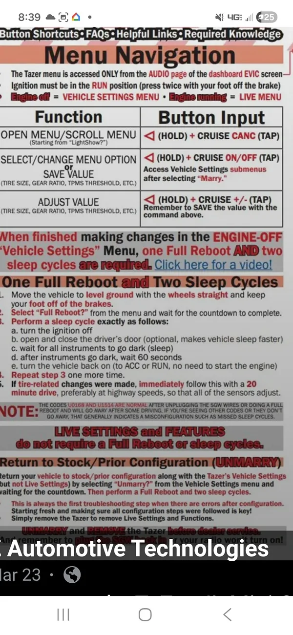

I am wondering if the TAZER flipped one or more of PID's for the aux switches?

Do you have the taser mini installed? Same thinking has happened to me had to full root.
so if i may ask i keep reading that you all have had to do a full root would you please explain better those steps as i believe i have ran into the same issue with my tazer mini thanks

The canbus network designed and works best at 60 ohm. To bypass the SGM, the Tazer shorted all 3 bus C and IHS together at the SGM connectors. The issue is each of those bus has a connection calls (AT) from the head unit, which induce an additional 120 ohm resistance into the circuit and bring it down to 40 ohm. That’s in an unreliable range, which can causes some weird electronic issues.
To verify this, one can checks both CAN C & IHS resistance at the DLC, with and without the Tazer connected.
