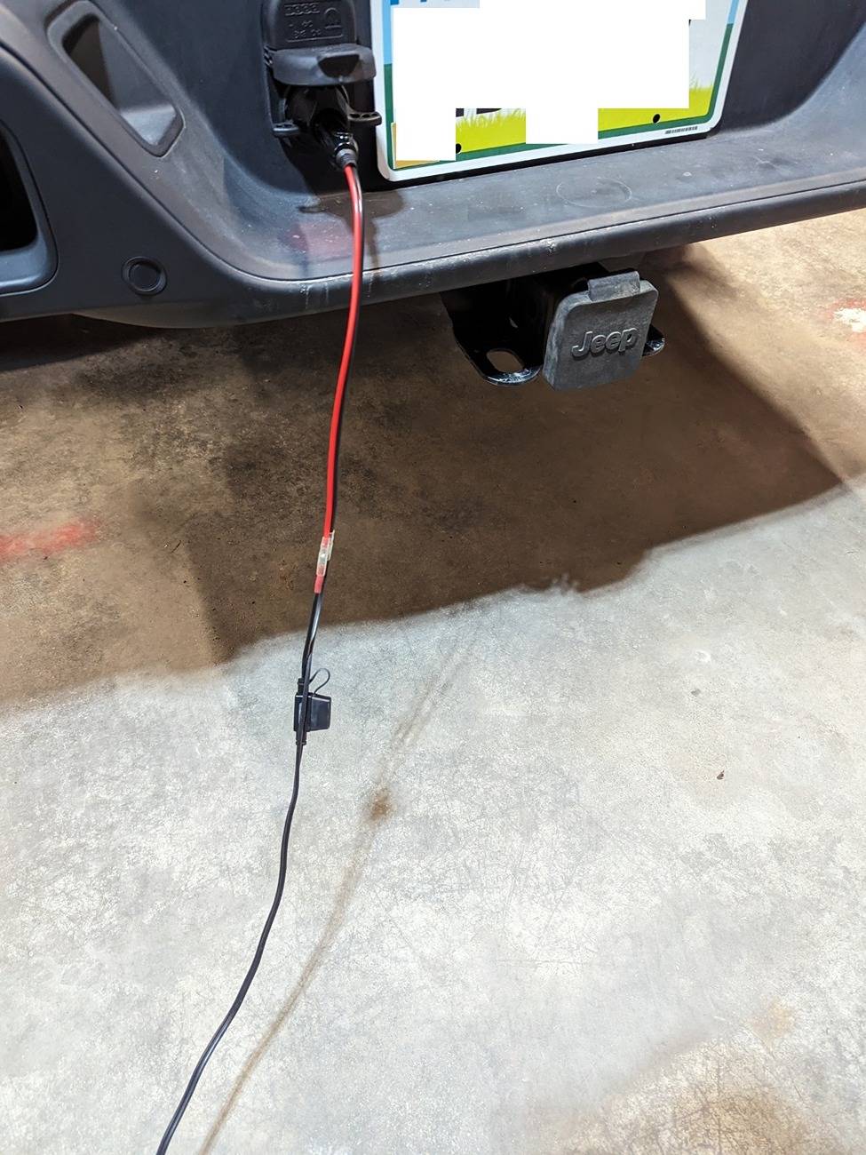

This is how I charge mine when it sits for a few days (and it's been sitting a lot since I'm not really supposed to be driving with new meds and med conditions)
This contraption is fantastic

I travel a lot with work so mine can go easily a week without running.
Care to share more about this impressive setup?
Oh, boy. Learning from youtube video.
The batteries were extremely low. That was the problem. No need to search youtube and get into that "the aux battery causes poor mpg, climate change and death wobble" types of stuff.
But it's the "in thing, cool Jeep thing" to do. Why? Because it's repeated so many times.
If any of my cars sit for a month - they go on a tender (BatteryMinder)
My original batteries lasted fine in my first Gladiator, and the batteries in my current JT are over 2 years old and doing just fine.

Looks like he is using the trailer plug to feed 12v to the 12v accessory and ground to the ground. Fused as well. No need to pop the hood. C7 Corvette uses similar setup using a 12v power port in rear hatch area. Nifty.
Adapters like these make it easy to do.
POLLAK 11-896 7-Way Power Outlet Adapter https://a.co/d/0nRgl1J
Tow Ready 118019 7-Way Cigarette Lighter Plug Adapter , black https://a.co/d/cbGg6gH
