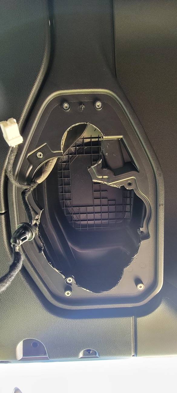

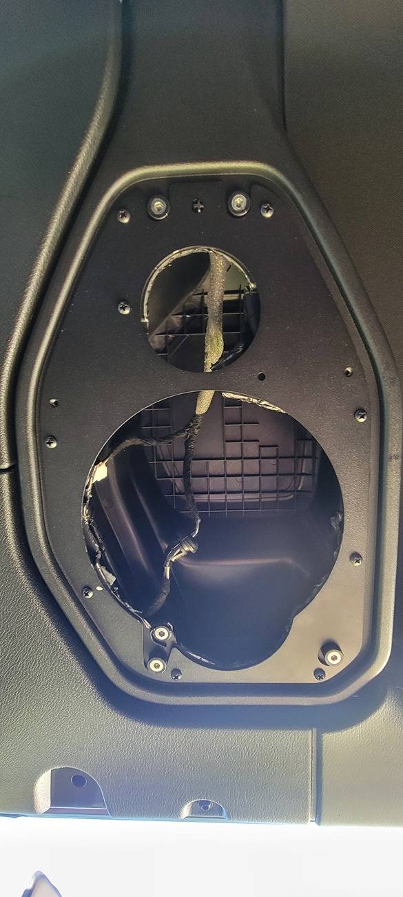

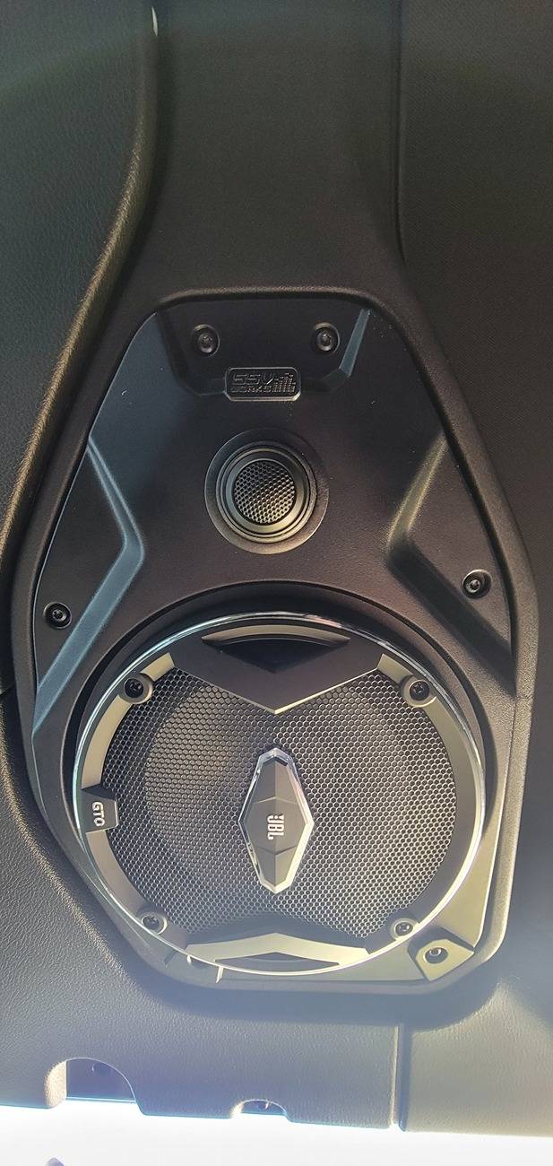

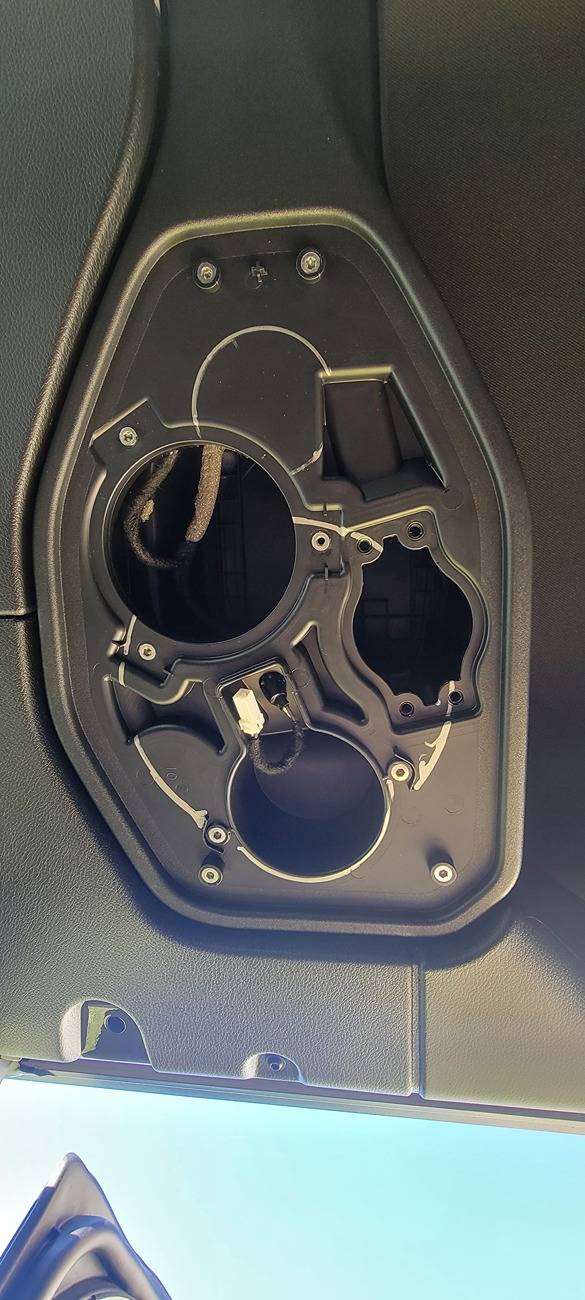

Kinda late to the party. I have the Alpine system but wanted a little better sound so I put Infinity tweeters in the dash and 6 1/2" JBL / tweeter in the sound bar. Didn't mess with the knee panels. Definite improvement. Attached are a few picks of the sound bar and how I marked/cut out some plastic so the plate and speakers would fit. Also added some stuffing in the hole to improve sound.
