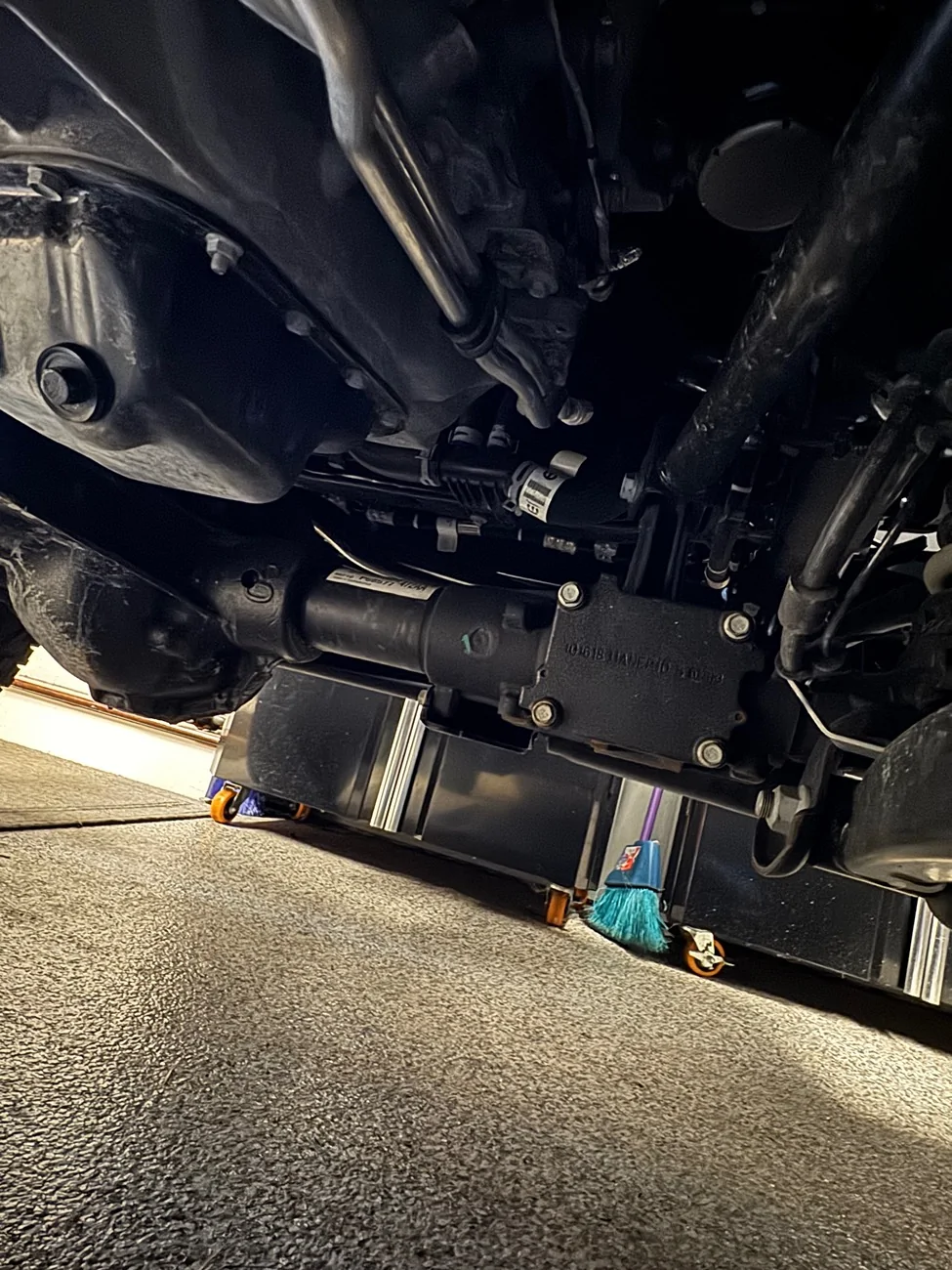

I have a 2024 Mojave X…..
Just crawled underneath to take a photo… If that’s not a FAD, then what’s in the box?

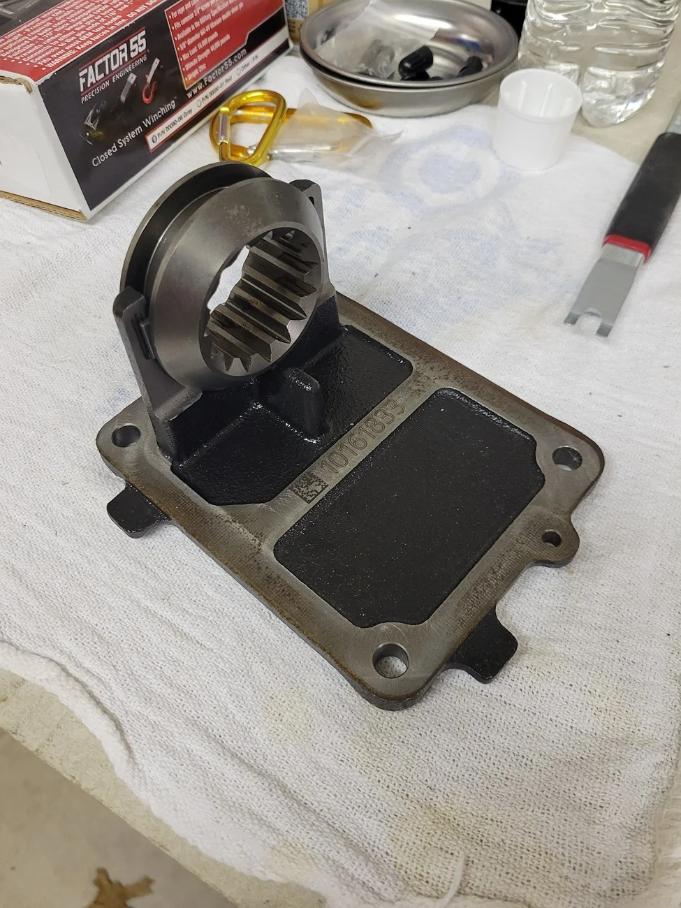

This is what is behind that plate.
THanks!! Interesting.... So, obviously the shaft is splined and runs thru that - and acts as a 'support'?? I can imagine those forks wearing away rather quickly.
