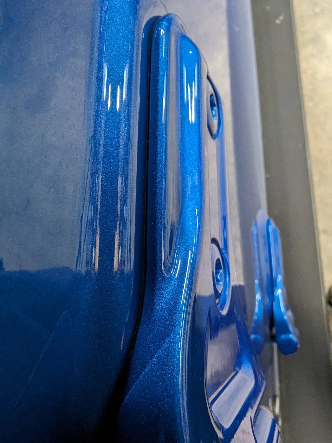

My 2020 had a gap between hinge and door skin.
Here's a pic of my 2020 door hinge - you could see a space, "somethings back there" -
Jeep Gladiator Farewell Jeep and CJDR 1702487974434

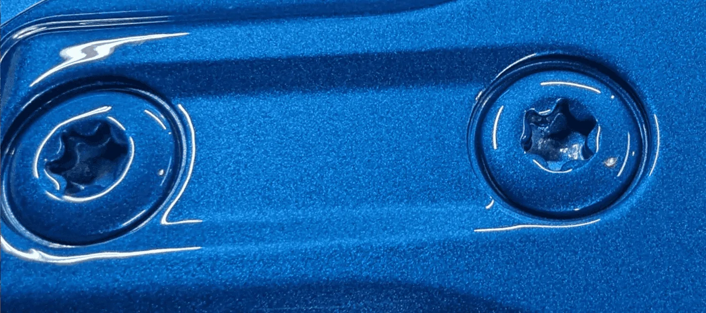

Looks like my 2022 also has "something back there" -
Jeep Gladiator Farewell Jeep and CJDR PXL_20231213_165602191
It can NOT be galvanic action between steel and aluminum - these hinges are not steel. At least mine are not. Same for the door hinge half on my 2020 - it wasn't steel.

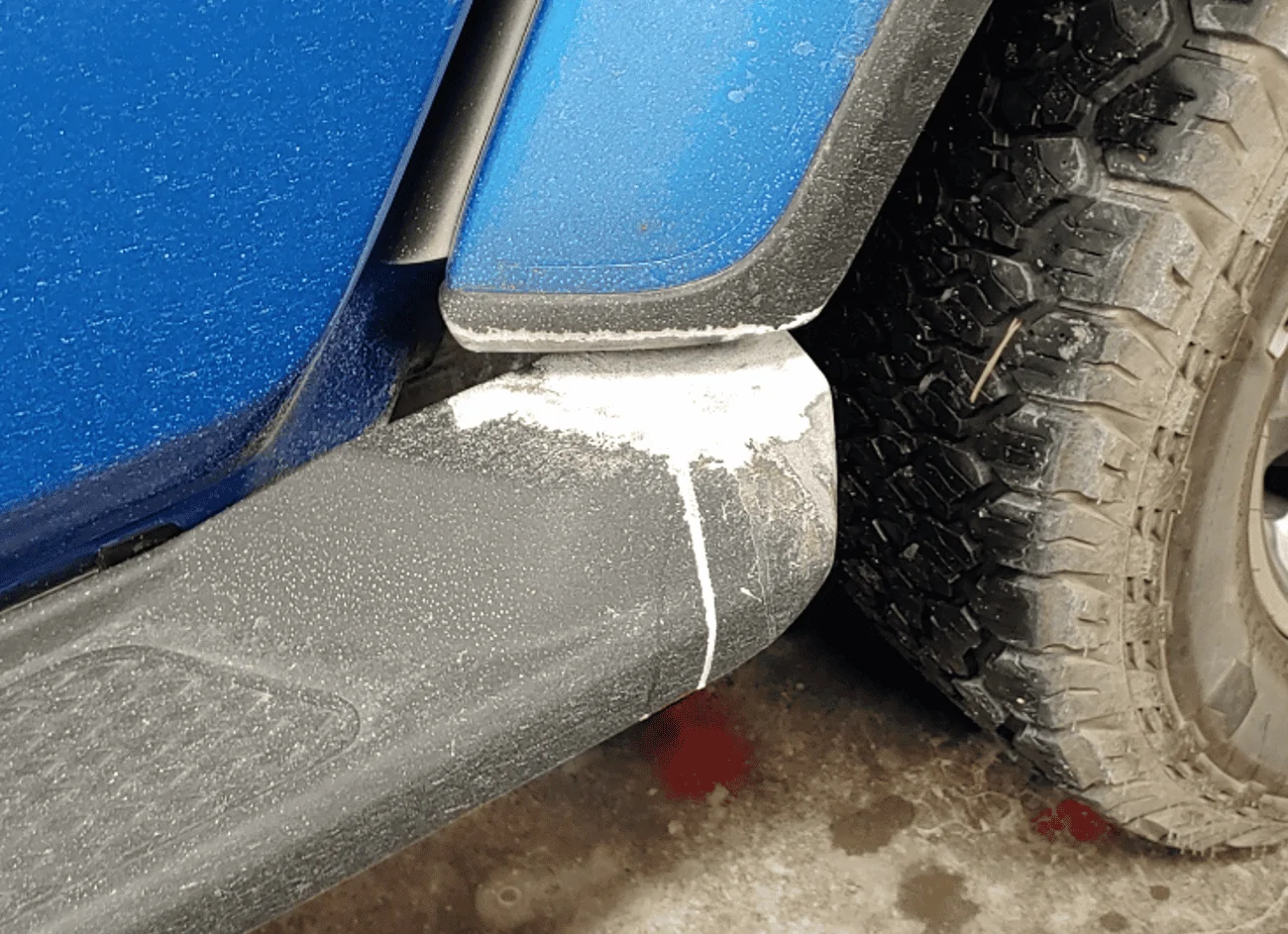

I'll never say never, but geesh, I live where they put salt brine in the roads and bridges when there's a chance of the temperature dipping to 33 degrees for fear of frost on things and they get that bring directly from the Dead Sea (it's not any climate stuff that's caused that sea level to drop, it's Polk County Iowa draining it to spread on the roads here)
It takes MOISTURE, any moisture, to cause or allow galvanic reactions. If it's a totally dry bond between the dissimilar metals that is sealed, there's not a problem. That's why in some of the marine chat areas you see people who have steel attached to aluminum without any problem they use a special sealer.
Also - pure water will do it but impure water does it better - add any metal chloride (and over 90 elements on the periodic chart are considered metals) and you get more reaction - it enables it.
So with the brine spray constantly hitting the sides of our Jeeps (the running board or power steps in combination withe "mud flaps" are a HUGE HUGE help that way - got pictures of the difference before and after) I keep watch anyway. Things rust here - anyone in Iowa selling a classic car and saying they have owned it all their lives - meh, likely has no frame left.

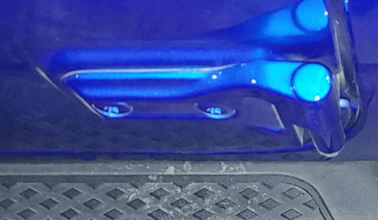

Since the hinges are not steel................. at least not the part on the door - then it's got to be something else going on. The only thing I could think of is if the door half of the hinge is a zinc alloy - then all best are off as zinc is so danged picky, when I do a thorough cleaning for restorations of alternators or wiper motors, any cast zinc parts start to "flower" and show spots within MINUTES of my taking them out of my cleaning processes.
So I'm wondering if they are using cast zinc parts, or some alloy, but it ain't steel so the people on the Wrangler side over there can stop claiming steel bolted to aluminum is the cause.
Back when I first started seeing talk of this when I had my 2020, I took my strongest magnets to the hinges on the doors and hoods and not even a slight attraction.
I have noted that it appears, there's an insulator between the hood hinge bolts and the hood hinge, possibly the same for the doors. Steel bolts through another material, use a sleeve/insulator. Note what looks like insulators around those hood hinge bolts.
