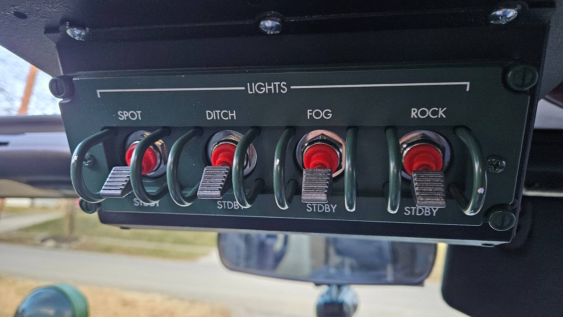

I went with S-Switch for the relay and wiring. I had a custom toggle swith panel made by Concord Aerospace for the actual switches.
Jeep Gladiator Favorite Non-Factory Aux Switch and why? 20240209_170313
