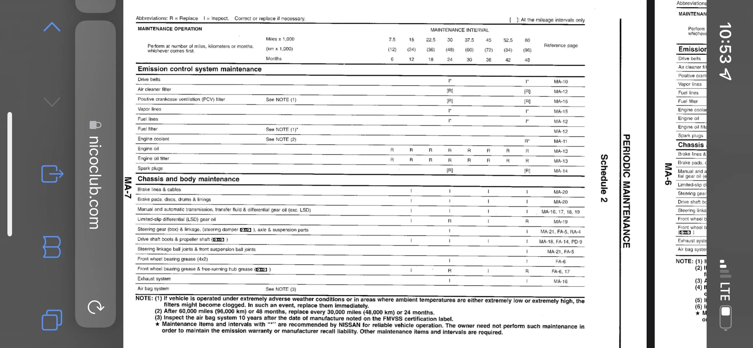

The owner's manual says the following on page 383-385 (PDF not showing page numbers correctly):
Under no circumstances should oil change
intervals exceed 10,000 miles (16,000 km),
12 months or 350 hours of engine run time,
whichever comes first. The 350 hours of engine
run or idle time is generally only a concern for
fleet customers.

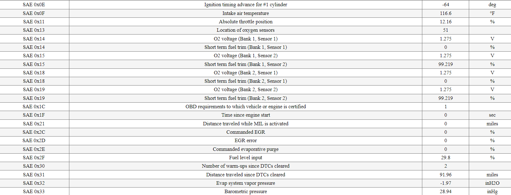

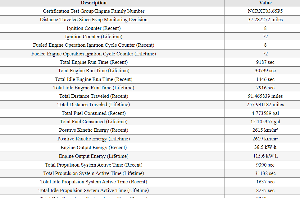

Is there a way to see engine run time? So you can see it and track for oil change intervals.
There is the two trip meters that will track run time since last reset, but they will roll over every 100 hours.
Total accumulated engine hours time to date will need a scan tool that can go into the PCM to find that data.
