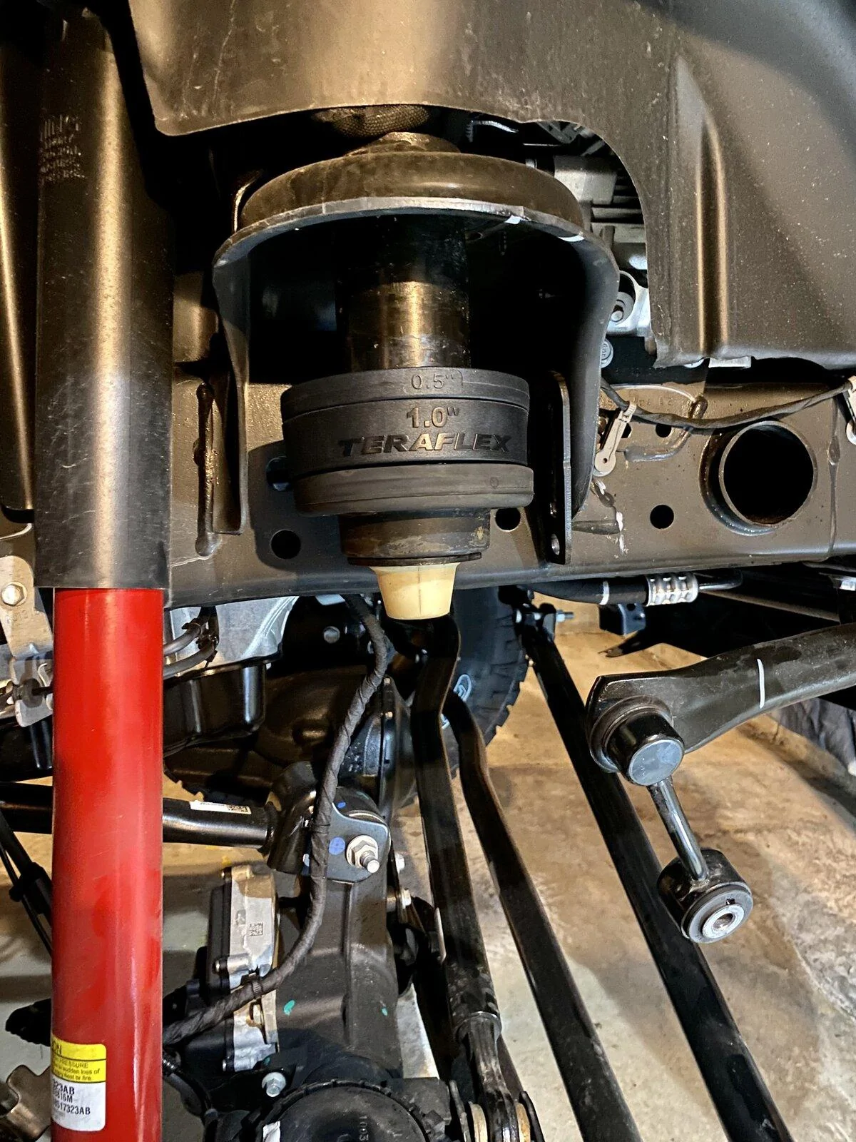

Hey all, put in the leveling kit last night. Couple tough spots but no issues. Everything went smoothly. Took about 6 hours for me start to finish. Didn’t even need to loosen the control arms as the method of leaving axel low and extended frame up gave plenty of room to get springs out. Jeep sits perfect now only about 1/8” higher in rear. Before and after below. Doesn’t look drastically different but looks much better in person. Thanks again for all the input!
