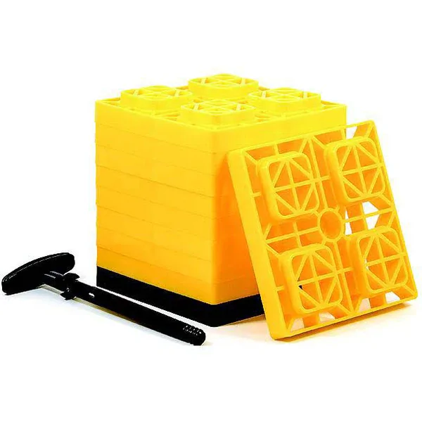

I have a bunch of these Camco leveling blocks that I use for leveling the camper. I wonder if that would work for what you're describing.

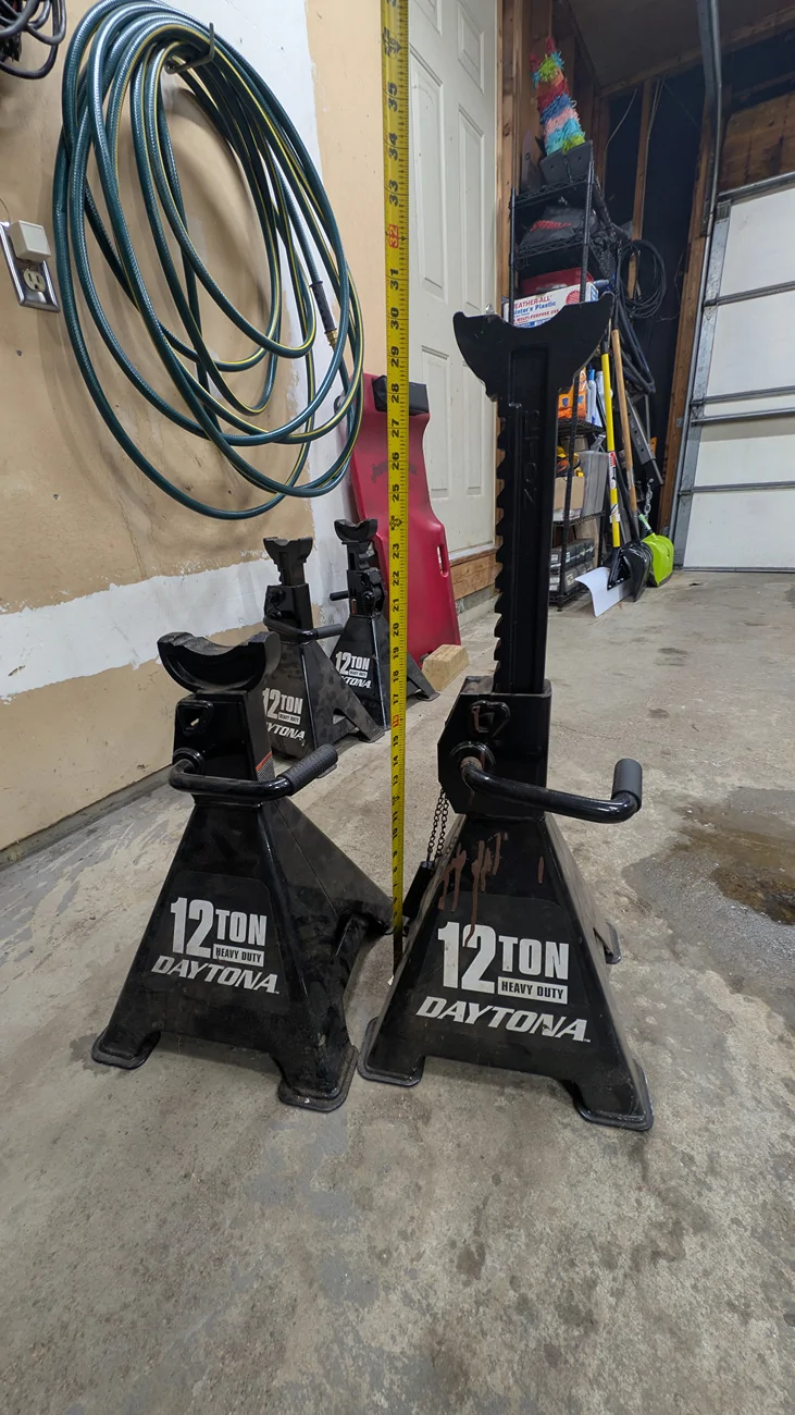

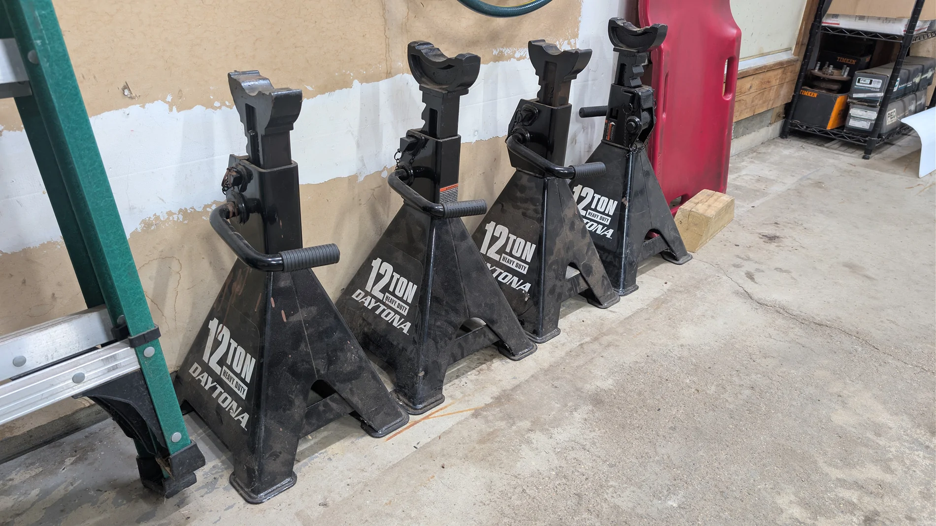

This isn't as difficult as you may think, once you take the tires off you get a lot more room for droop right there.
I use Harbor Freight 12 ton jack stands. Been using them for a long time, Completely ripped out the axles and rebuilt the suspension on a few Jeeps using them now. I spent a lot of time under the frame of my TJ shaving all the brackets off and taking it all down to bare metal, I trust them.

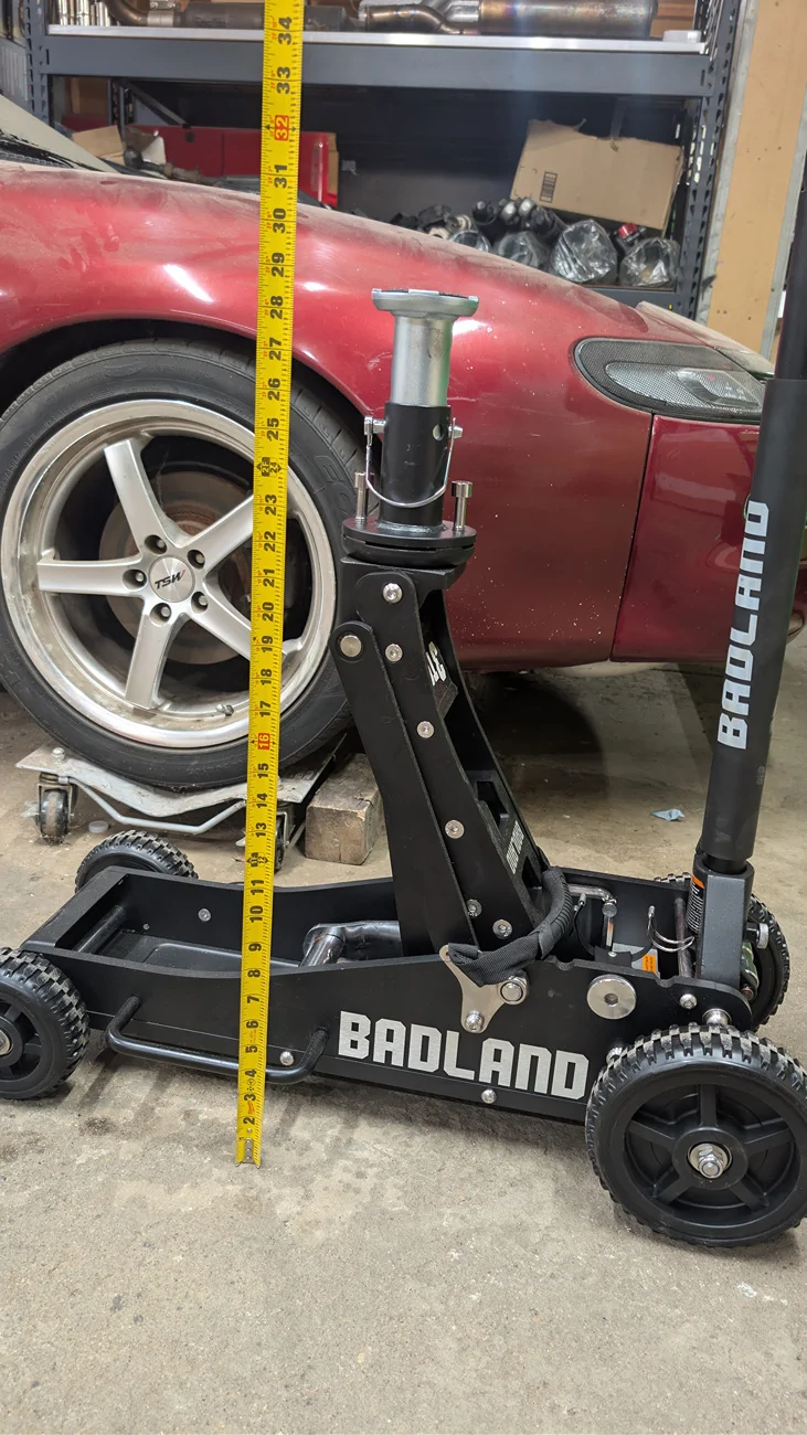

As for a jack, any decent 3+ ton floor jack is fine, especially if you've got some chunks of 4x4 laying around. I did just pick up HF's off road jack though, and it's been handy and the amount of lift is impressive.
In this photo they're still in the settings I used to completely remove the axles, reinstall, check travel, etc over the last month. They go much higher. I was supporting the JT at the frame just behind and in front of the front and rear axles:

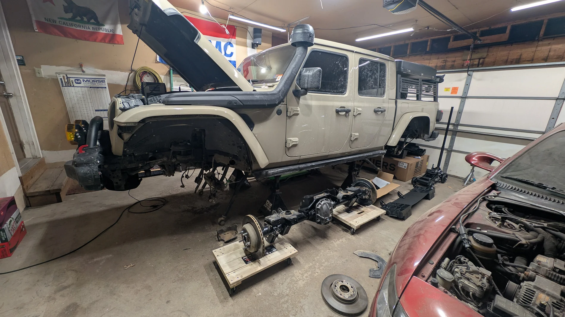

Jeep Gladiator Floor Jack & Jack Stands for full droop PXL_20260318_182431627
Axles totally removed but you get the point. It was high enough to not only remove the coils but set the axles down on carts and roll them away. I'm on 3" AEV coils that measures a bit over 4":

I don’t know, I’ve always used wood that was alternately stacked.
I wouldn't trust those either.
Properly built cribbing blocks made of 2x4 are good but for the price of wood you'll probably (bit of hyperbole) be in more than adjustable jack stands by the time you're done.
