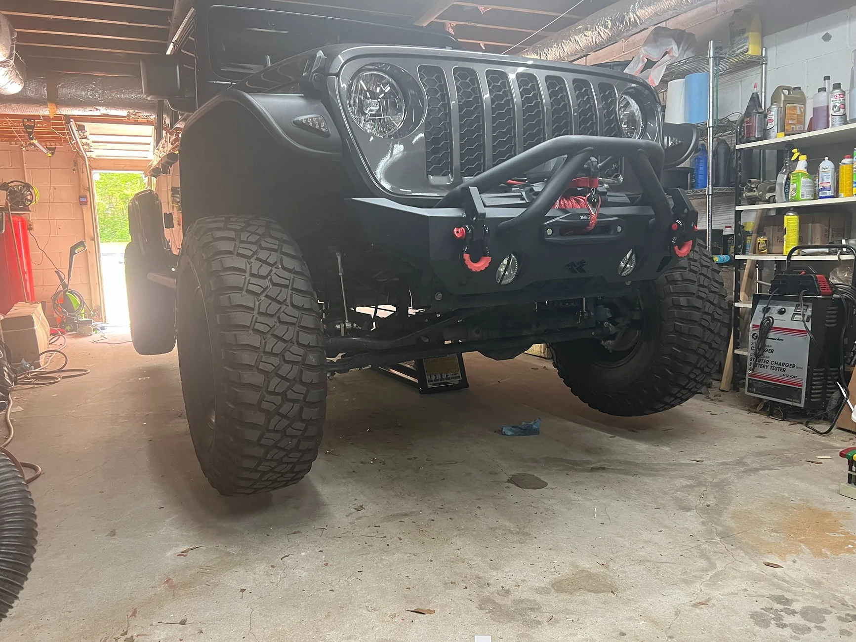

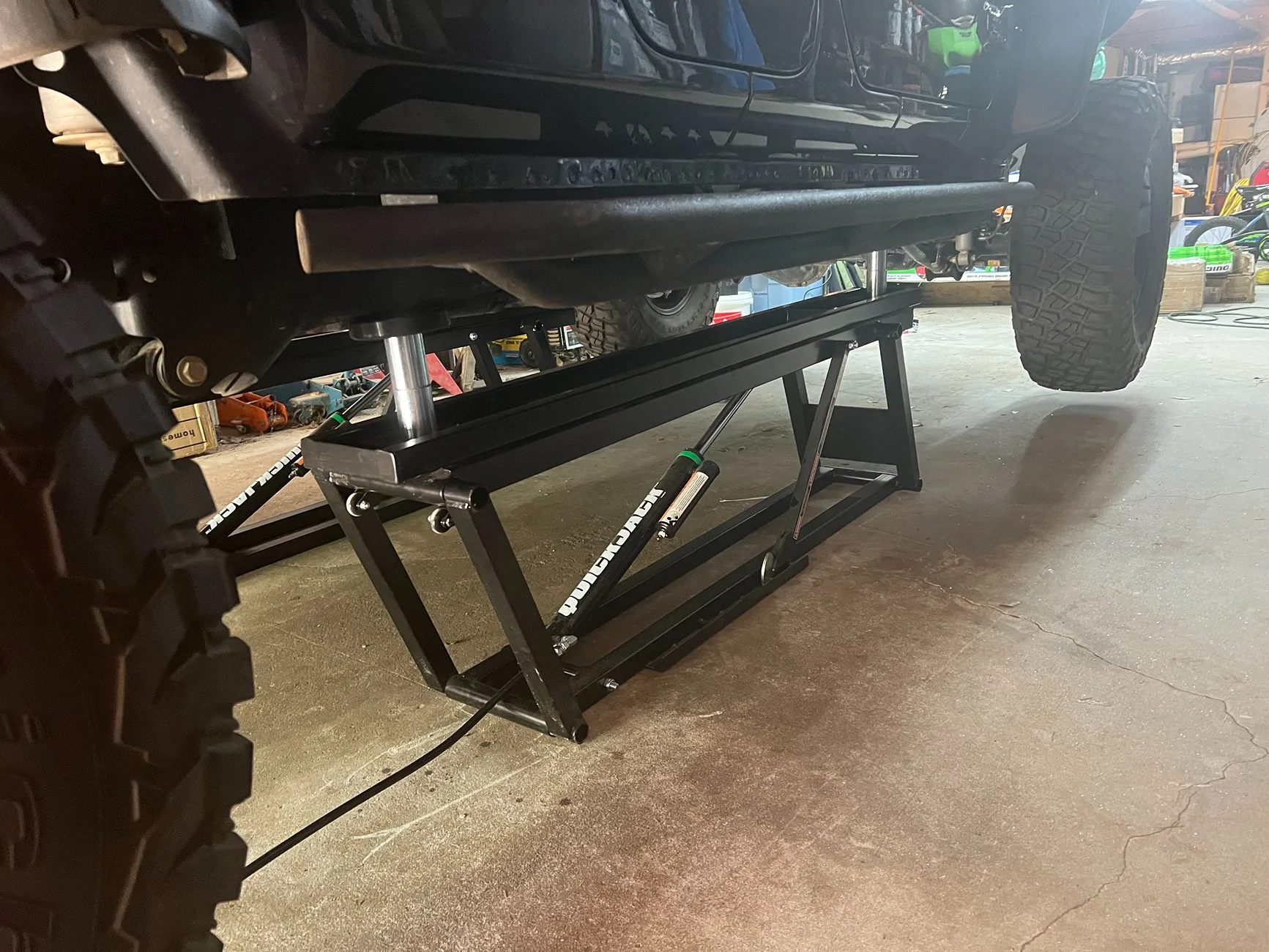

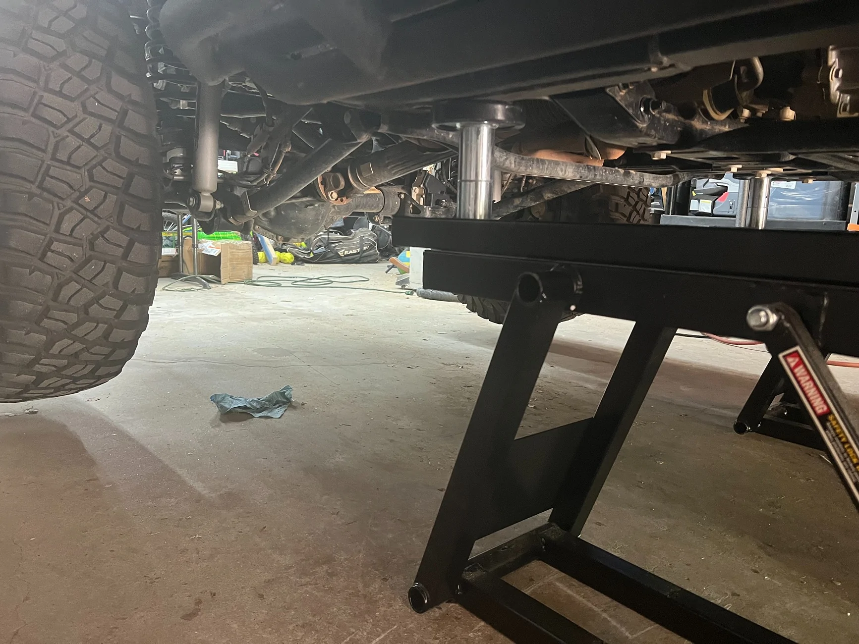

Going to have to get some height for sure. This is with my QuickJack 700's with the truck extensions and the higher pads. Gets it off the ground but not by much.
Jeep Gladiator Floor Jack & Jack Stands for full droop IMG_8512
Jeep Gladiator Floor Jack & Jack Stands for full droop IMG_8513
Jeep Gladiator Floor Jack & Jack Stands for full droop IMG_8514
