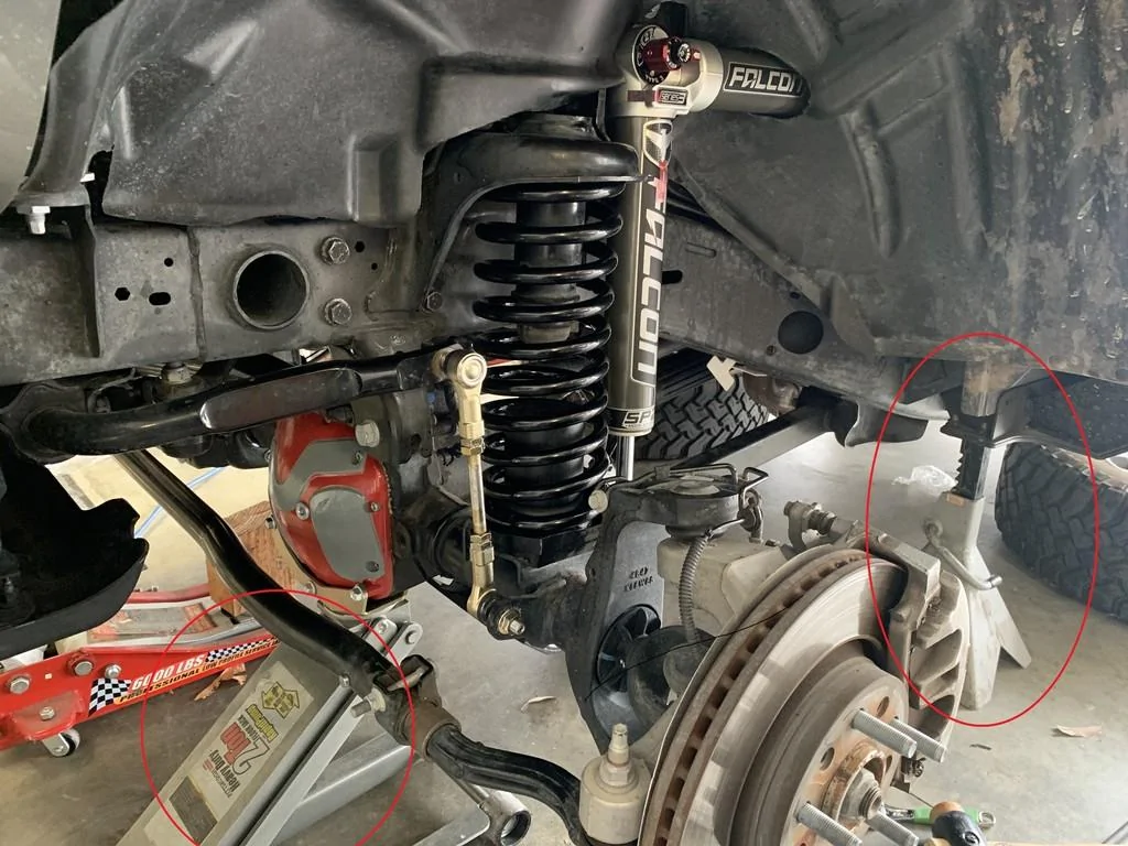

Using stuff you have in your garage. You need truck jack stands that you can put on the frame, you need to take the wheels off, and you need a jack. Here is a picture doing my lift kit. If it is a bigger job, you can use two jacks to tilt the axle to get the spacing you need. I also have some 4x4 and 4x6 wood blocks in my garage that I can use to move the body by the hitch if I need to. For a spacer lift, you will only need the one jack and the two good truck jack stands.
Right, I’m just curious on if a 21” jack is high enough or do I need to spend a little more for a higher reach?
