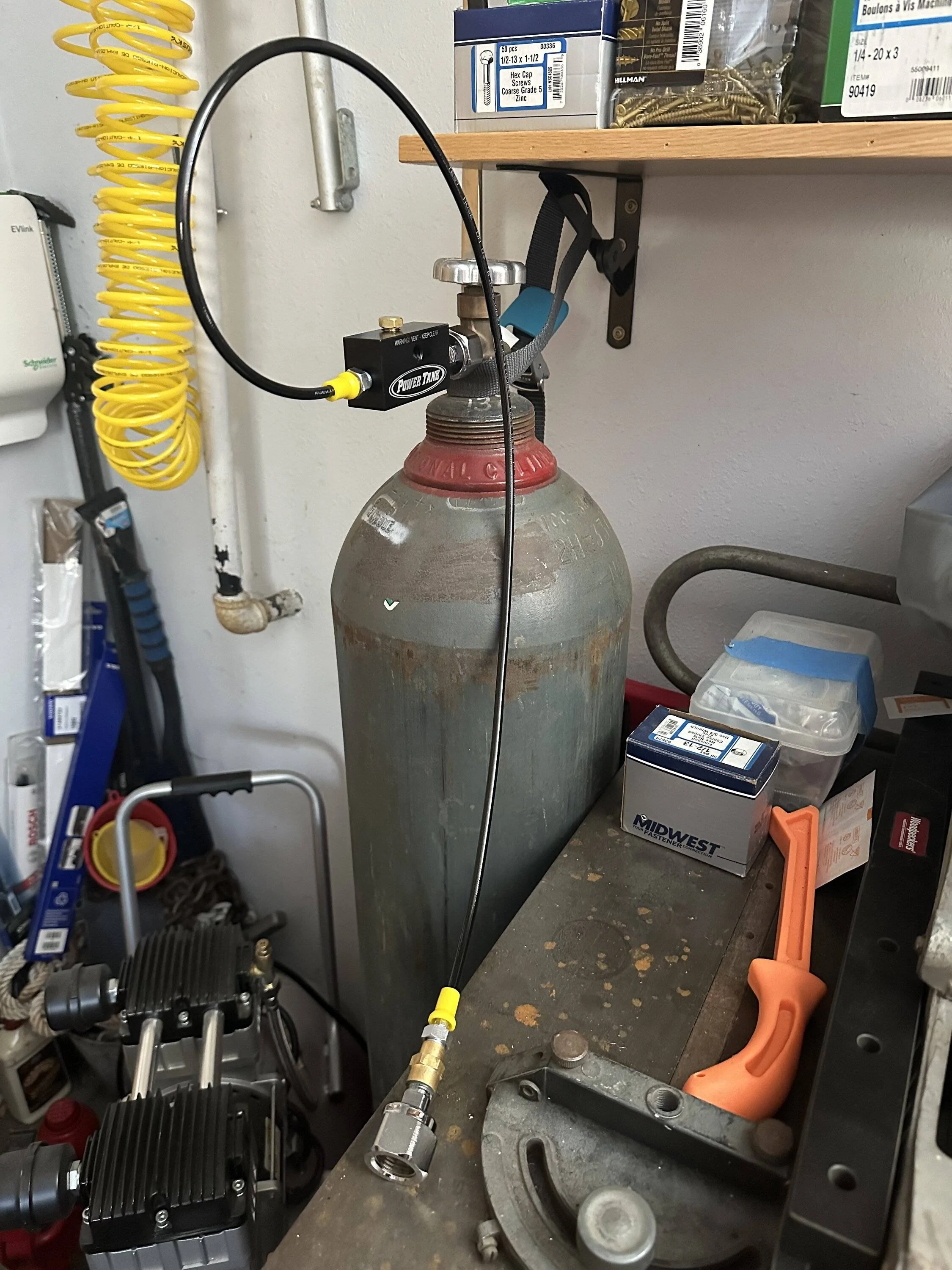

This shows the tank with the transfer hose connected. It was simple and perfect. And the vent valve made it very safe.
