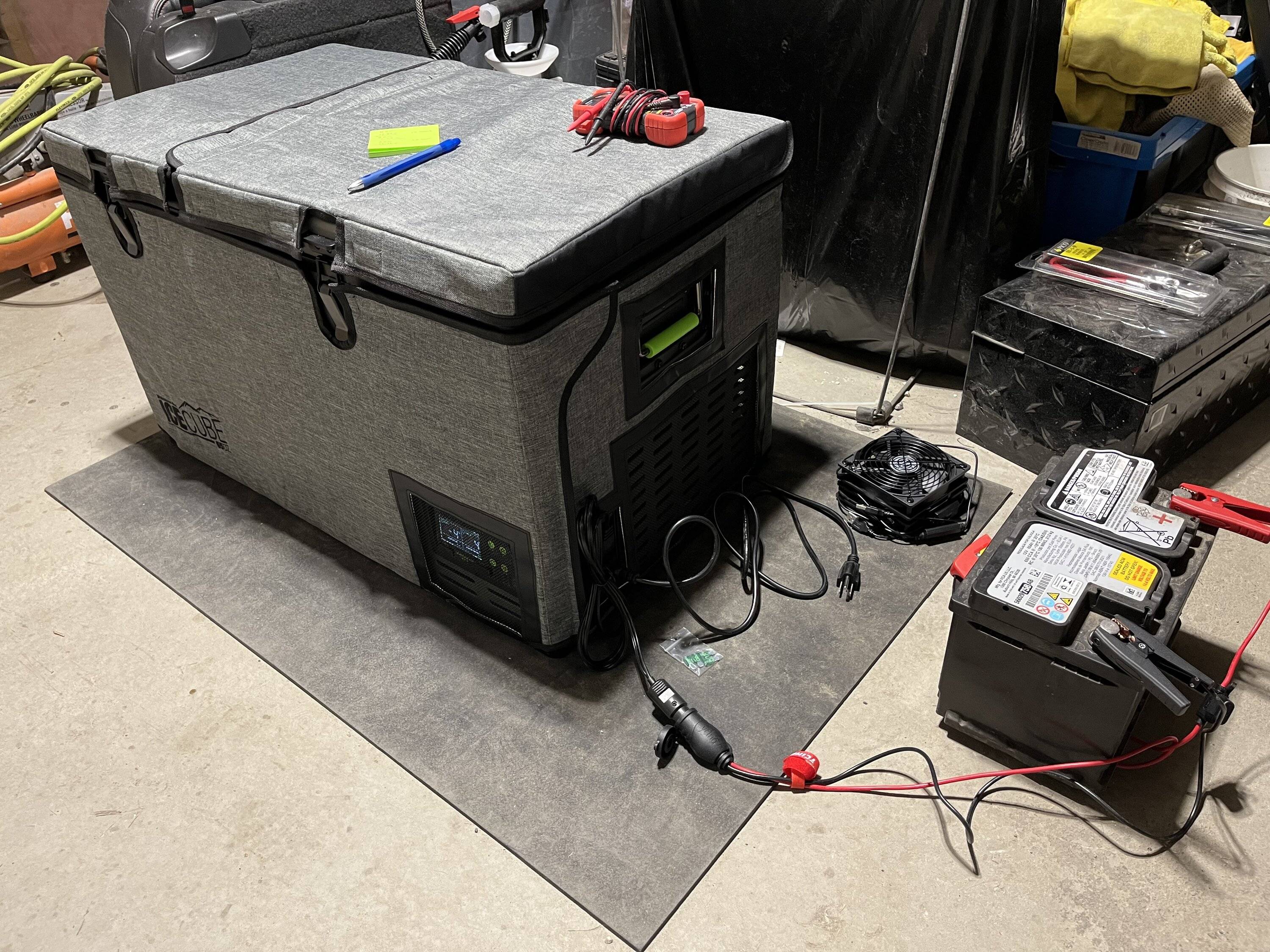

I am running the same Optima battery in place of the stock starter battery. My fridge is in the bed plugged into a cigarette outlet I’ve wired to the factory Aux switches. Fridge goes about 2.5-4 days depending on weather (with truck off) before getting low voltage and turning off the fridge. Truck still starts easily. I carry a charged jump pack JIC but I’ve only ever used it to help other people. I don’t dog on the guys with full dual battery set ups because they may need more power than I do. If the main power draw is a fridge I find my money and truck bed space better spent on beer and gas than dual battery stuff. This has worked from vehicle to vehicle over the years…drop in a high amp hour optima, get the power to stay on with truck off, and enjoy cold food and beverage.
I’m one of those that spent time considering a duel battery setup thinking this was necessary but I’m now realizing it isn’t for the wife and I and the one component (65L fridge/freezer needing a power source). I’m not powering anything else and make coffee on the stove. I can see our camping life changing next year with getting a power station and panels.
So, there’s a couple things I know now.
-My high amp Optima DH7 battery can run the fridge for 10 hours before voltage drops to the 12.4v range.
- The fully charged (13v) stock battery is now on 27 hours and fridge is still running and battery is now at 12.39v. Battery protection is set to LOW as I don’t care to have it as a booster backup. I’m going to be at this overland expo in Alberta and I’d lay all my chips down that someone would be able to boost me if my truck won’t start.
