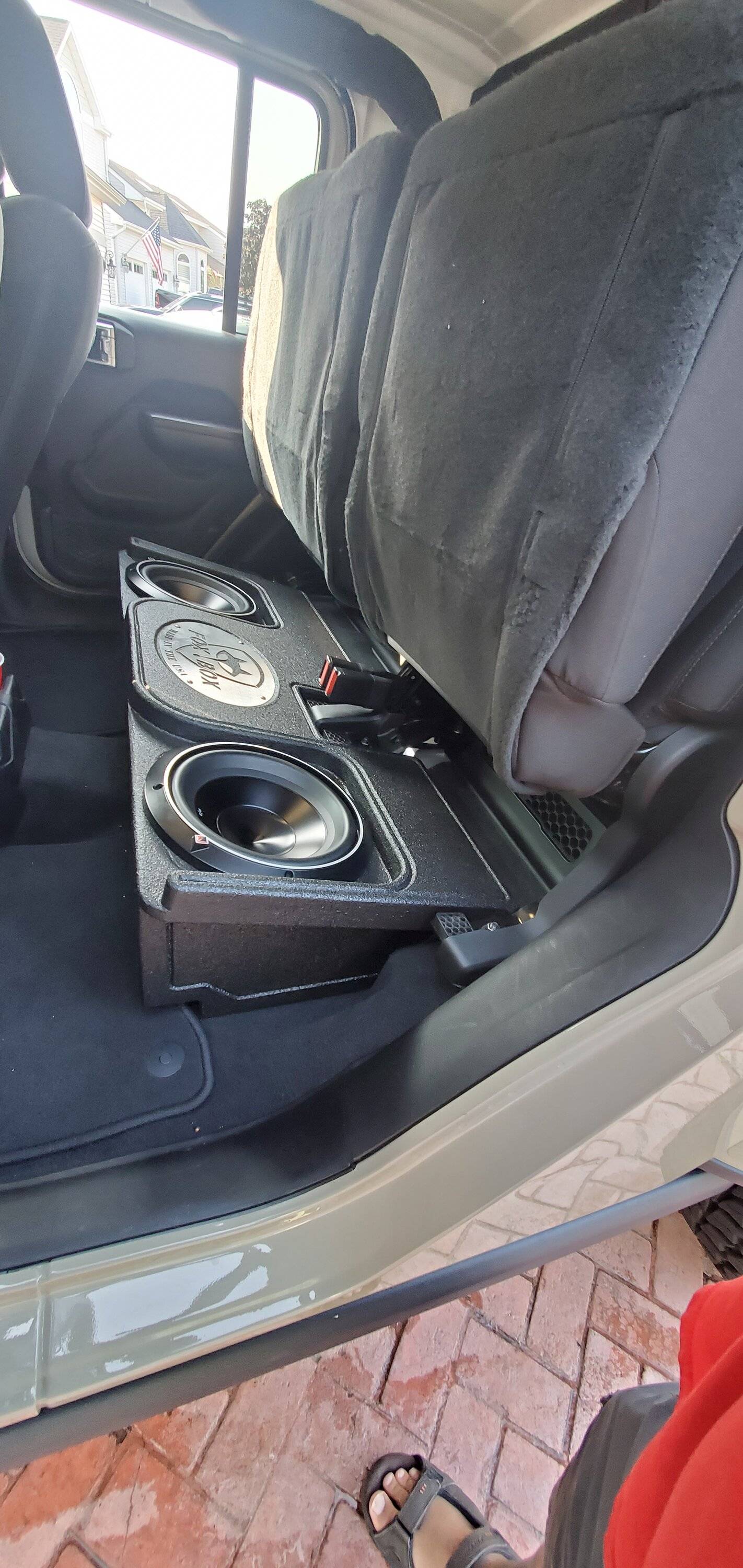

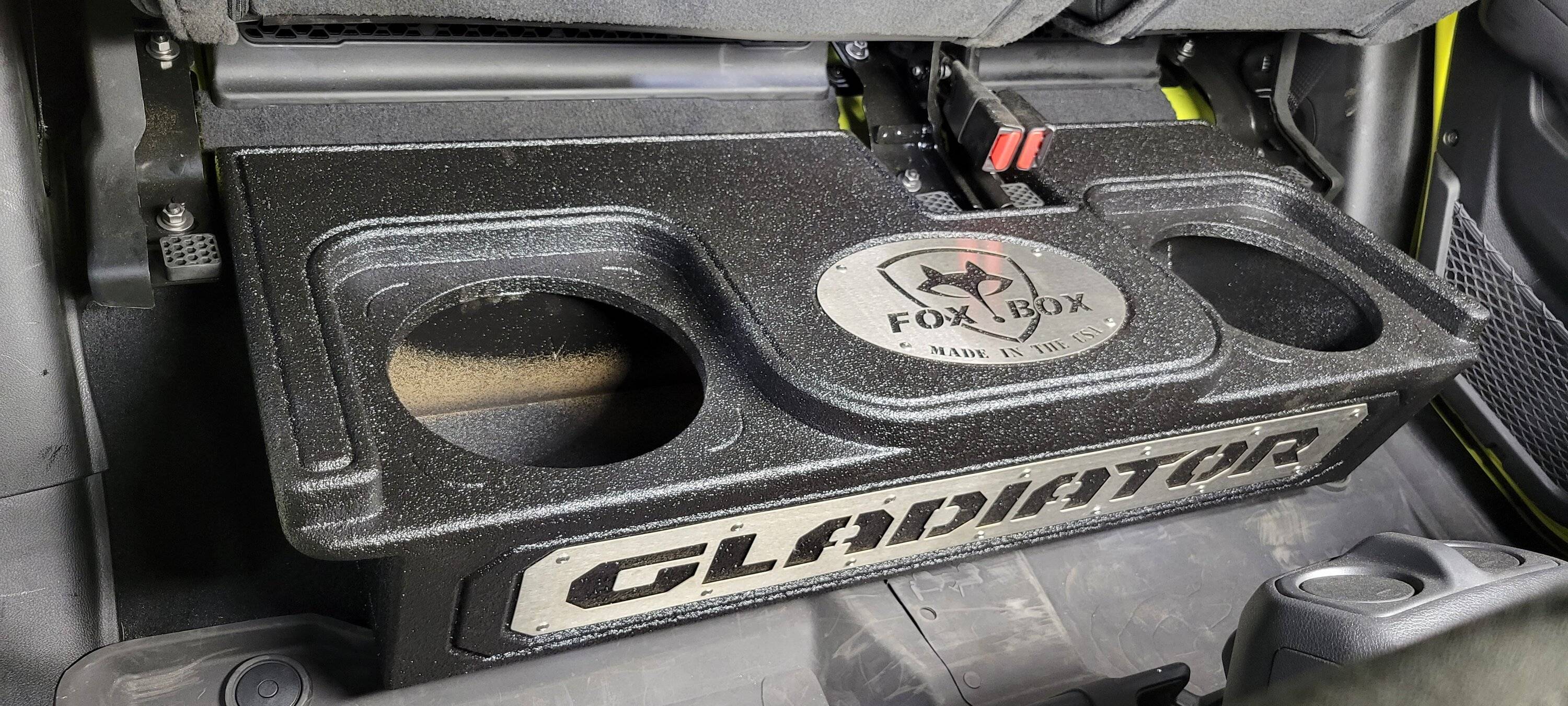

Fox Acoustics developed this dual 10 vented sub box and seat lift kit for the customer that wants to not just be a little loud, but VERY loud. Here are the specs.
Installation does not require any cutting or permanent mods to the vehicle.
Enclosure Specs
Mounting depth: 7" with 8"diameter magnet
Mounting hole diameter: 9.15"
The hole can be cut to fit square subs by the installer.
Subs with oversized frames may require trimming of opening.
Air space: 2.0 cubic feet NET
Port tune frequency: 35hz
The laser cut stainless badges can be easily removed and custom painted to your color of choice.

Order placed. Going with two adire audio brahma 10s and a 3kw rms amp. Should be wild.
Anyone want a single 10" enclosure w/sub and amp? LOL

Probably not me, but I’m curious what you had in there :D I just finished my single Fox 10” install and am loving it so far. Audison F1D and Morel SC102 10” at 800w.

I have a ssa gcon with a spacer and some handles to prop the seat off the woofer. It SLAMS. Using a soundigital 3k evo.

In my opinion, this is the best premade ported box you can buy for the JT. It is well worth the money, It sounds great for a ported box (I prefer sealed boxes). The seat lift it comes with is top notch. I would highly recommend this to anyone!
