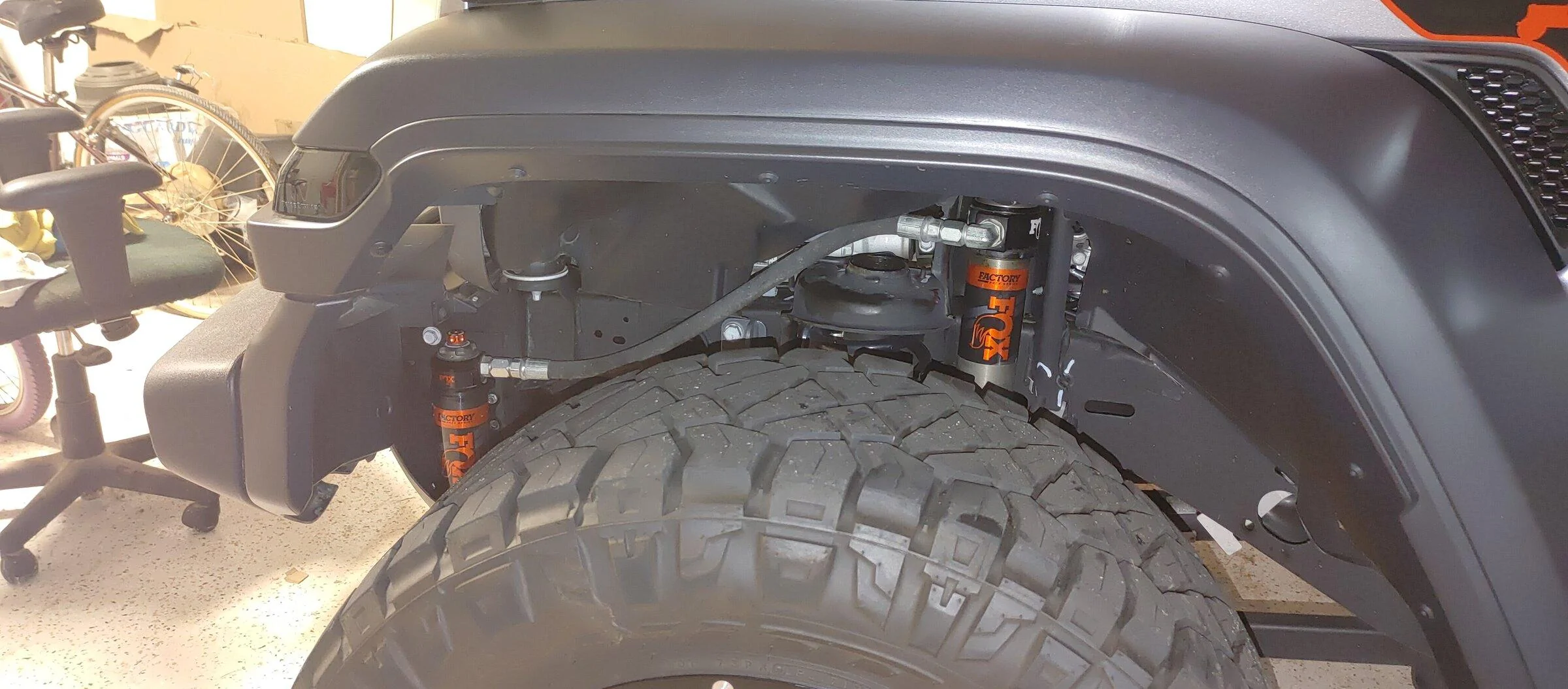

I have a Mojave with a 3” lift, 33” OEM tires and an AluCab canopy camper. I get bouncing on the back (I think it is just the back) and ordered the 2.5 Elites today to see if it will help. I hate to take the Mojave shocks off, but the weight is just too much for them. I also ordered 35” Yokohama Geolander XATs.
I will let you know of it helps. Hopefully I will not have to change the fronts too.

Did you do 3 inch shock extensions when you did that? I wasn't aware they had shock extensions that big for the Mojave yet.

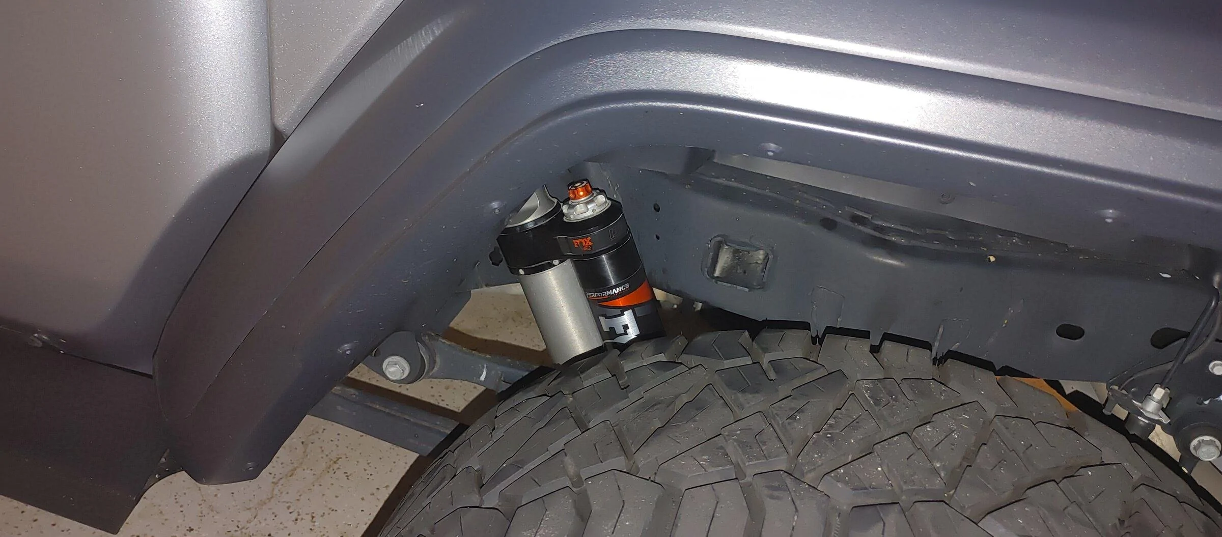

I put 2.5s on mine up from the 2.0s. runnin mopar lift with Yeti track bars and Synergy steering brace. 39" is alot of tire for highway driving, at speed. Overall I am very happy with the 2.5's. The adjustment is a little weird, but I am ised to tunning road race shocks with rebound and compression. These have low speed and highspeed. I started at the recommnded settings and have been slowly cranking up the low speed setting. My guess is the extra weight of my 35s calls for more damping. Love riding in WV. I am from IL, trust me we know about pot holes here. Ever since I got my jeep I can almost go the speed limit now😁

CAn you explain a bit more on the lowspeed/highspeed adjustment? I am thinking a softer low speed setting than the 2.0 offers would give me better piece of mind.
