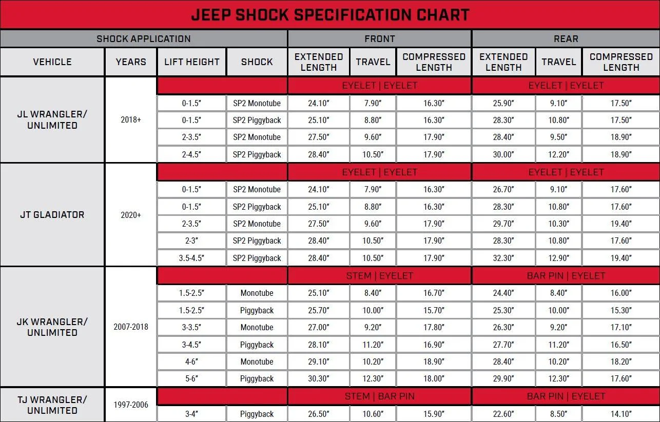

I am wanting to order some good shocks asap without spending $3K but finding them for a 6" lift and availability have been my biggest issue.. Who has pros/cons with Fox, Falcon, etc.. I had planned on ordering Falcon 3.3's this weekend but they only offer them for up to 4.5" lift.. I would love some feedback on Brands and experiences..

Here are the falcon lengths… you can match them up to the fox lengths.
So the fox shocks you linked are just are just resi’s with no adjustments. They do have that version with adjusters but they cost around $90-$100 more per shock. These would be a big upgrade over your stock shocks. The fox shocks have a 2ā€ diameter.
Now going to the falcons, you would increase the diameter of the shock to around 2.25ā€ inch and going 3.3’s give you adjusters.
I’ll make a suggestion to go to the fox 2.5 series. They go up to the 2.5ā€ body shock and not only give you adjustment on high speed but also low speed… the only issue is the length of shock for the amount of lift your going to get.
I personally went with the falcon 3.3’s due to the lengths matched the lift I was doing with the recommended shock lengths the mfg gave.
but if money is an issue the fox 2.0’s with resi’s will be
good.
good.
