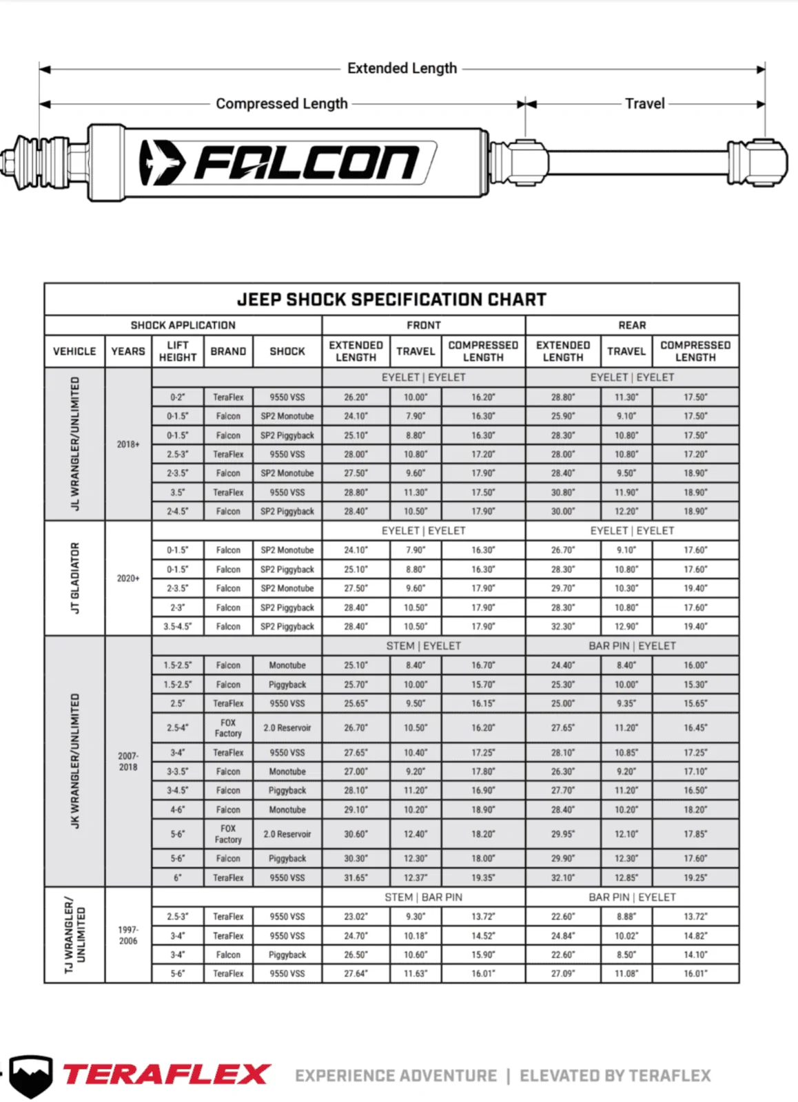

I have the Falcon SP2 3.3 on my JTR for about 40K miles now. Lots of off road and badge of honor trails at 13 psi or so. So far, I am very pleased. they have been bullet proof, and the change in every setting can be felt. I am running 37" tires with a 3.5" Clayton lift. I like setting 2.1 off-road (Rock crawling) and 2.6 setting on road, with the SP2 set to "cold/soft".
No sway on the road, and I am running the light duty Rock Jock sway bar in the rear. In addition, the rear shock for the Gladiator was the longest piggy back shock I could get for my lift at the time - 32.3" extended length. So, with these shocks, the rear will give you more articulation that most other shocks. This is much needed for the long Gladiator in the Rocks. Because of this great rear articulation, I am also running the Teraflex Spring clamps on my rear coil springs.
I would buy these Falcon shocks again.
Note: Extreme cold and Extreme hot weather will change the feel of the settings because the viscosity of the fluid changes. So, I dial it up one or two settings in the Summer and dial it down when it is very cold.
Note: I do not run much off-road high speed stuff, mostly mountains and rocks in 4WD low. We also have lots of desert here, and when I do get into 4WD High and 35 mph, I dial up the settings and do not bottom out the bump stops.
