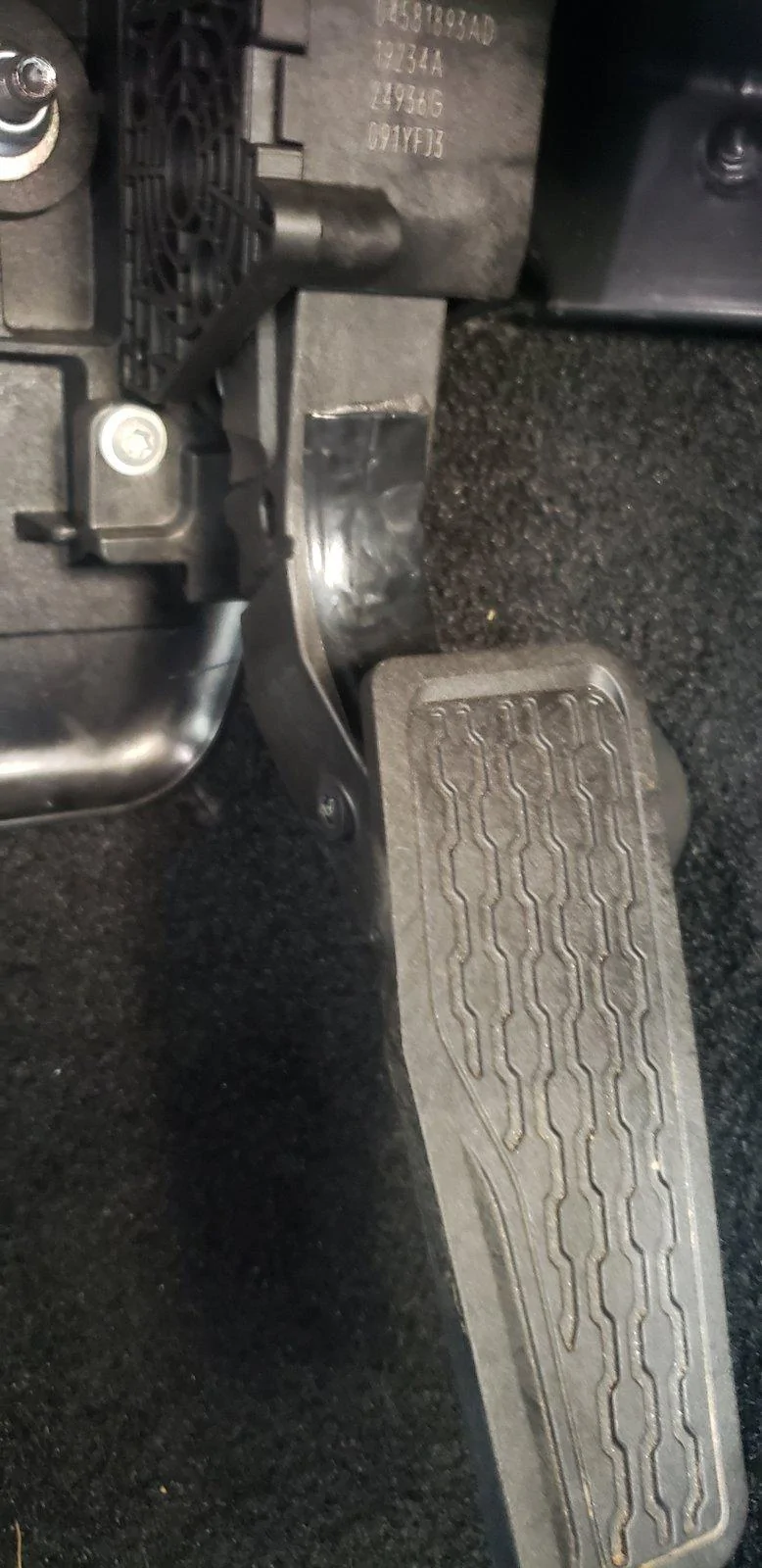

Really a bit of a nit pick but any music with some base sent vibrations through the gas pedal and into my foot. I had some hushmat
Jeep Gladiator Stereo sending vibrations through gas pedal. 20200822_164041
pieces left over from putting a couple panels under the front floor mats. I cut a thin piece and put it on the arm of the gas pedal. It reduced it enough that I dont notice it any more. Not super clean looking so might re-do it later. Just figured if it annoyed anyone else this works.

Ha. Me too but something about the plastic gas pedal with no rubber foot pad made the vibrations more noticeable.

I've run into this quite a bit, as a mechanic it always makes me worry for a split second cause I'm thinking "great what gear or bearing just died in my drive train to cause THAT vibration"
Then I remember it's an electronic gas pedal and I'll never actually feel feedback in it ¯\_(ツ)_/¯
Yep. I understand why they do it but I do miss the old mechanical linkage stuff. My last jeep was a 95 YJ. Was a bit surprised by how much it vibrated from the music but I didn't set out to fix it. I just had some extra sound deadening material left and figured "why not".
