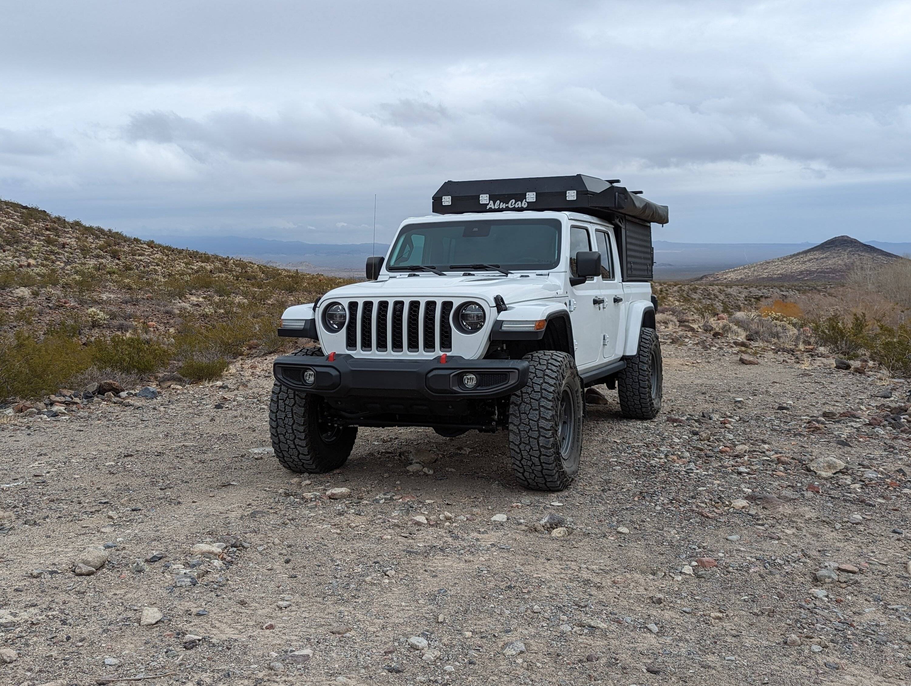

Jeep Gladiator Fungshui's Overland Build PXL_20221229_234010236
Jeep Gladiator Fungshui's Overland Build PXL_20221229_234545368
I wanted to get to camp before dark and took Laughlin Hwy to Balancing rock instead of starting at the wash. By the time we got on the Old Government Road it was starting to get dark. I stopped to air down but wasn't able to find my air deflators. So I had to let the air out on each tire manually.
Jeep Gladiator Fungshui's Overland Build 20221229_163435

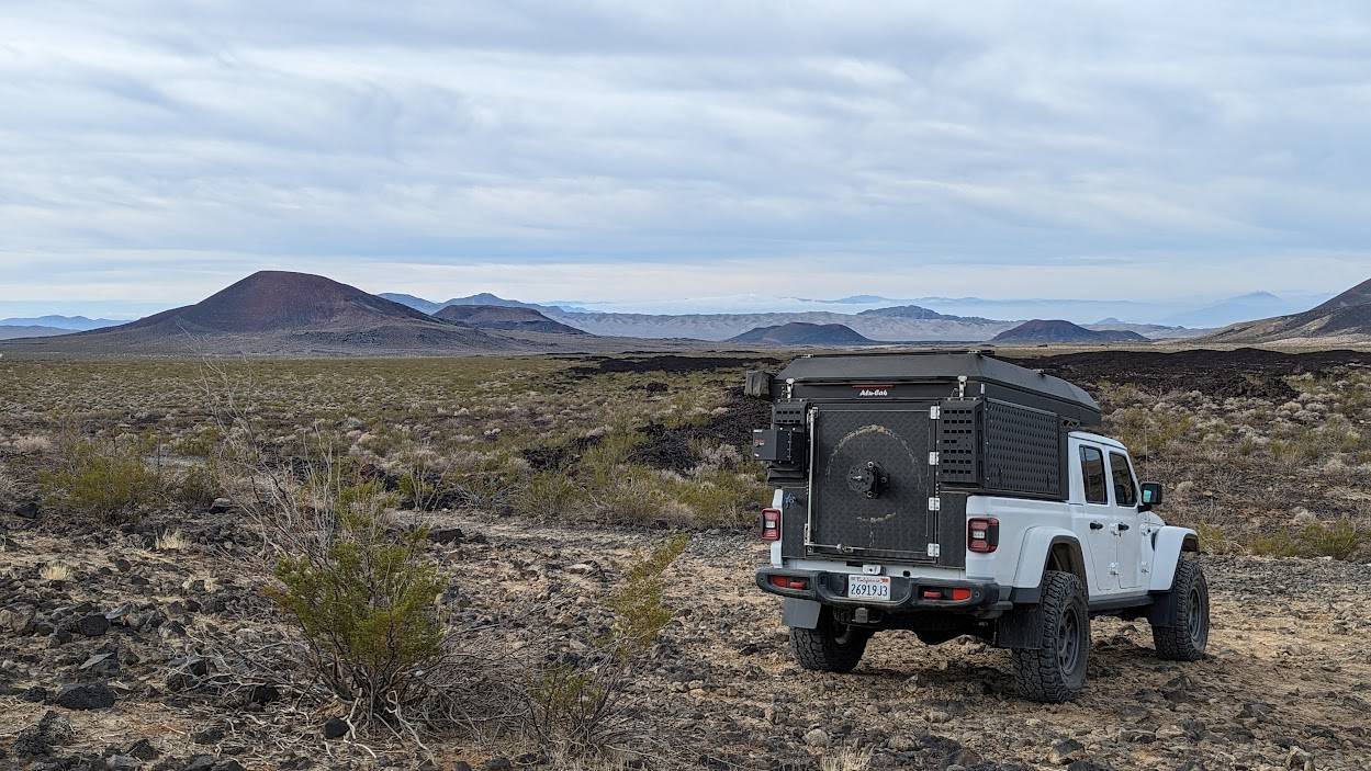

By the time we arrived at Balancing Rock it was pitch black. We quickly had dinner and settled in for the night. Upon waking up, we greeted by a fantastic sunrise.

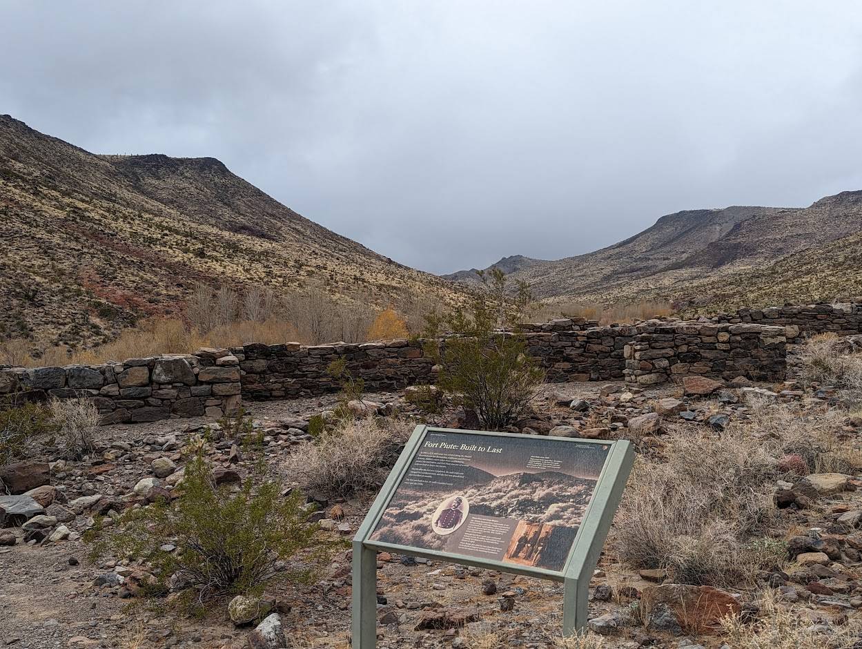

The first stop of the day was Fort Piute.
Jeep Gladiator Fungshui's Overland Build PXL_20221230_175538591.PORTRAIT

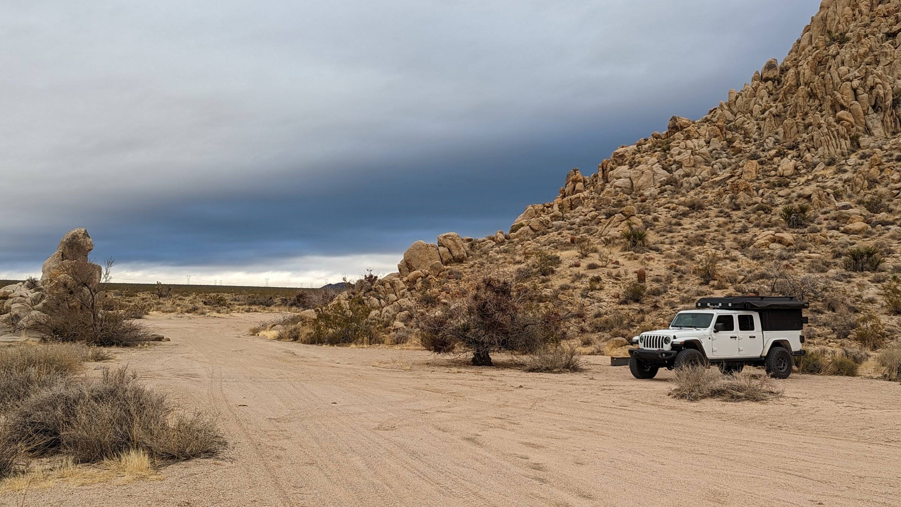

Mojave Camp
Jeep Gladiator Fungshui's Overland Build PXL_20221230_223252950.PORTRAIT
We ended up staying at Marl Springs and had enough time to enjoy the amazing red sunset as we ate dinner.

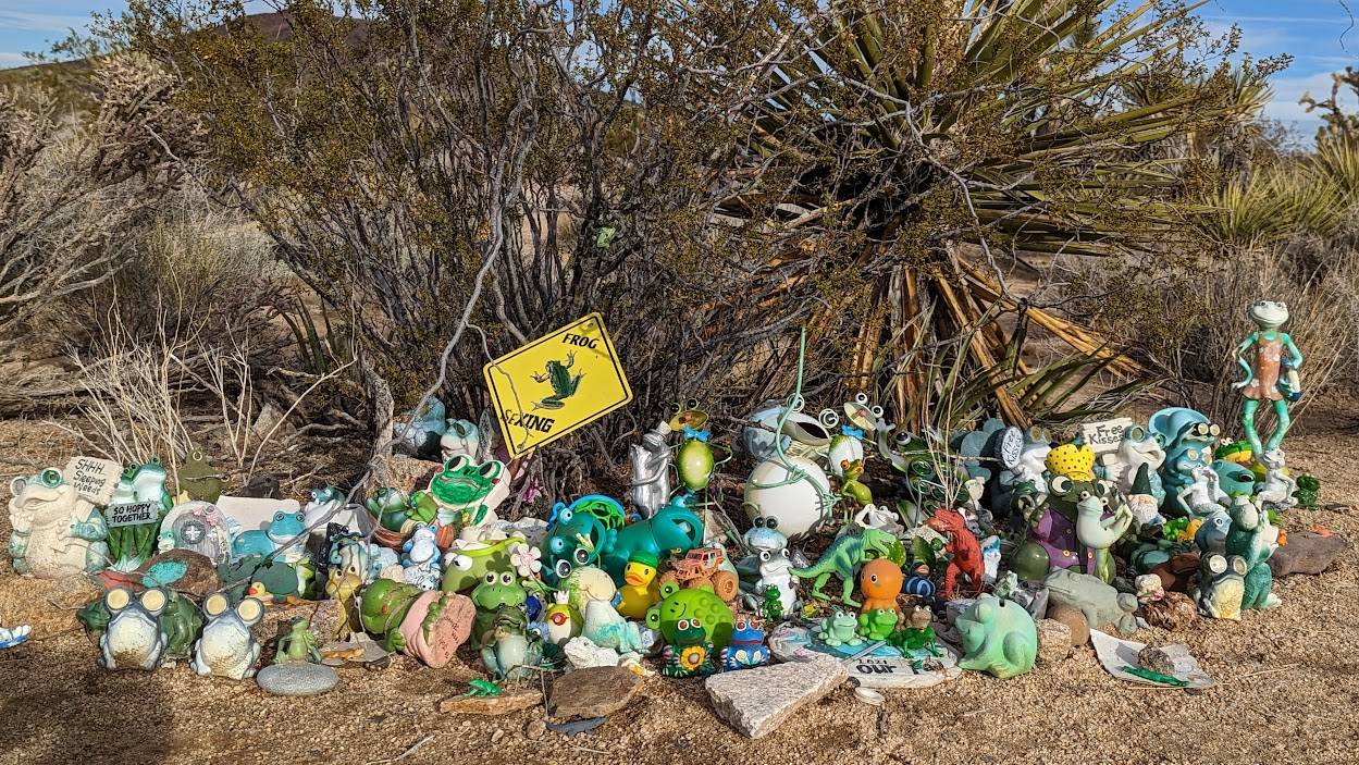

Frog Shrine
Jeep Gladiator Fungshui's Overland Build PXL_20221231_165845556.PORTRAIT

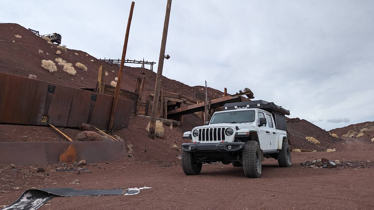

Aiken Mine Rd
Jeep Gladiator Fungshui's Overland Build PXL_20221231_183909683
Jeep Gladiator Fungshui's Overland Build PXL_20221231_184619334
Jeep Gladiator Fungshui's Overland Build PXL_20221231_185223254
Jeep Gladiator Fungshui's Overland Build PXL_20221231_185453556
Jeep Gladiator Fungshui's Overland Build PXL_20221231_185641983

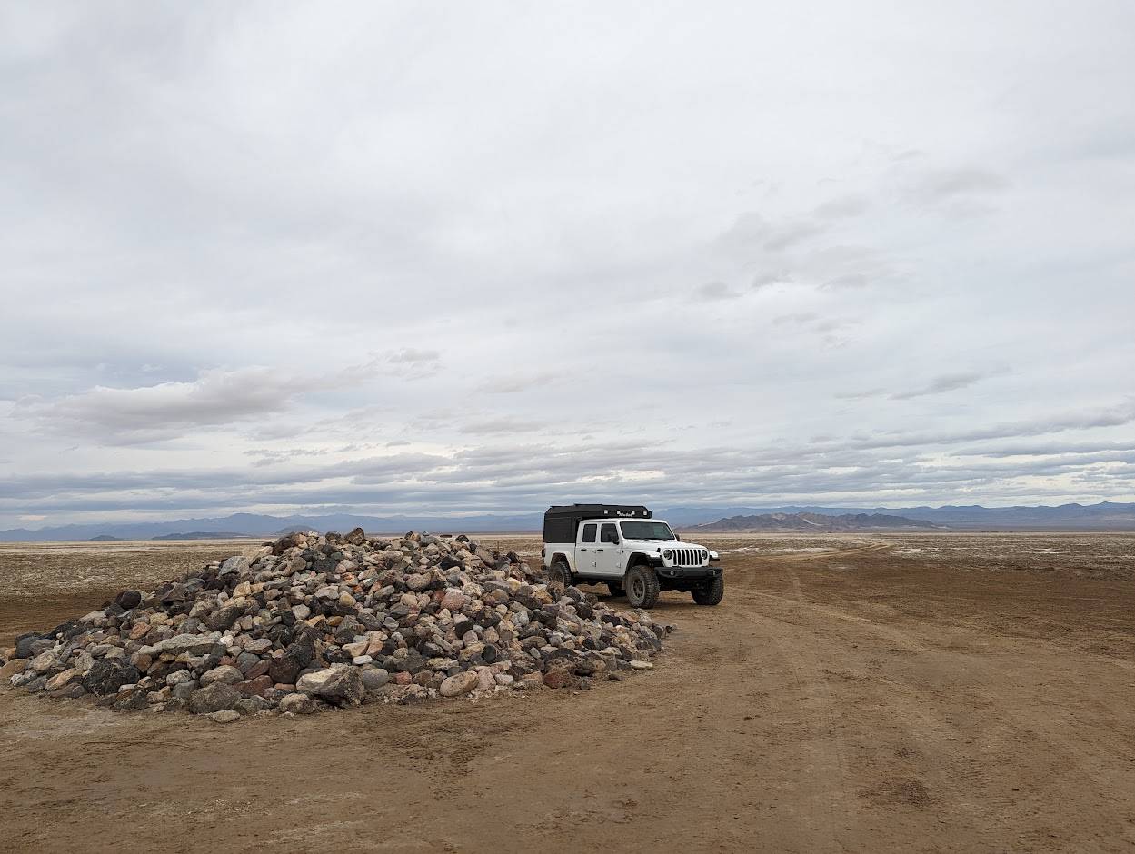

Travelers Monument- A little muddy but no big deal
Jeep Gladiator Fungshui's Overland Build PXL_20221231_202630255

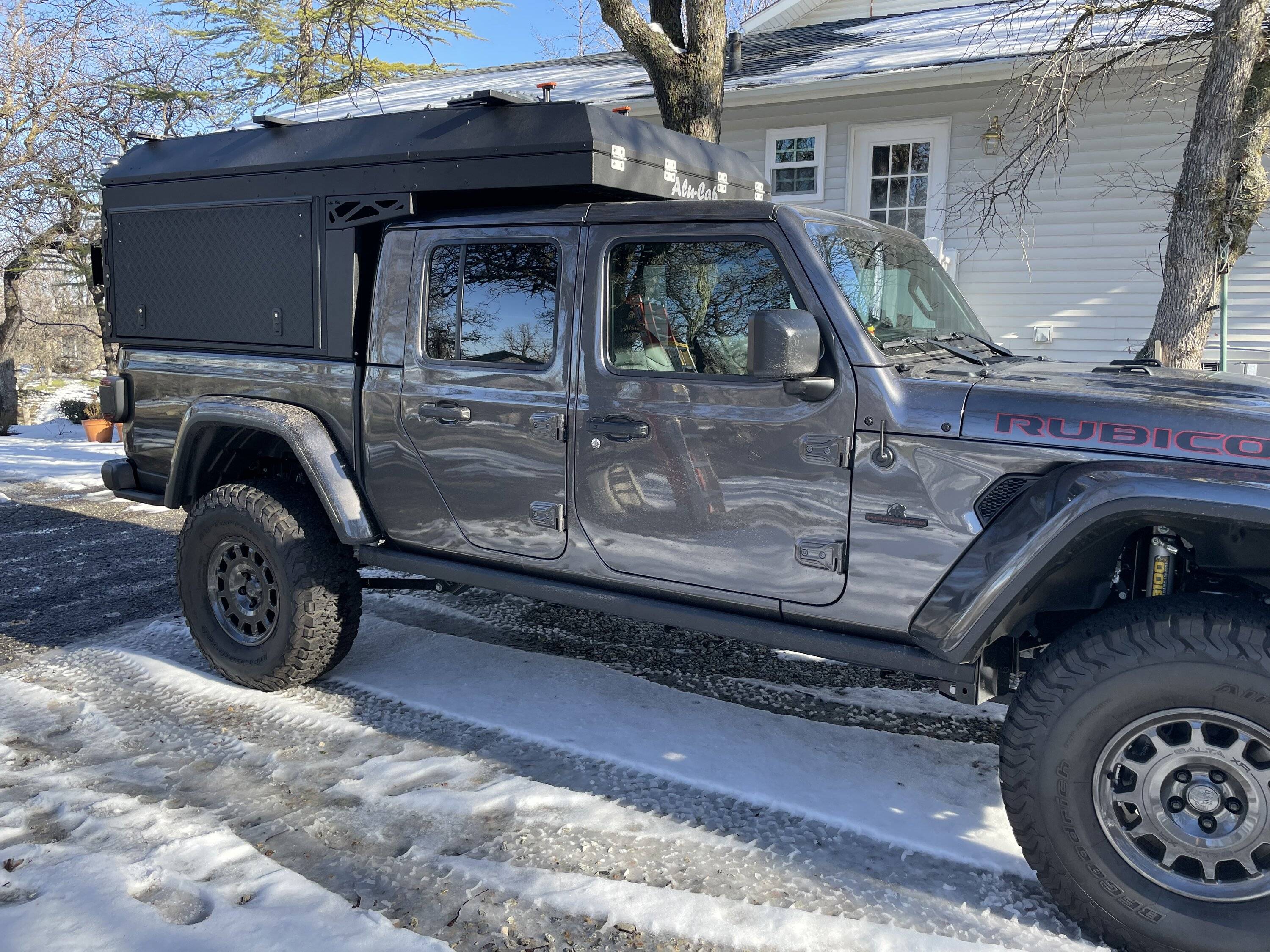

Very similar build. 2023 Diesel AEV 370 plus Alucabin with all the fixins. Almost done (for now:) ). Waiting for a couple more parts. Hopefully will start shakedown trips in a week or so.
I’m in SoCal. If all goes well it’s Washington State for some Dungeness Crabs and then on to Dawson and points beyond. Gonna be a fun summer!

How are you liking the AEV lift?
AustinKalb
Austin
Oct 17, 2022
108
103
Tehachapi, CA
2023 AEV Gladiator Rubicon
It’s our first Jeep in over 35 years. Little to compare it to.
It’s TALL. And we’re vertically challenged. It drives great sans a little steering wander.
Off-road the Gladiator Rubicon AEV is way more capable than I am. That’s a good thing. I’ll have fun catching up.
