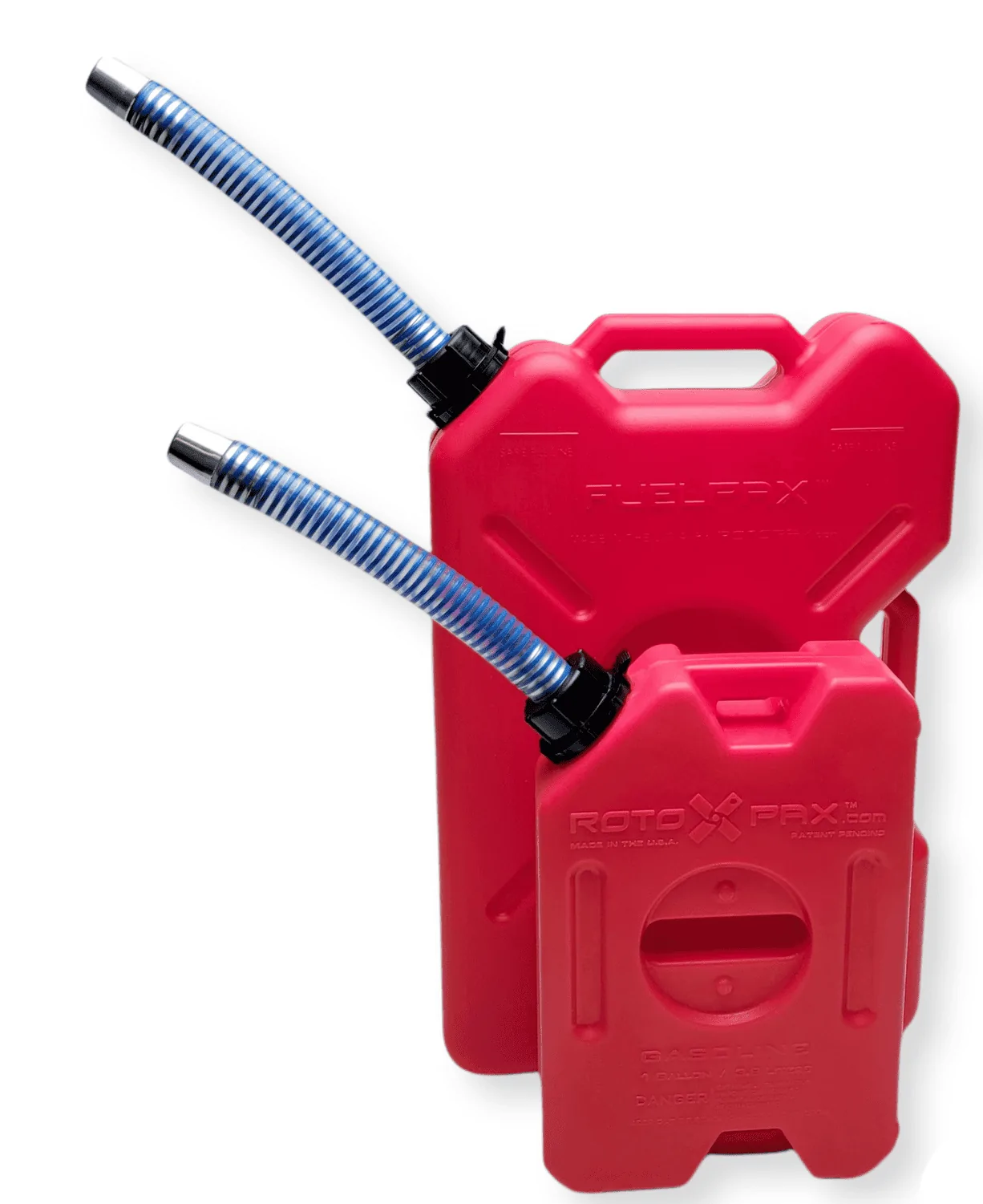

I keep gas in Rotopax in the bed, occasionally on top of vehicle. They need to be burped with change of temperature or elevation.
Scepter for my water, rear seat is removed so I keep these in the cab. If a Scepter is half full I'll strap it in the bed and just keep the full ones in the cab.
Both Rotopax and Scepter I'm happy with. I think the Rotopax seals a little better. There are all kinds of cool shit people have made for Scepter cans. Pumps, straps to pour easy, pressure for a shower, all kinds of mounts.
I do exactly the opposite of the post above, I leave a big air space in my Rotopax gas cans, I never fill them full, it gives a cushion of air to expand and contract. I do burp them regularly also.
