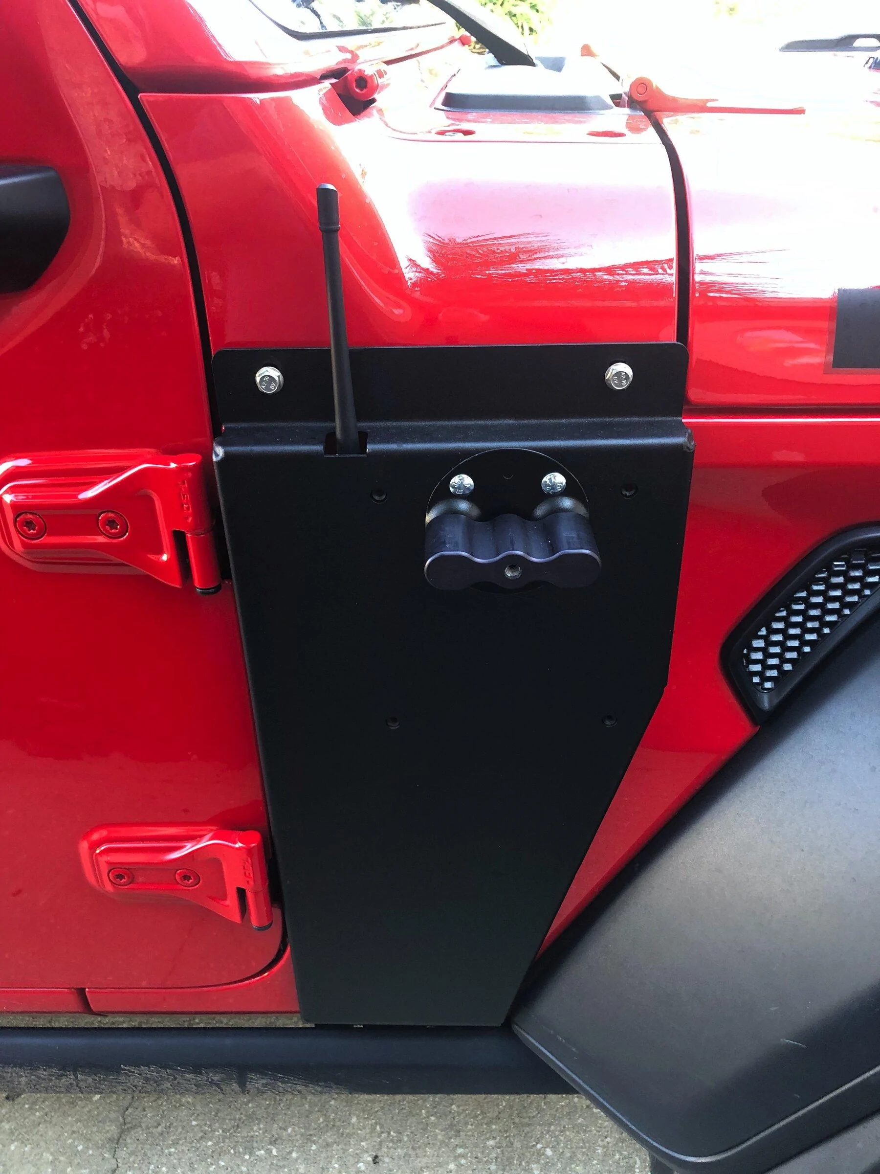

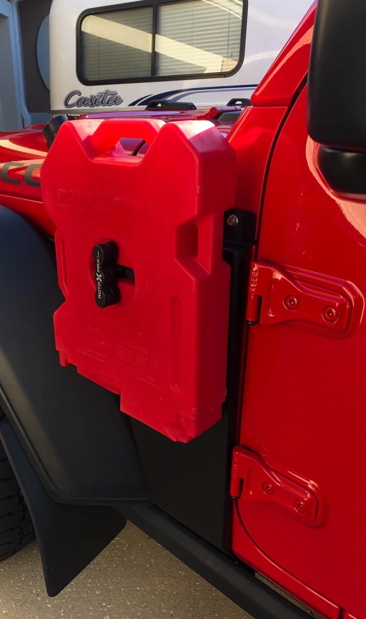

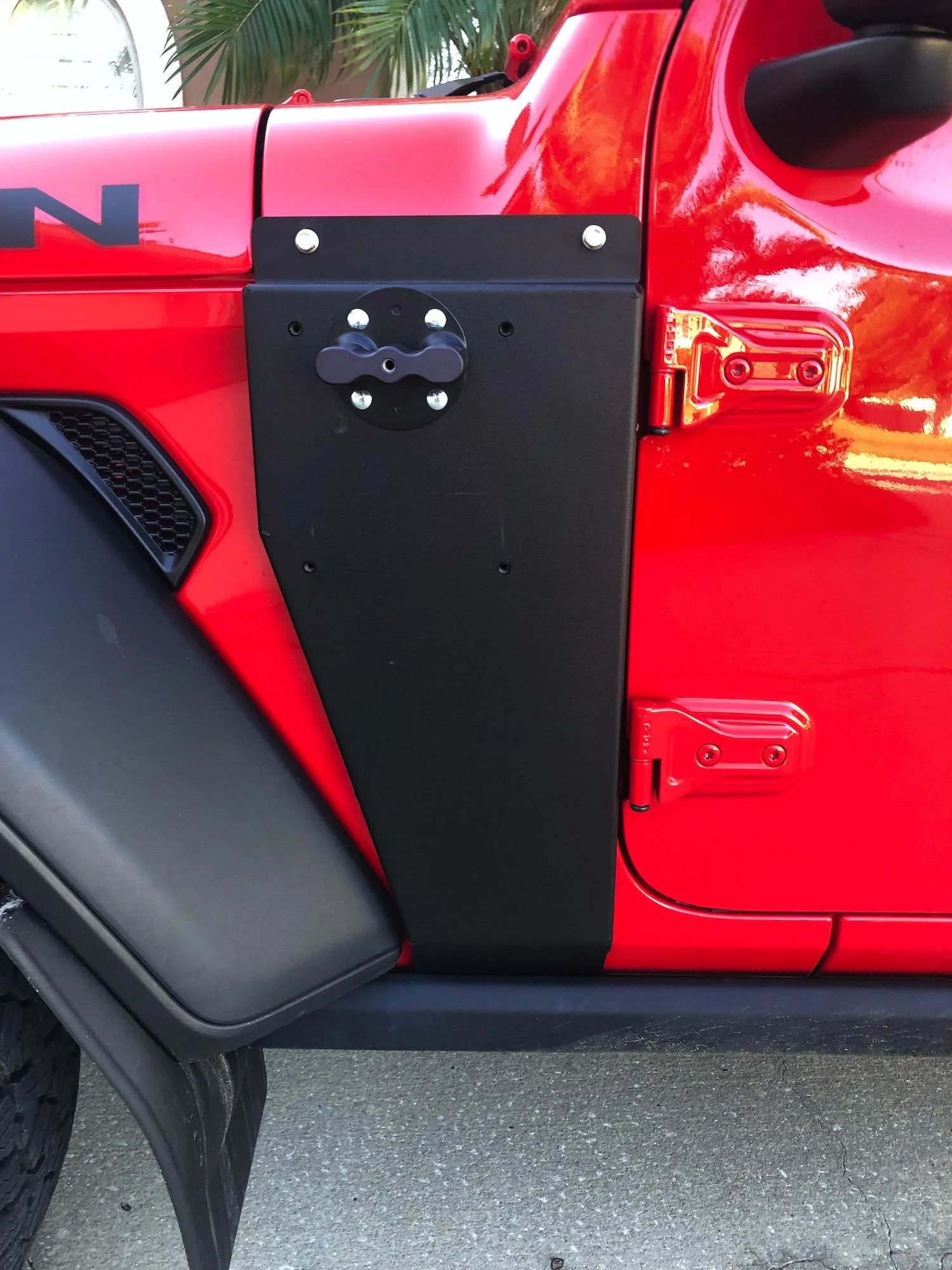

Here is how I carry my rotopax gas cans (I hate rotopax!!!), they will also carry jerry cans...
The mounts are made by MORryder and OK4WD can get them, ask for Stephanie (she got them for me)...

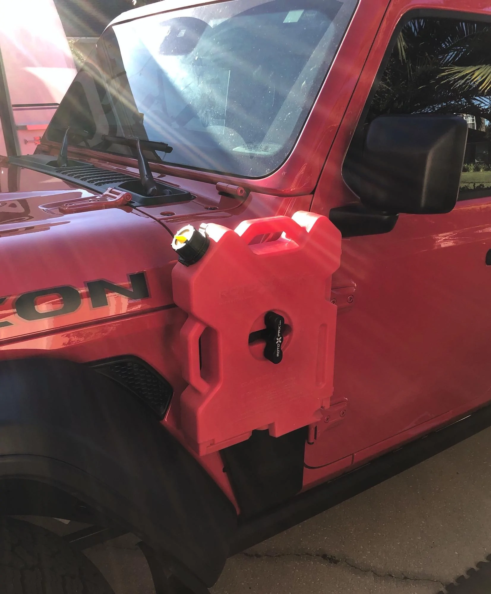

I like rotodrip ?... In stock configuration the nozzles leak like a sieve. The Ai13 nozzles are rock solid and do not leak, but damn they are expensive. $25 for the pax nozzle, $10 for the spout adapter, and $5 for the cap. So $40 for the nozzles/can and the vents come out to about $4/can. So it takes another $44 to make the rotodrip do what it should have done from the factory.
Plus to reiterate, their customer service is HORRIBLE!!!
But... ...By and far the cleanest install on my jeep ?

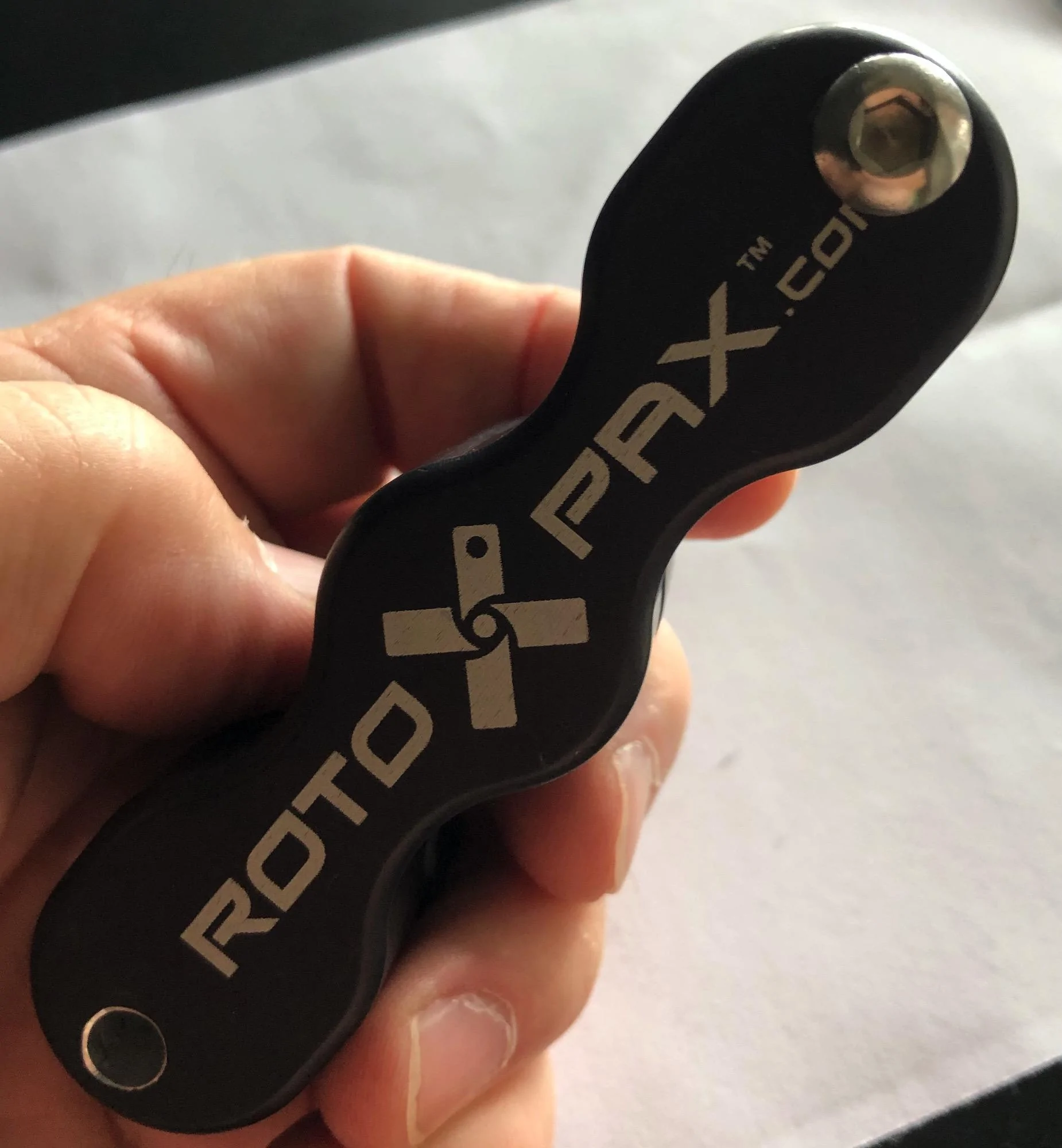

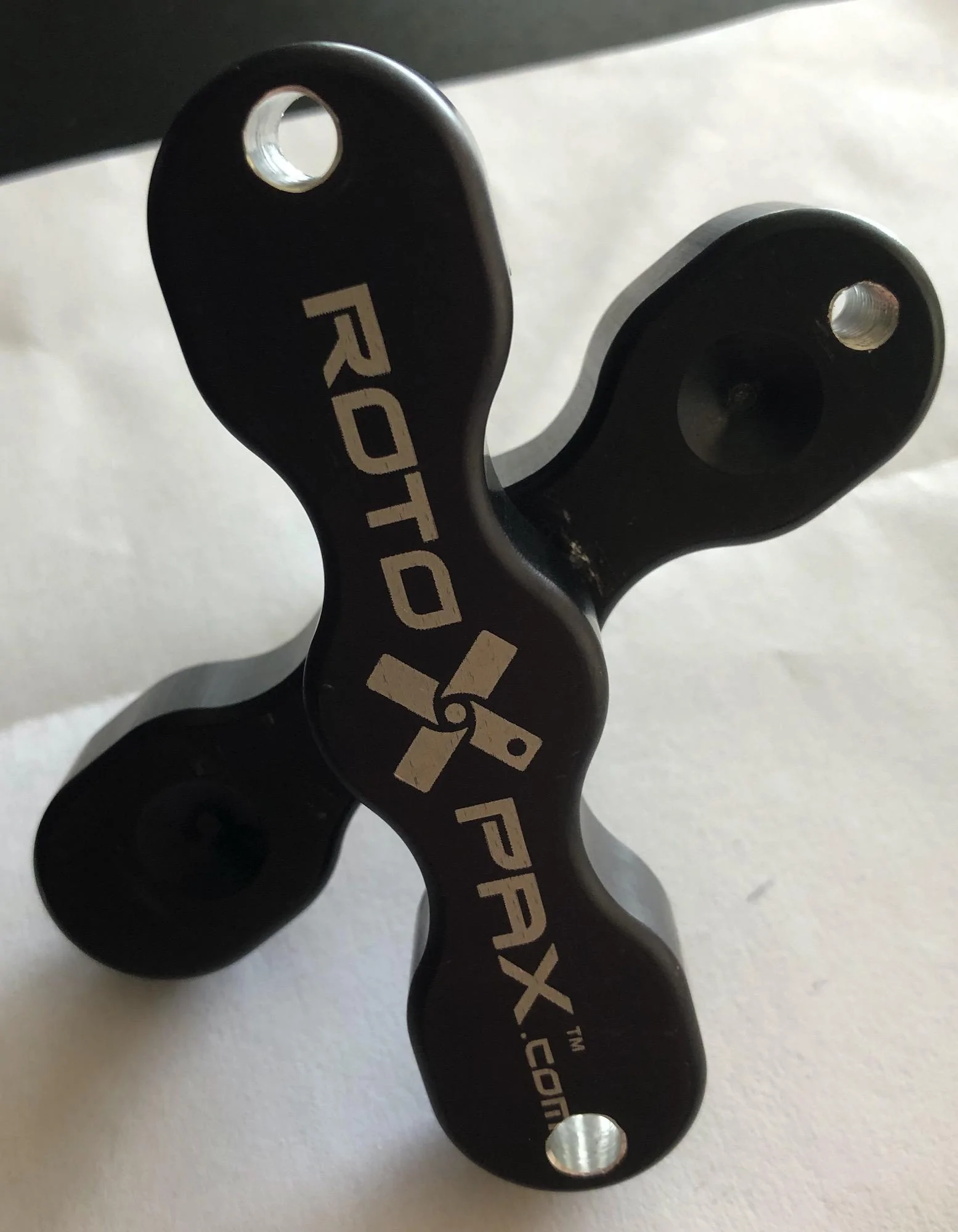

Since the locking handle routinely fails, search youtube for the wonderful videos of guys trying to access their gas in the boonies. This is how I modified my deluxe handle. It keeps honest folks honest and will deter some morons. At least it will take a metric hex wrench to get the button head fastener out, and it would be tough with pliers. I drilled and tapped one hole with 6mm x 1.0 threads and use an M6 x 30 button head stainless steel fastener. I drilled both wings (.250 drill) so I wouldn't have to over tighten or loosen the handle.
