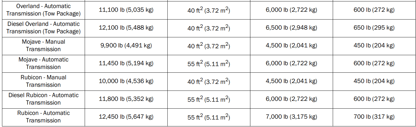

Did you ever stop to wonder why the Rubicon has 7,000 pound towing and the Mojave only 6,000 pounds?
It's sure not springs.
You are just plain being dangerous to yourself and everyone else out there if you truly believe what you say.
Not my truck but others out there will see that bunk and believe they can do it and do it safely.
Everyone here has agreed - these trucks just can't do it safely. We've talked about this here for years. Even braking is impacted. Larger tires reduce braking capacity. That much tongue weight ensures that you'll lose it in an emergency situation. It's over for the hitch and the truck.
UHAUL is a JOKE! You believe what their stuff says? LOL Get into an accident, get sued, and see how UHAUL helps you out.
You take the uhaul "calculator" over the door stickers and book that Jeep puts out, and the experiences of dozens of people here?

ok what is the difference between the Rubi and the Mojave? Same axle, same arms, same trans, same motor, same brakes, same hitch, same tires. The only thing different part number wise is the coils and shocks. And what about it is unsafe. Under 60, far right lane, giving myself all the space. If you’re too scared to tow that’s fine. And as far as liability, that shit flys out the window as soon as you mod your truck. LED bulbs, not DOT, aftermarket wheels, the list goes on. You can be thrown the legal book for anything man. That’s why we have lawyers. Just cus you did it doesn’t mean you’re guilty. All I’ve done is proved these trucks can go above and beyond in a pinch. And you’re mad. You gonna be mad when someone runs no oem arms and coils for crazy rock crawling but still highways? You’re picking and choosing here. There’s rules even you don’t follow, but I’m the only idiot. Yeah ok sure buddy.

Different shocks, springs, front locker, disconnect motor, hood.
Same one.
so that would imply the important ones like the spring and sway bar would be the only defining difference in the 1k jump of towing capacity between the two. I got the spring covered and drove slower. Thats minimizing risk in my book. And i understand if thats not adquate to others. But what else u gonna do? No tow truck avaible, no uhaul truck avaible and a stranded buddy. Ill take what u haul got and make it work. Its not like im doing this regularly. It happened one time. the only regular is my 4k camper.
Center of gravity is one thing. (I've not compared weights on identically equipped M vs. R- but weight matters, too)
It's a huge player. Once a vehicle is taller, it loses stability towing.
