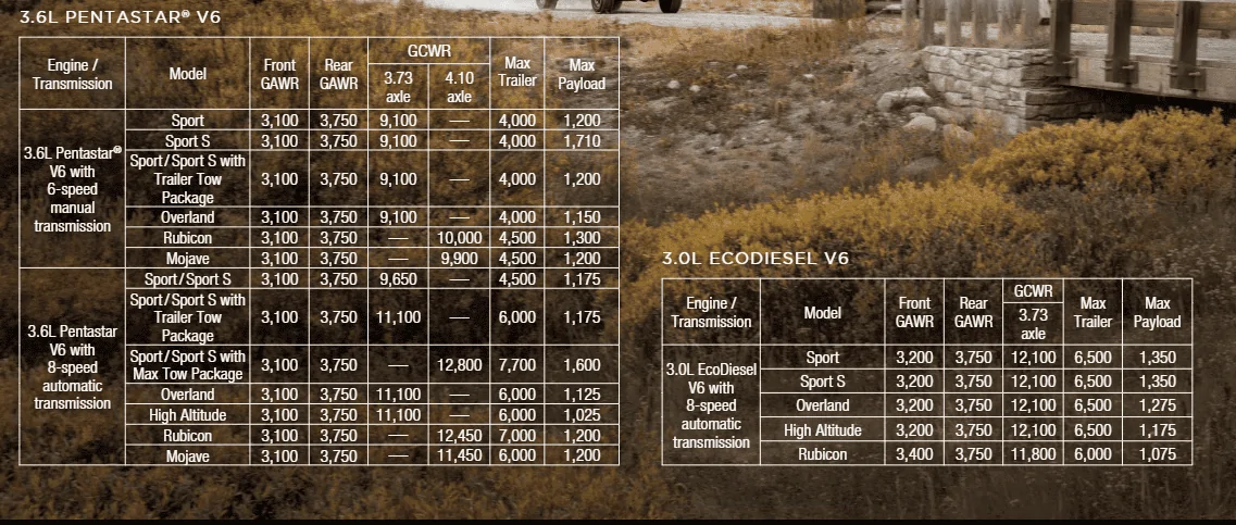

also where u getting 14k from? the truck barely weighs 6500 at most.
also "one emergency manuver away". Thats everyone on the road man.
Uhaul trailers are about 2,200 lbs, + you said the truck was about 6,500, so let's round down to 6,000 + weight of Mojave, which is about 4,900 lbs, so your GCWR is 14,700 with those numbers. It is way over the GCWR of any Gladiator or Mohave, regardless of the engine or package. You're just overloaded, plain and simple.

Doesn't look like there was some sway there...there was a lot of sway there!
He was one emergency maneuver away from having 14,000 lbs of scrap metal for his estate to dispose of.

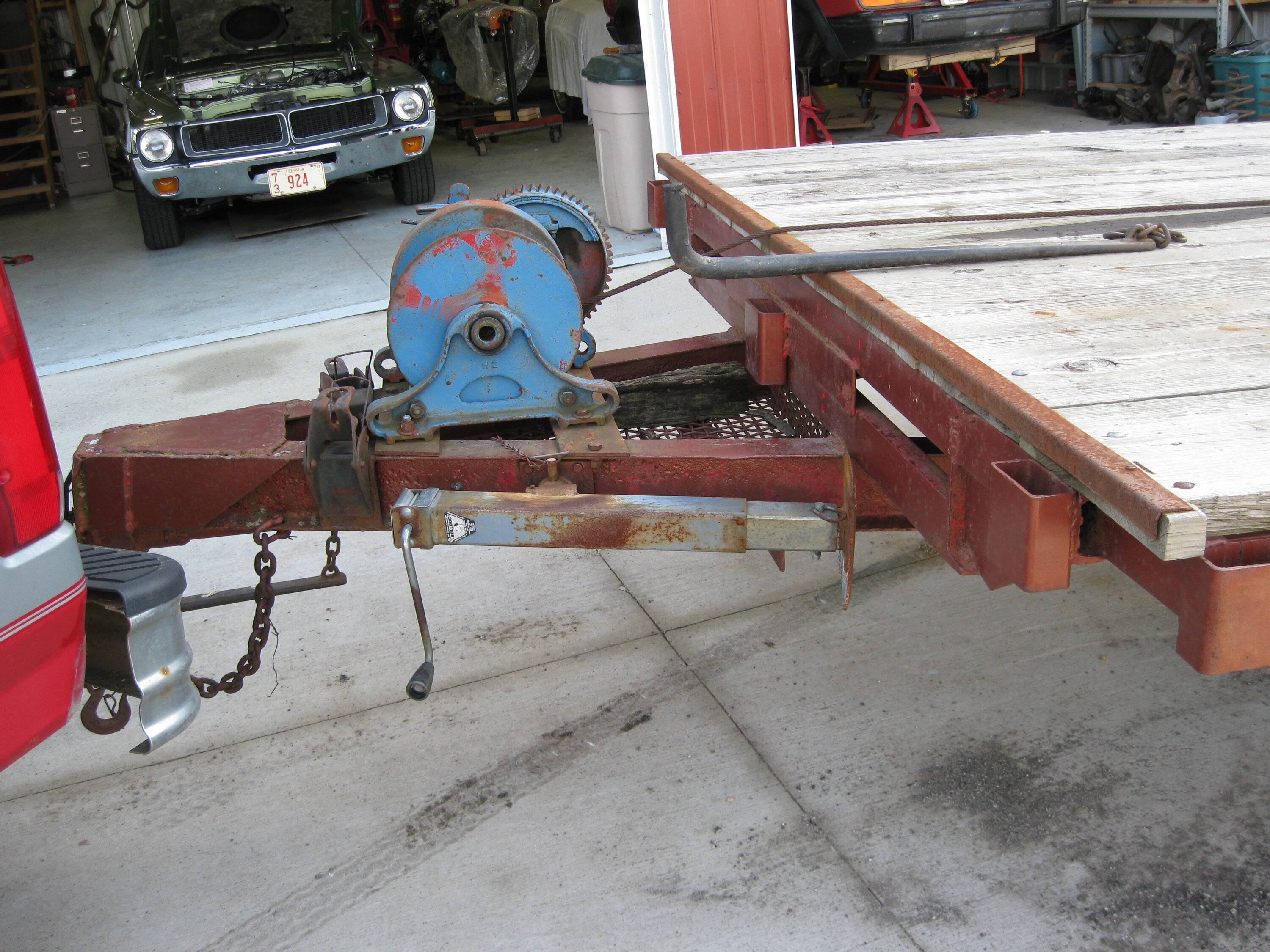

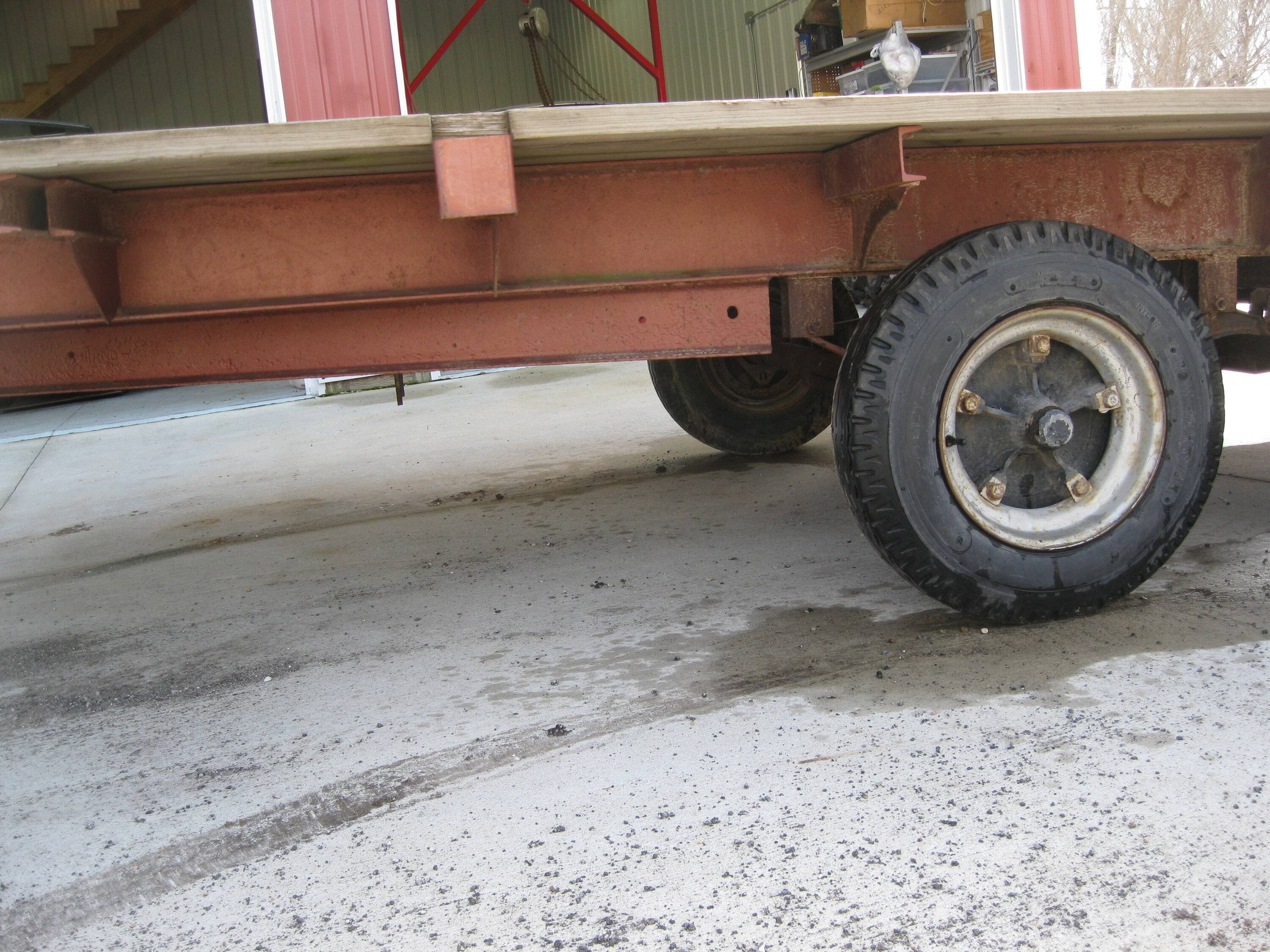

Try hauling the trailer below behind a F250 that got 12 mpg empty, loaded, head-wind, tail-wind, north or south. You were just happy to have dual tanks.
Jeep Gladiator Gas mileage is concerning.. trailer 005
Jeep Gladiator Gas mileage is concerning.. trailer 004
