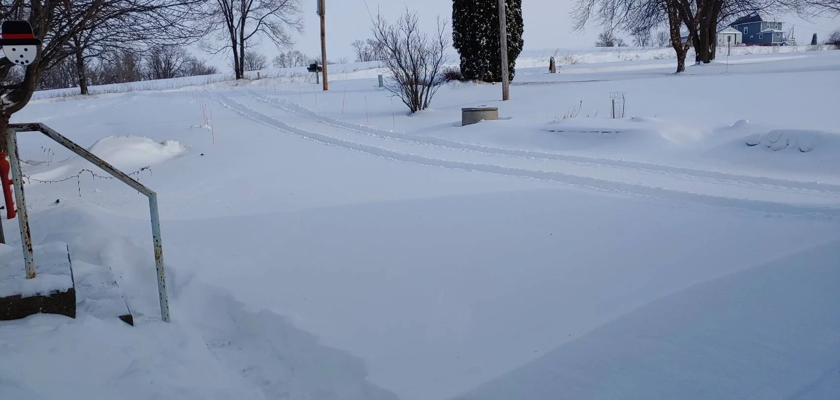

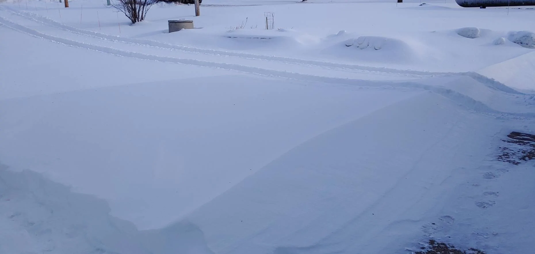

Beautiful pic.
That's after a big snow and blow, and the tracks are my JT going up the drive to the road.
I love the look of a snow like this.
Jeeps walk right through it.
That's another thing that kills mpg - the resistance of the snow to your rolling tires.
Oh, well.
