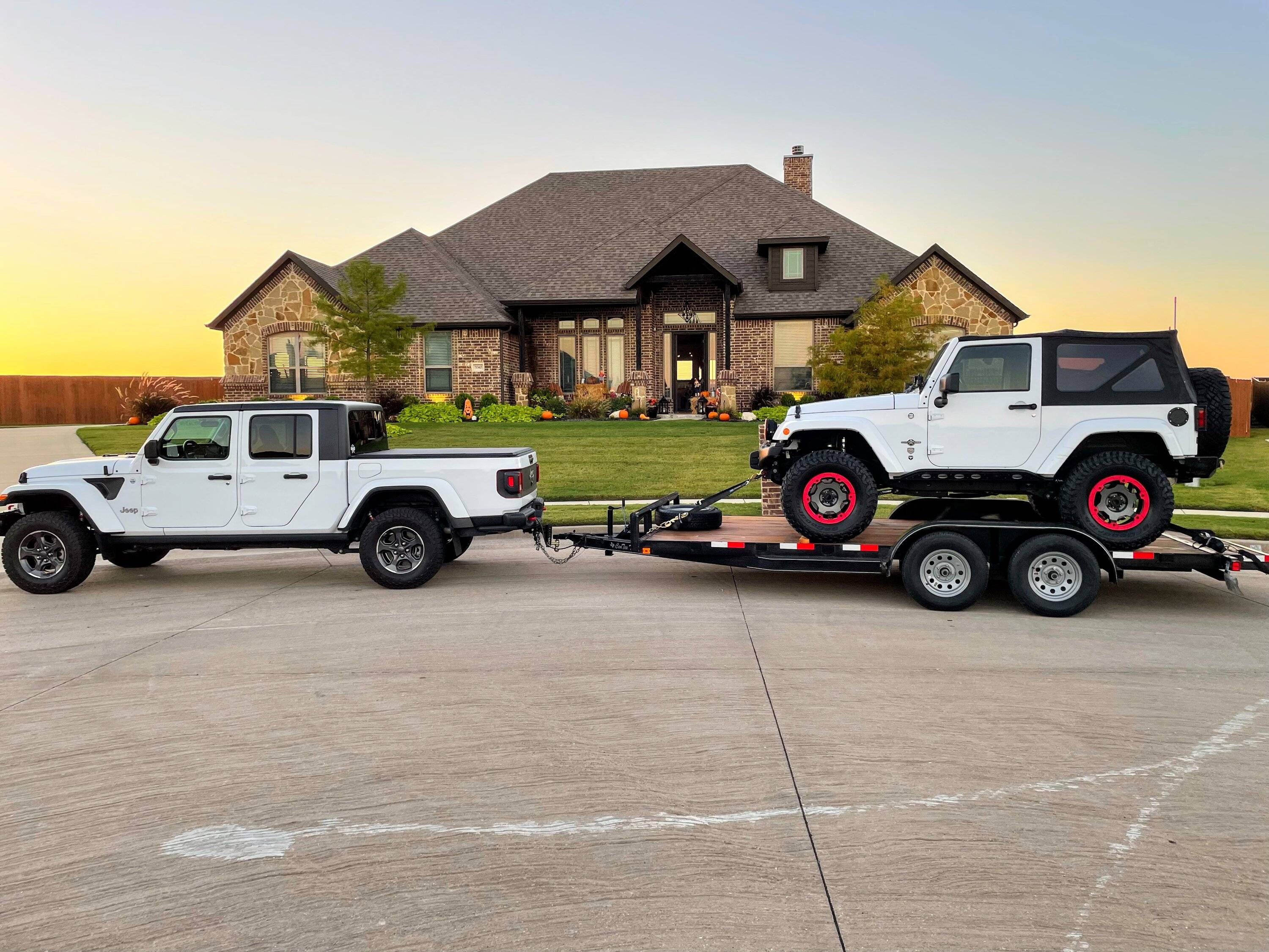

Jaun, here is my setup! It's about 6600 LBS and we tow all over the country with no problems at all.
1) Gears 4:56. It will run you about $1600 to $2000. World of difference, no trying to find a gear all the time. Goes to 7th or 8th and holds there. I do run 35", but they are on the small side.
2) Air bags, I run the firestone with 38-40 PSI. They are going for around $130. E-trailers is a great go to and has good video. Also, there are number great threads here.
3) Redarc brake controller. Cost around $220-$240. Its amazing, the Jeep stops perfect with the trailer on the back. Love it!
4) Making sure you trailer is balanced with the proper tongue weight. I have mine at 700 LBS. (10% of total) and there is no sway at all. Take your time to get this correct.
5) Making sure you trailer is level. Having the right drop hitch is key here. You want the jeep and the trailer nice and level.
Spending a little time setting up the Gladiator to tow is well worth it. We have 80K miles on ours and it only 2 years old. We head to Co, Wy, Ut, Ca, Az, Mo, Nv all the time and do about 30 classes a year.
Good luck...
