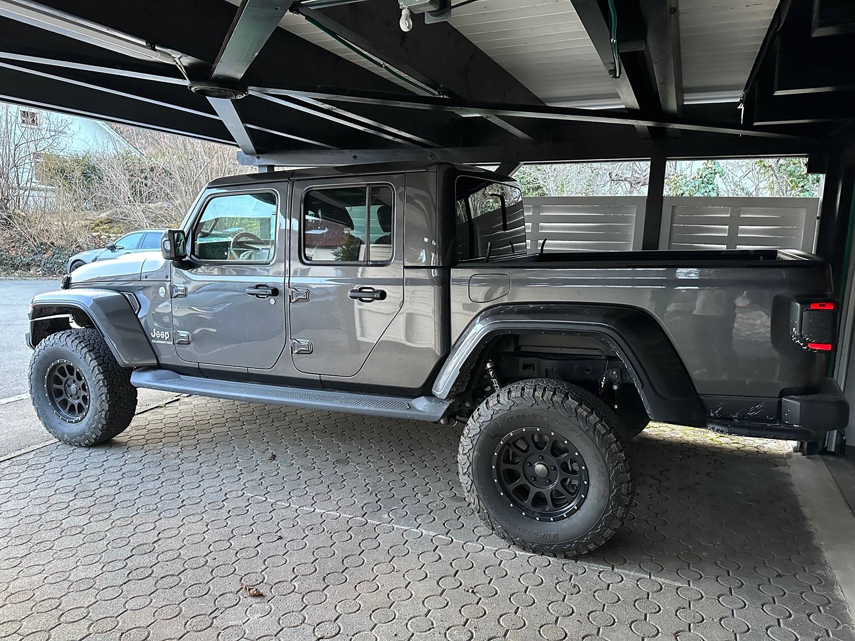

Did some things on the weekend.
installed the AEV3 inch springs, only rear, as I did not want to align front wheels (it’s not so easy first to get an appointment and 2nd to find a garage being familiar with track bars and solid axles..)
Mai this resulted in quite some rake, as the rear came up 4cm (1,5inch) as it’s unloaded and the springs are rated for 600lbs constant load.

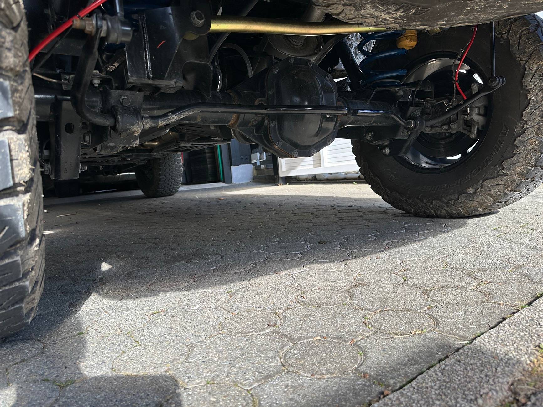

Then installed the Metalcloak rear adjustable track bar and mostly centered axle (it’s partly guessing how much you need when tires are in air vs on ground) as you know by lowering the jack it moves to driverside.

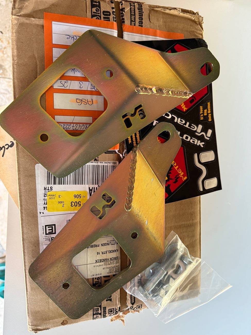

and then, as 2nd box from Metalcloak with rear sway bar reinforcement plates did not show up, we added the chargebooster and installed 2nd battery temporary.

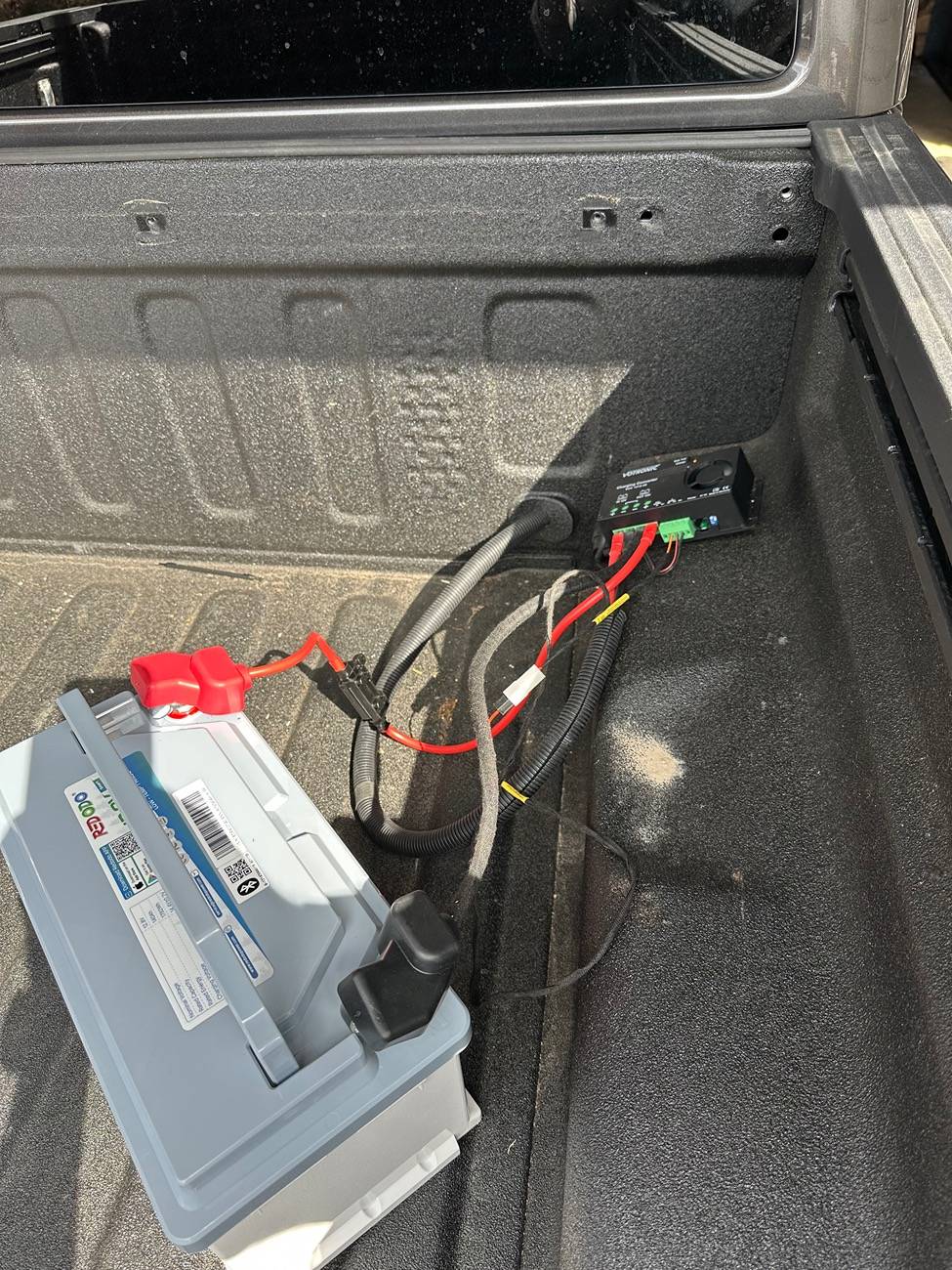

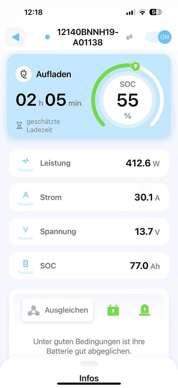

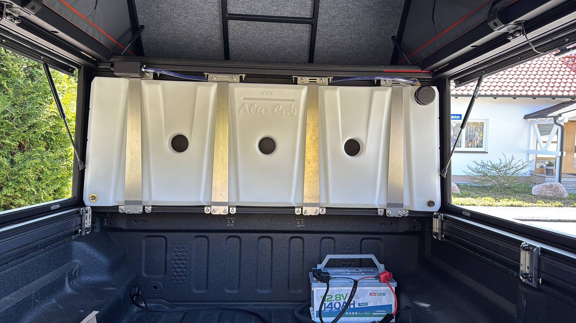

it’s 140 Ah lithium battery and a 30 amps charger.
The battery can be monitored through an app, so I do not need any monitors or stuff…
we will connect a fuse block to battery to splice up the ModCap cables as well as install 12v connection for fridge.
So far, so good

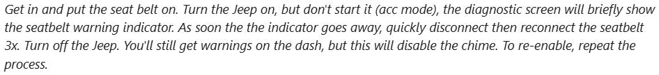

tried to make the door chime when door open go away, did not find it.
tried to kill chime findest belt warning disappear, did not work.
So, not sure what I did wrong, but…. Let’s see again.

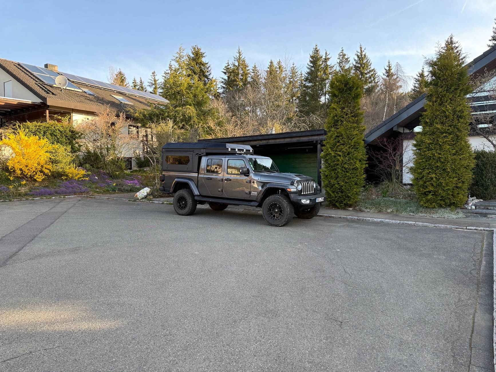

That looks good with some rake.
Carport has a pretty low ceiling...May limit any further lifting ;-)

We have to increase it by 8 inches so that mod cap fits :)
but it’s already not low for German proportions.
Same the garages, usually drive in height is 2.10m -> 82.6 inches…
Ours is even lower at 2 m height….

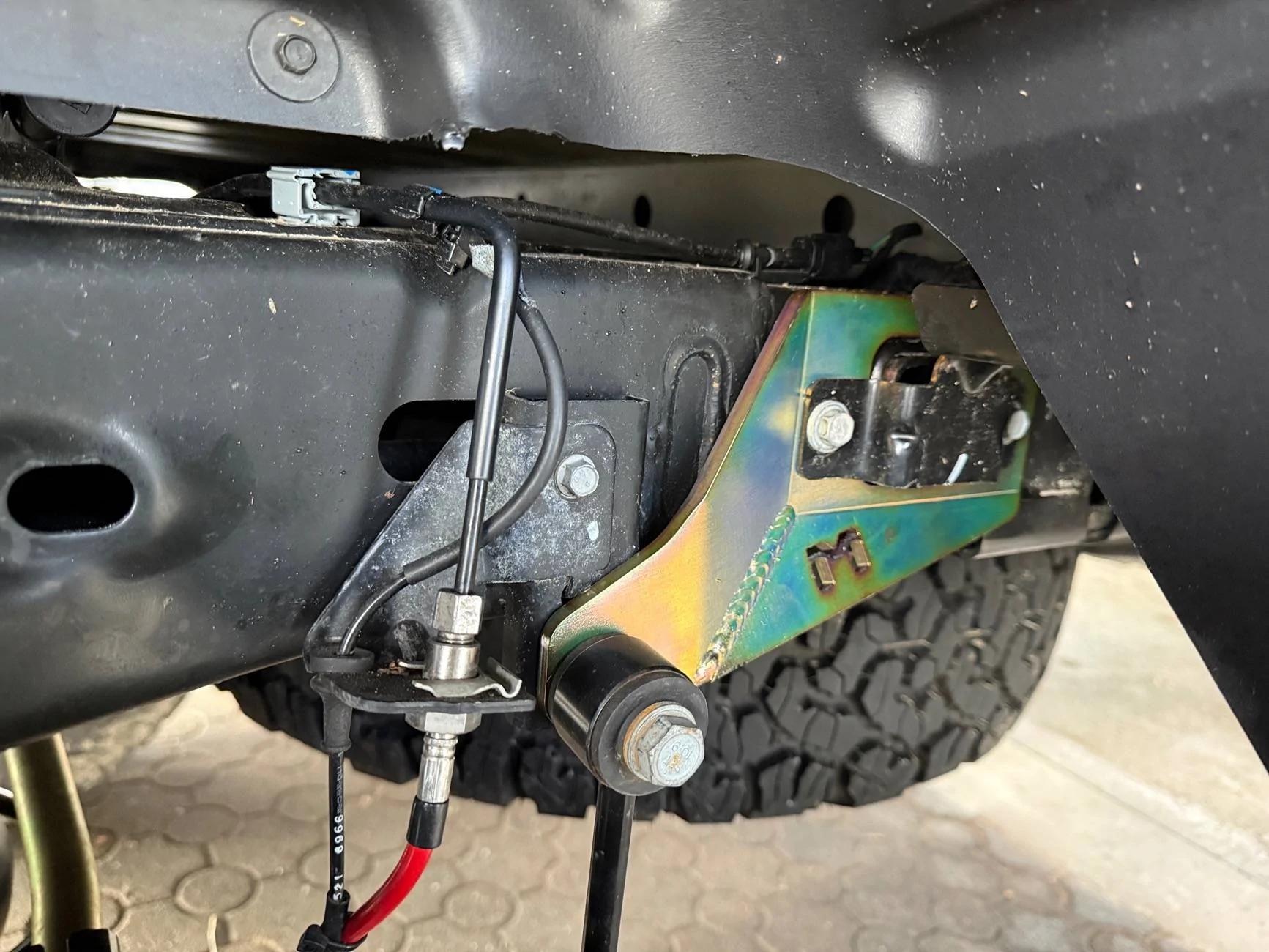

Yeah! Finally received the rear sway bar reinforcement plates from Metalcloaky
Really nice product, install was 25
Minutes,

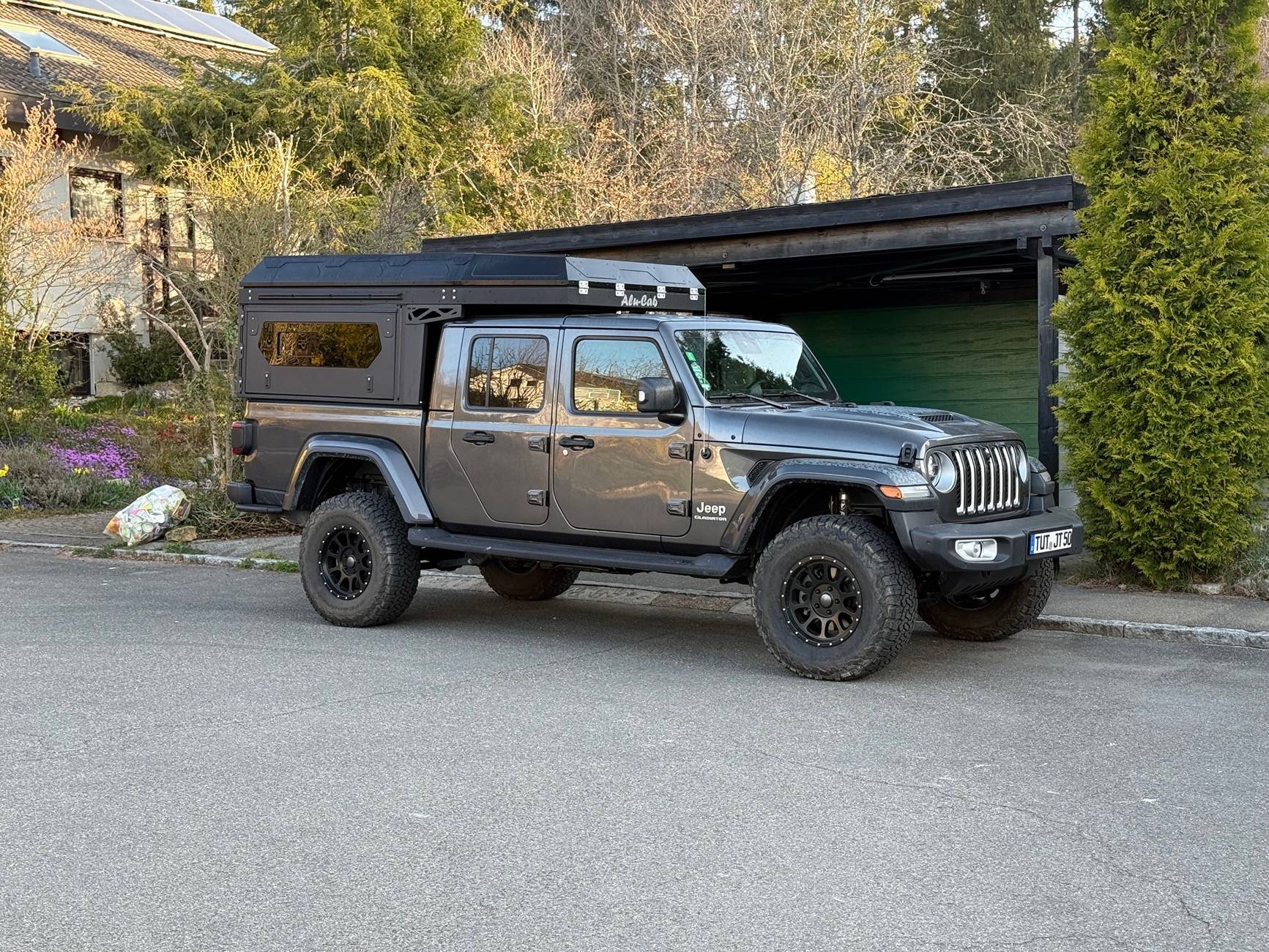

Good Morning into new week!
Friday was the day, finally we could pickup the Gladiator with the ModCap installed.
great!!

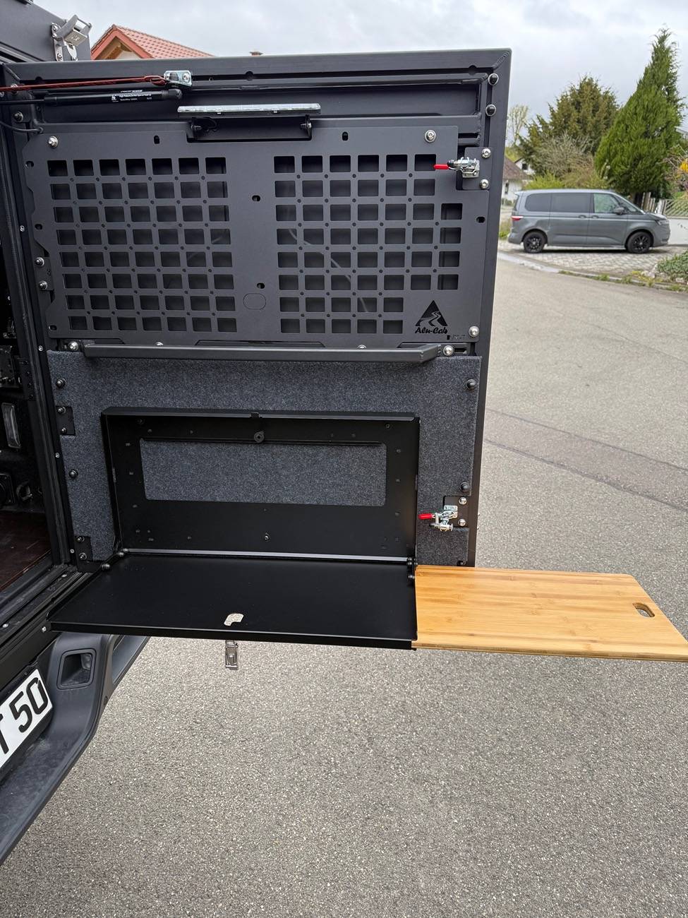

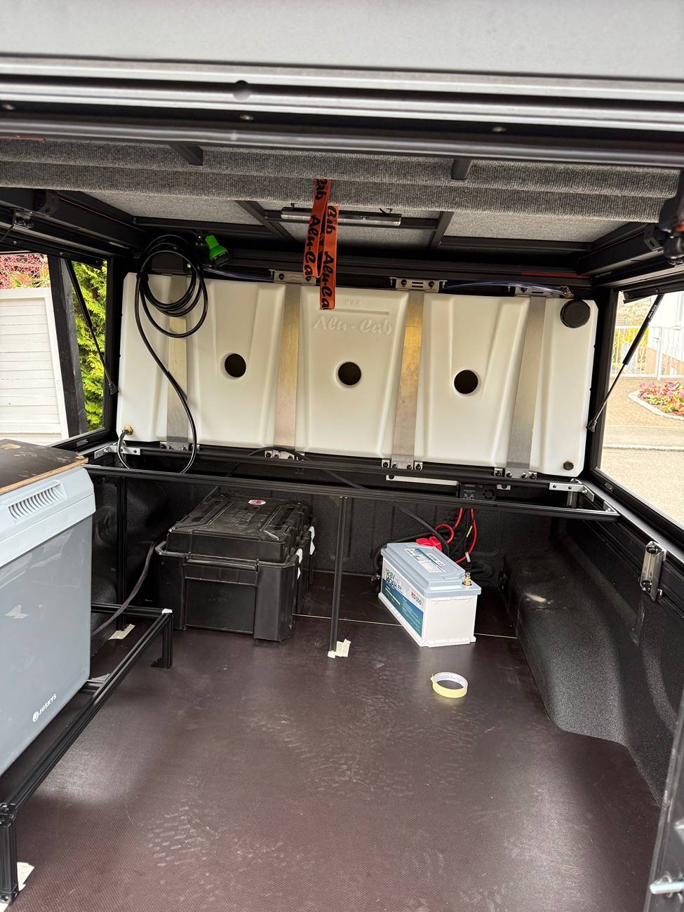

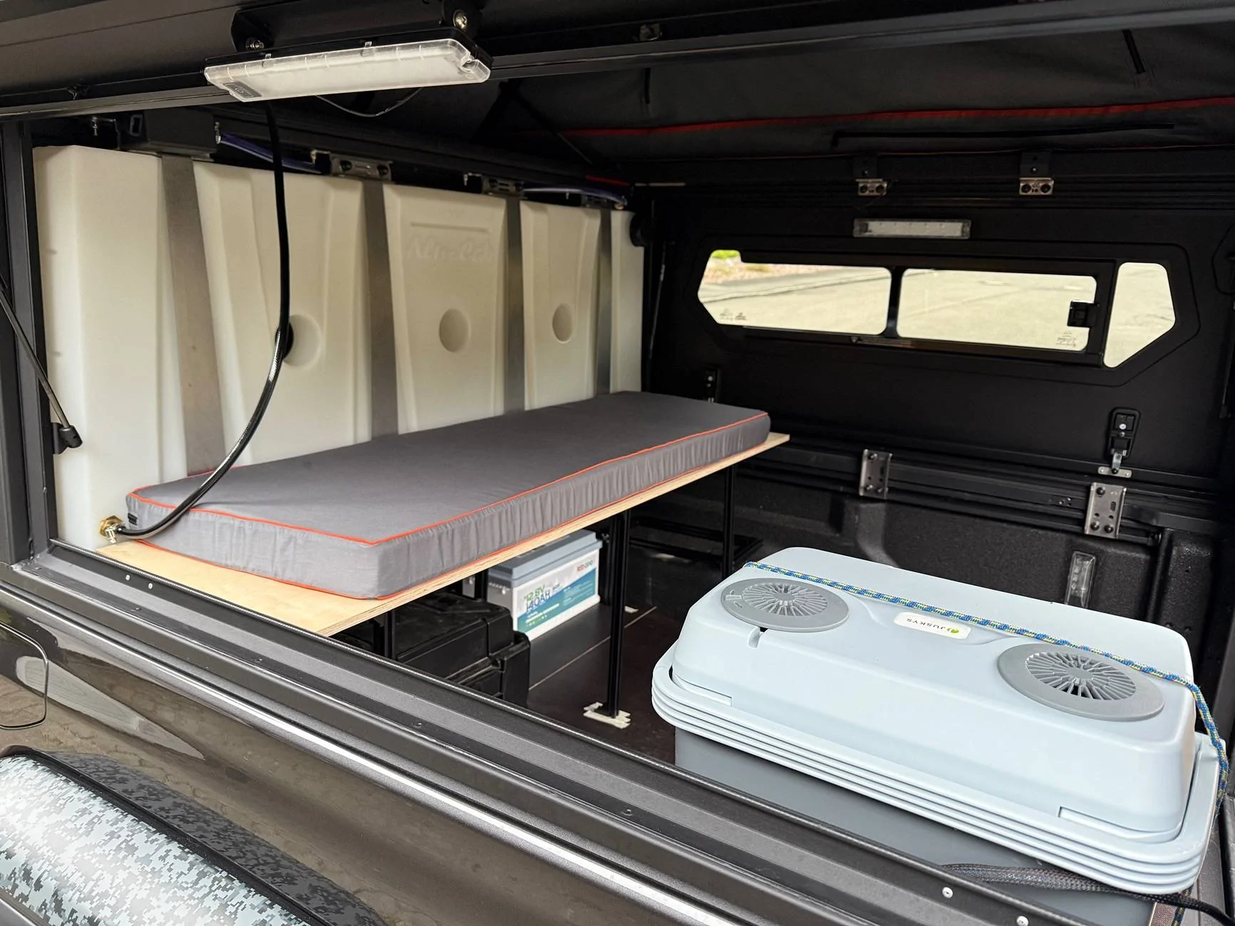

Friday evening we installed the water tank and the lower filler panel from @813 Fabrication & Design, really great piece and if I would have read the instructions, Jeremy would not have to support… anyhows, he did, and it’s making the rear looking as it should have from Alu-Cab.
the rake is still there, the rear fender corner is 110cm or 43,3 inches above ground, the old 2,5 springs were at 108cm/42,5 inches with empty bed.
So AEV 3 springs do exactly what they should, just need to fit them in front, but after the trip next week, due to need of alignment otherwise.

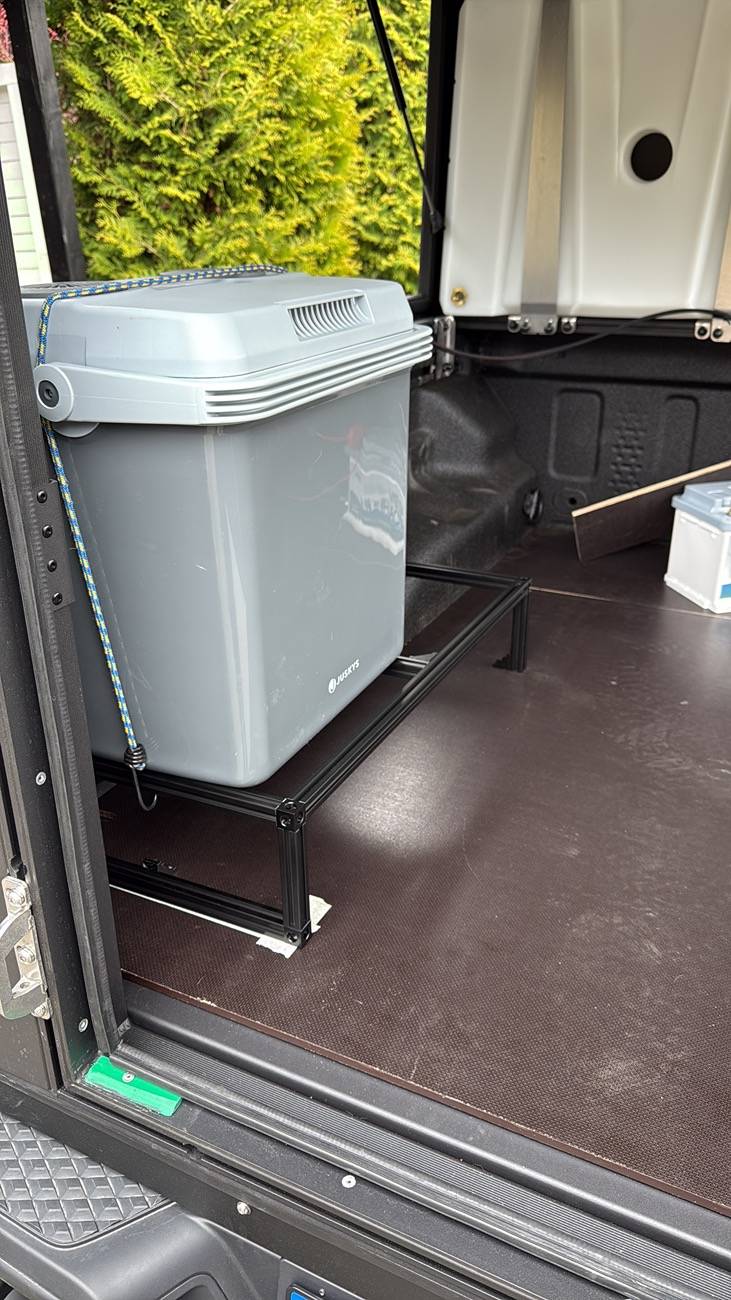

we started as well to fit stuff to the floor and connect 2nd battery.

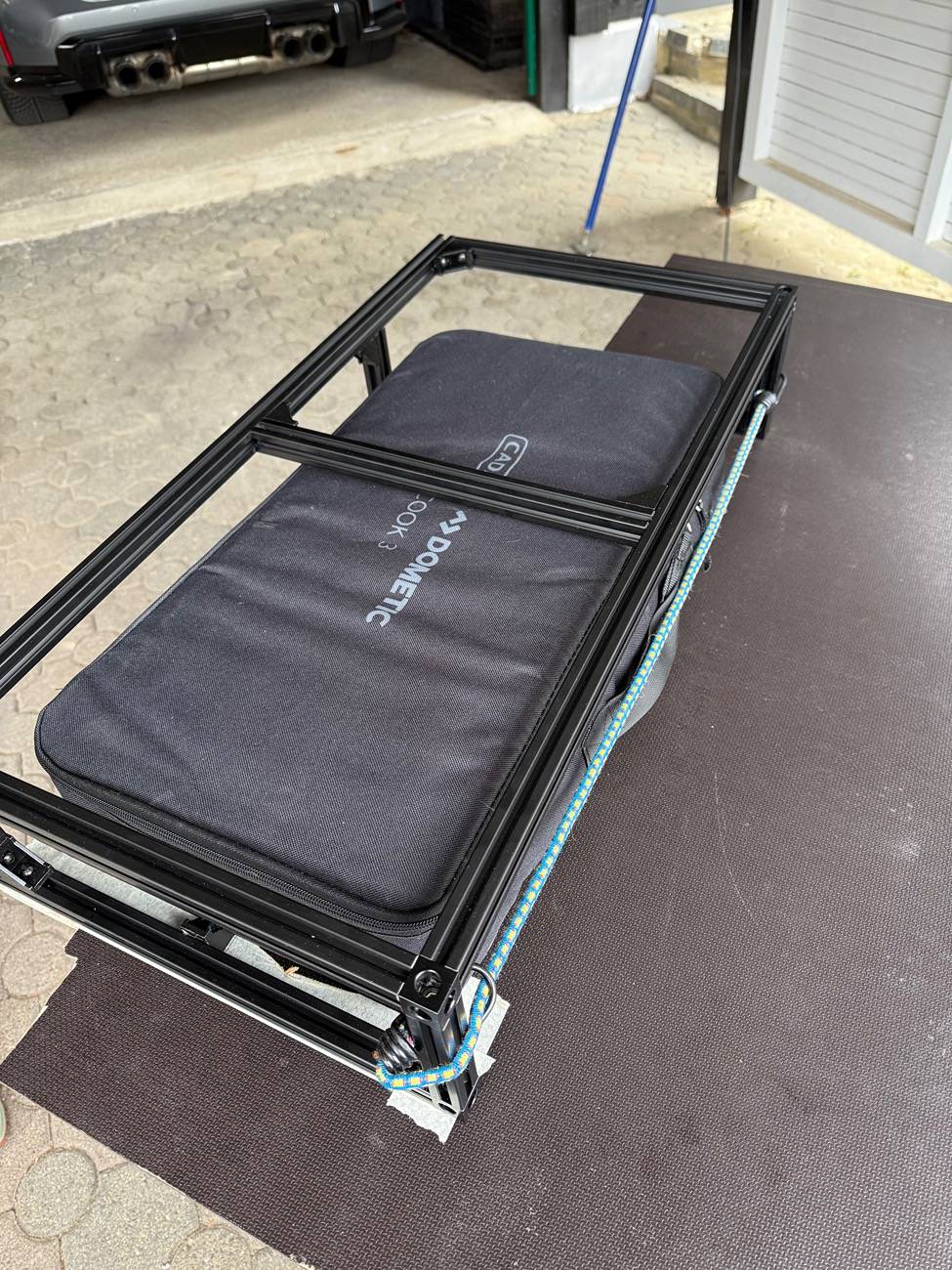

As I ordered 2 wrong profiles (wrong nut insert size) we could not finish the seat bank in front of water tank.

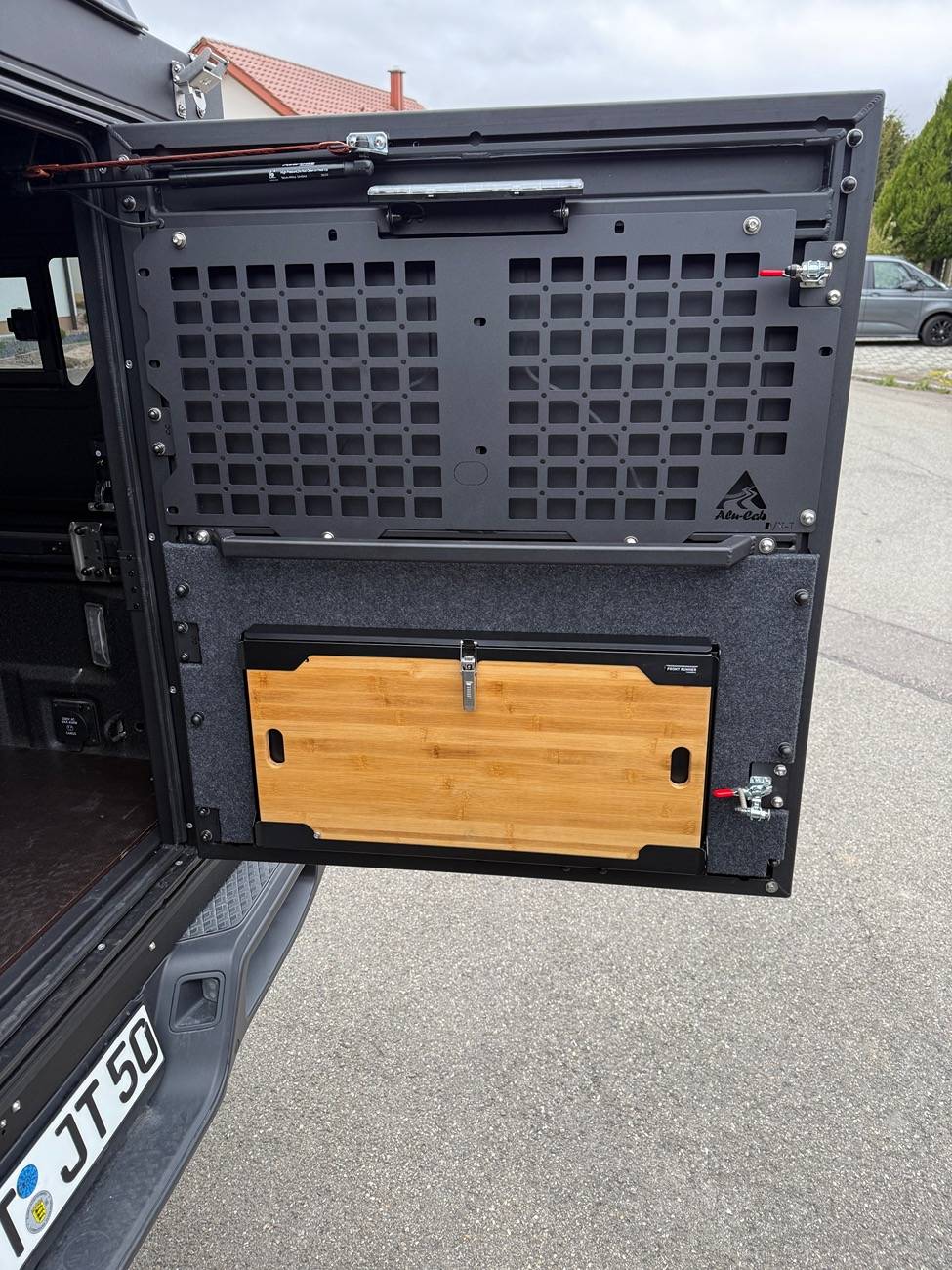

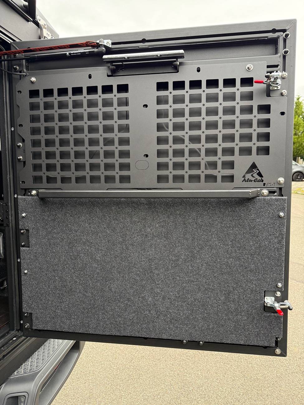

today the 2nd Frontrunner table for rear door should show up, first was damaged and then tomorrow hopefully last bits, so that we can build stuff on Friday and start Saturday :)

Disable door-open and seatbelt chime
Jeep Gladiator German Overland build to explore Europe - EcoDiesel 1744835373322-bx
Source: https://www.jlwranglerforums.com/forum/threads/disable-ignition-chime.23031/
Post #4 written by jeepixel
- This disables the chimes, but does not disable the warning lights
- I have not figured out how to disable the seatbelt warning light (constant, not flashing)

Thank you.
its only described how to disable seatbelt chime, and this works for me.
its important for us, as the dog is with us in rear and so I don't want the chime all the time, we usually use seatbelts....
but how to disable the door open chime?

Some more updates from yesterday‘s work:
battery still got to be placed, but first I have to remove everything, and install drive-in nuts from bottomside of wooden plate to „fix“ everything on it.
I ordered some other product from 813, will install when we are back from the trip!
Jeep Gladiator German Overland build to explore Europe - EcoDiesel IMG_8283
Jeep Gladiator German Overland build to explore Europe - EcoDiesel IMG_8282
Jeep Gladiator German Overland build to explore Europe - EcoDiesel IMG_8273
Jeep Gladiator German Overland build to explore Europe - EcoDiesel IMG_8278
Jeep Gladiator German Overland build to explore Europe - EcoDiesel IMG_8280

Thank you.
The first disable action listed (seatbelt) should disable both the door-open chime and the seatbelt chime.
Update: Some content has been removed from this reply and will be reposted in a dedicated thread at a later date.
