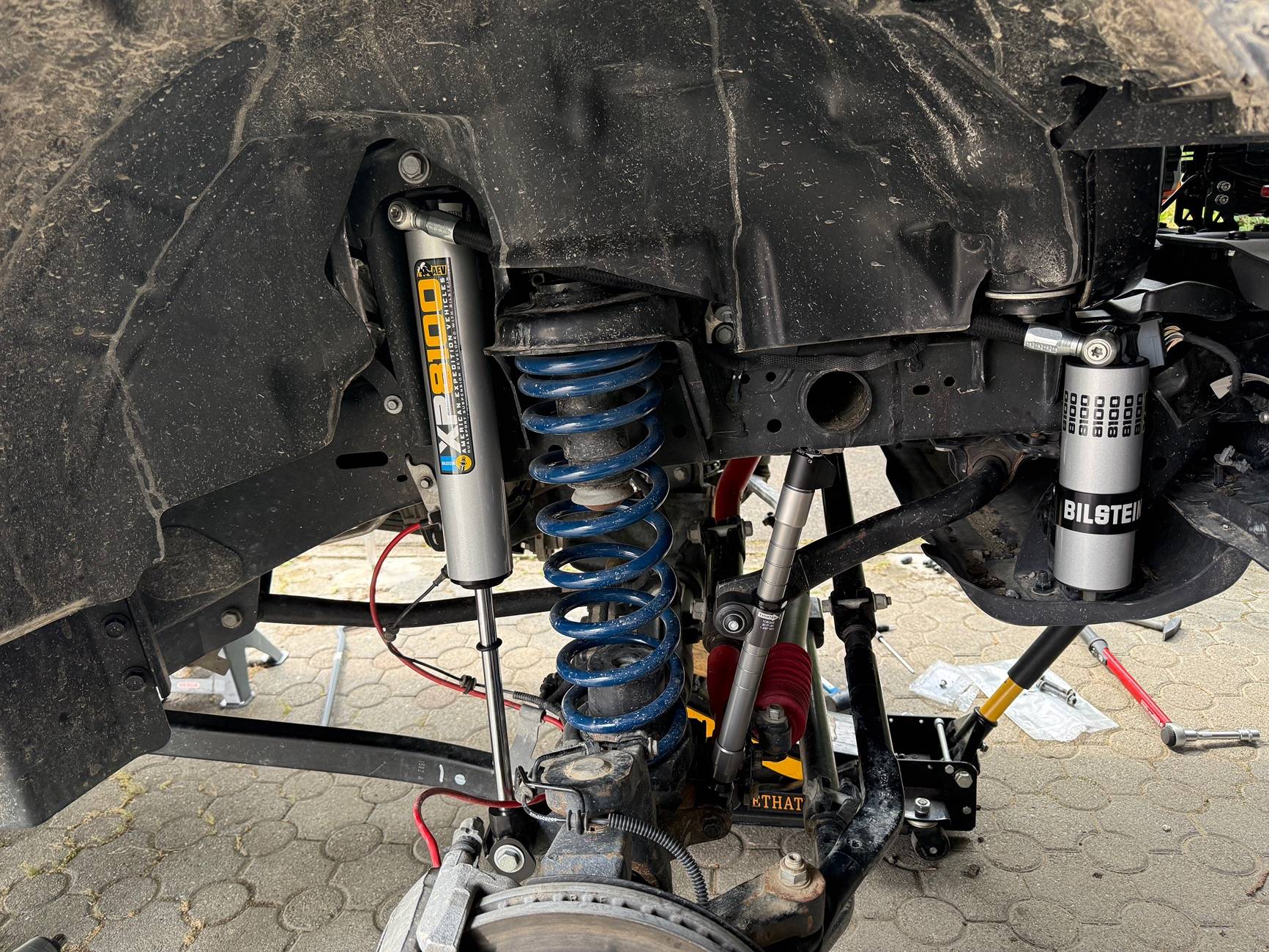

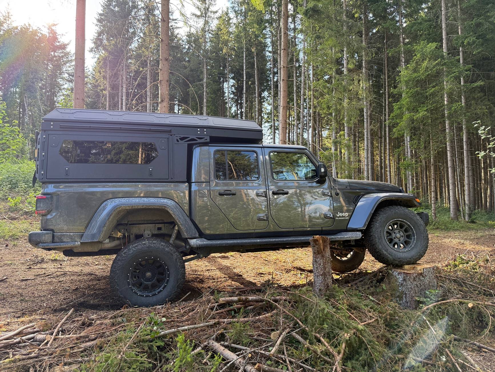

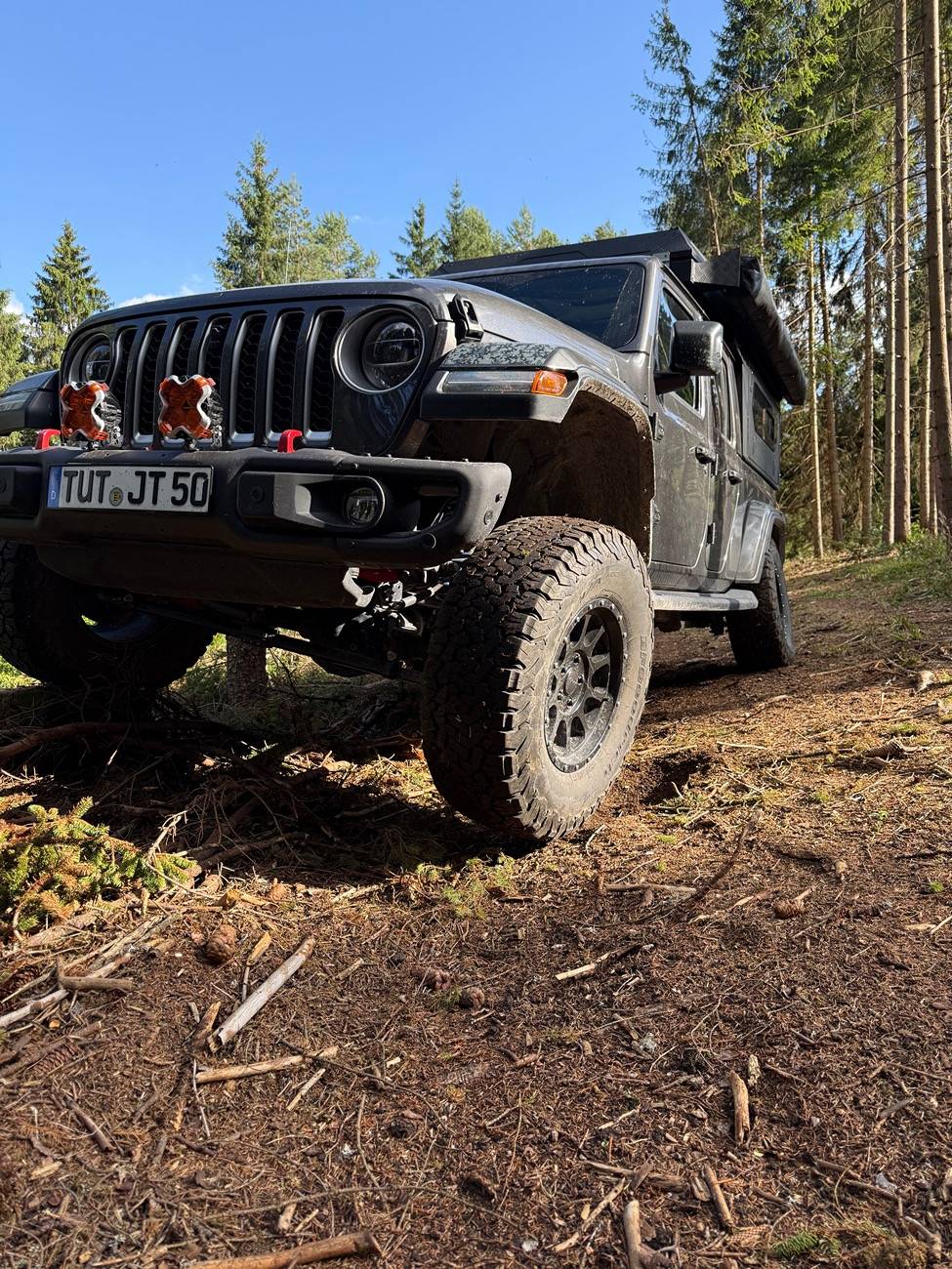

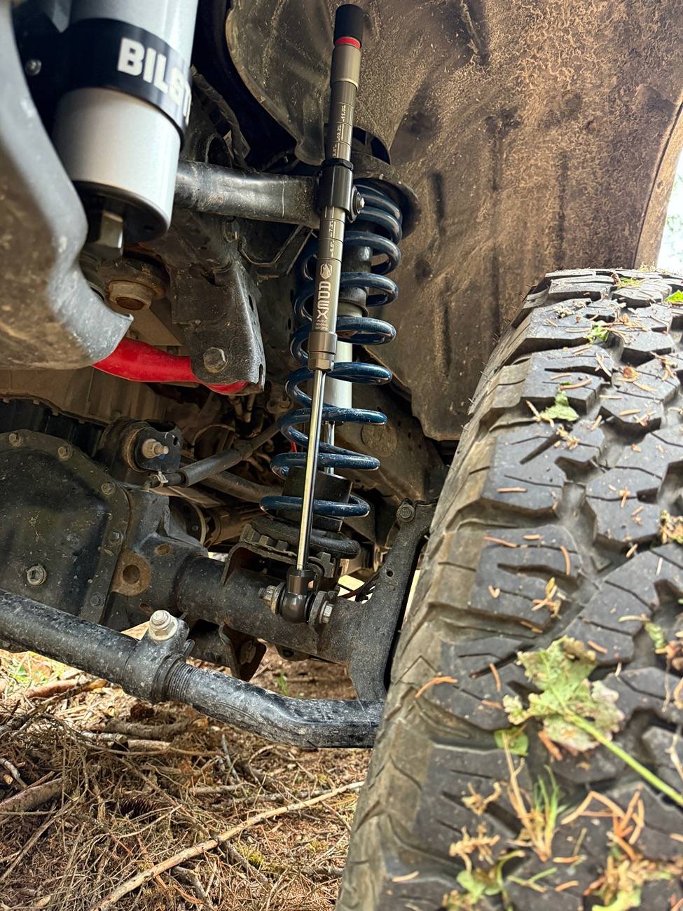

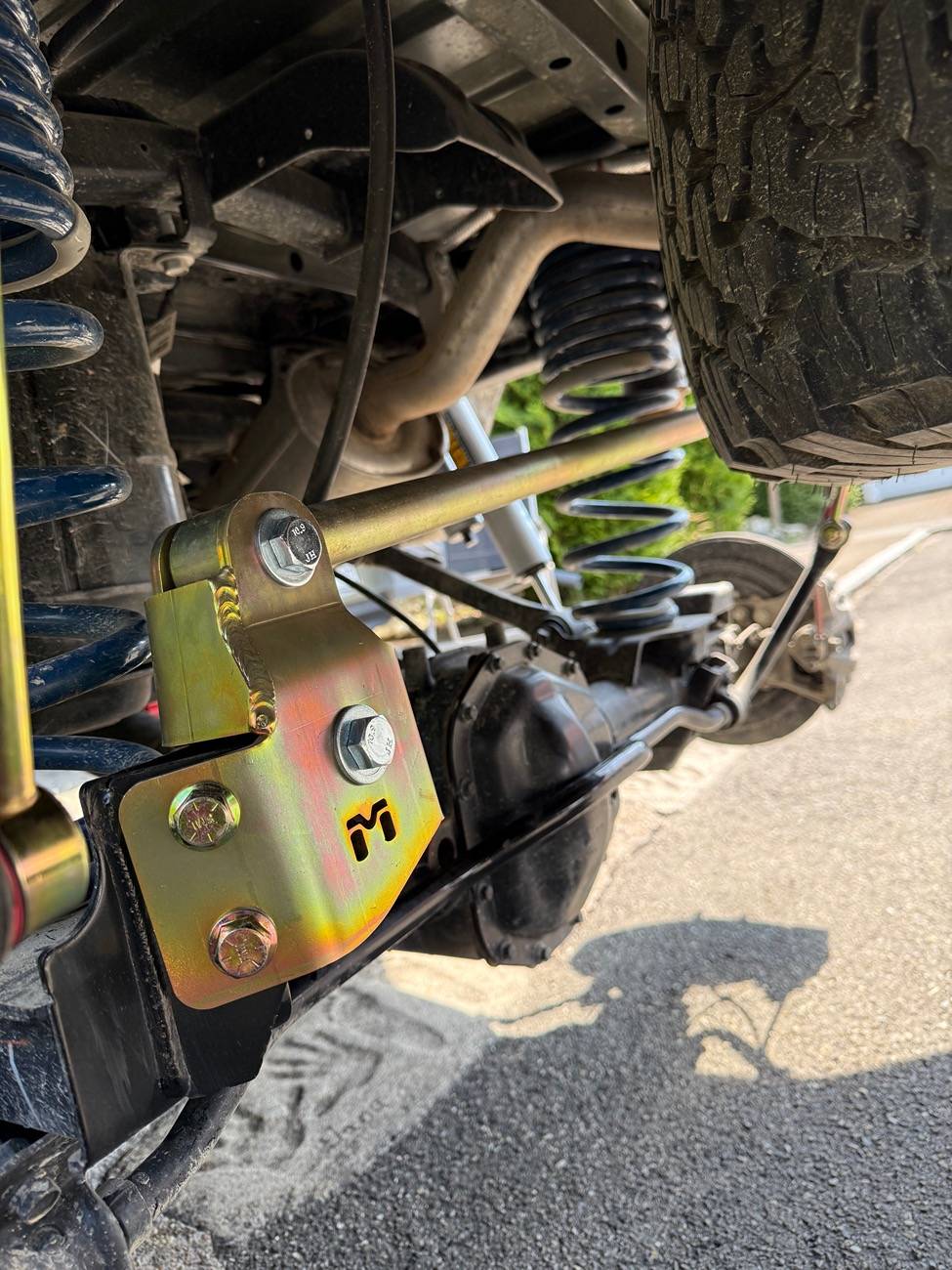

Just doing some updates on suspension:
As I am missing front flex a lot vs rear I ordered the Apex Autolynx… will install them today.
We did some trip to French Alps recently and will be in Portugal later this this summer.
Installed the Metalcloak rear sway bar relocation bracket as well.
There are waiting Bilstein 8100XP tuned for the High capacity AEV springs as well…

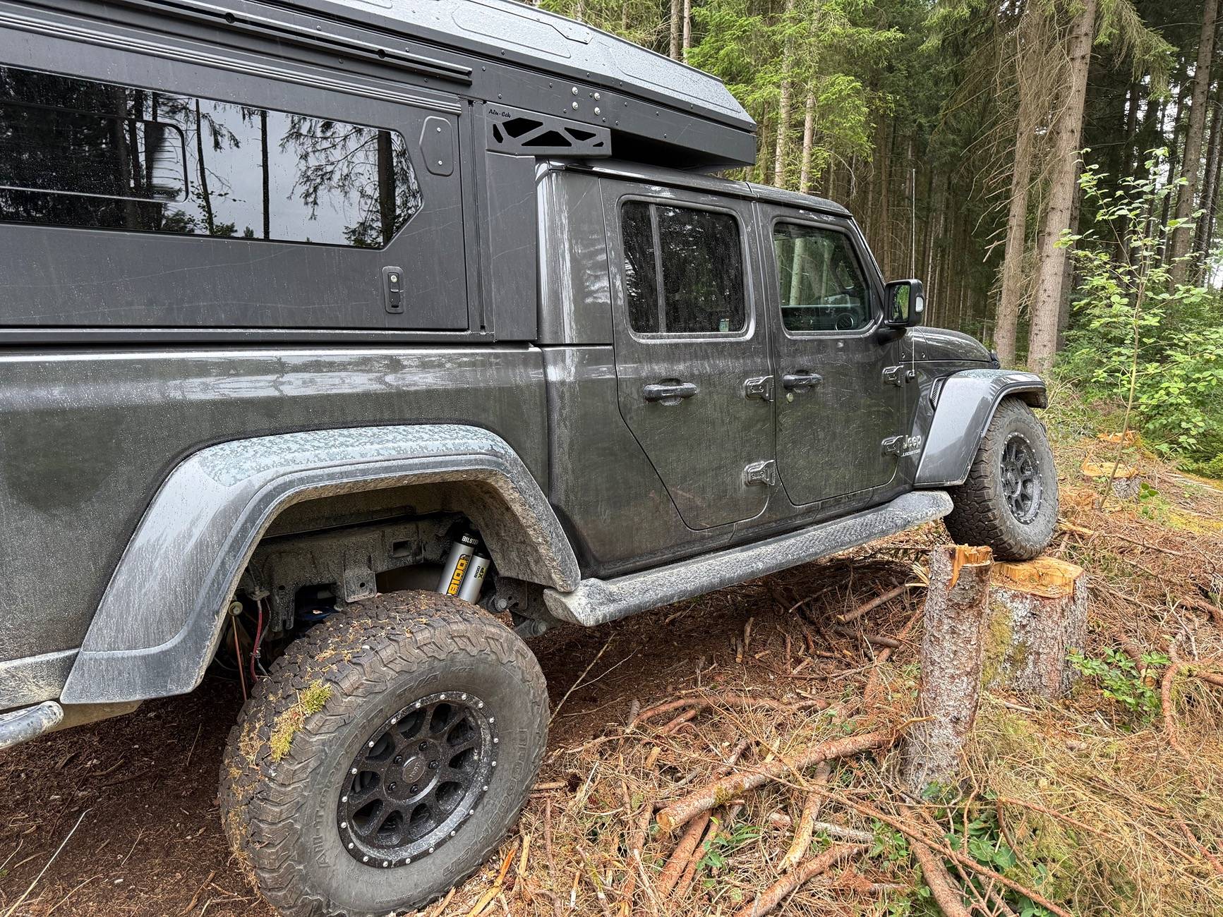

On attached pictures, when passenger front is on the stump you can see other wheel is in air, don’t hit limiters in front.
I will go to this stump again once Apex parts are in…

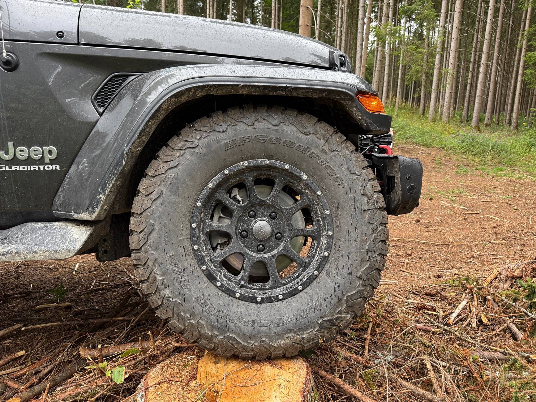

37s are on the car meanwhile, KO2's with winter sign....
