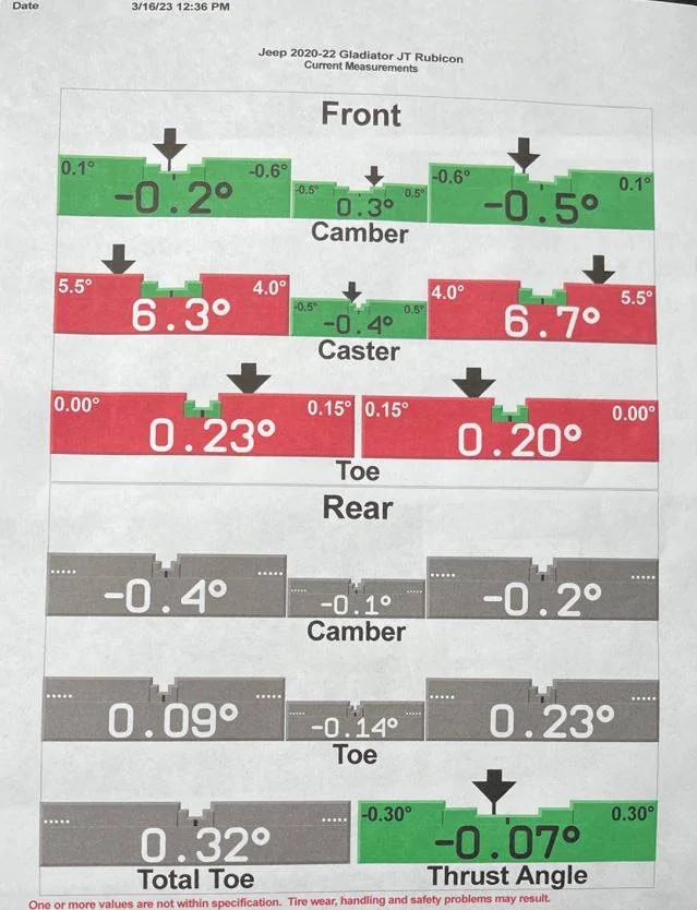

Attached is a copy of the alignment done on my 22 Rubicon yesterday. The tires are standard 33” Falken A/Ts and the suspension is also stock except that I've installed a set of the longer lower control arms that come with the Mopar 2” lift kit. The Jeep drives very well and doesn’t wander at all. Both my caster and toe are higher than spec, but my tires are wearing well with a little over 12k miles on them since going to the longer LCAs. I do get blown around a little at highway speeds in a stout wind but not much more than my F150 did.
Jeep Gladiator Getting a 2023 alignment, or not.. Alignment on 3-16-23a
