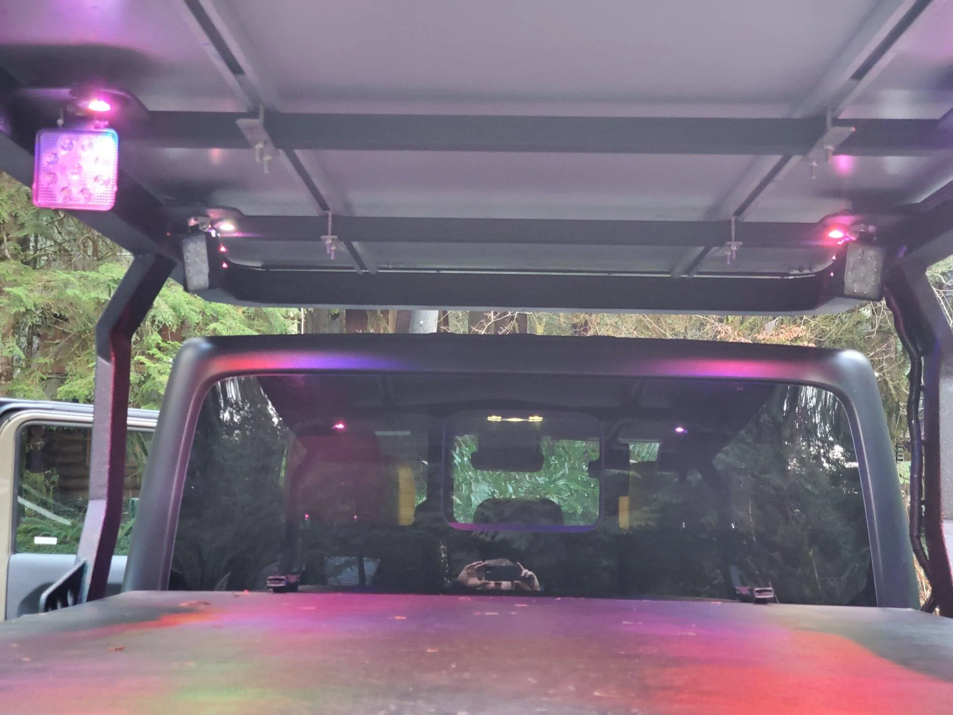

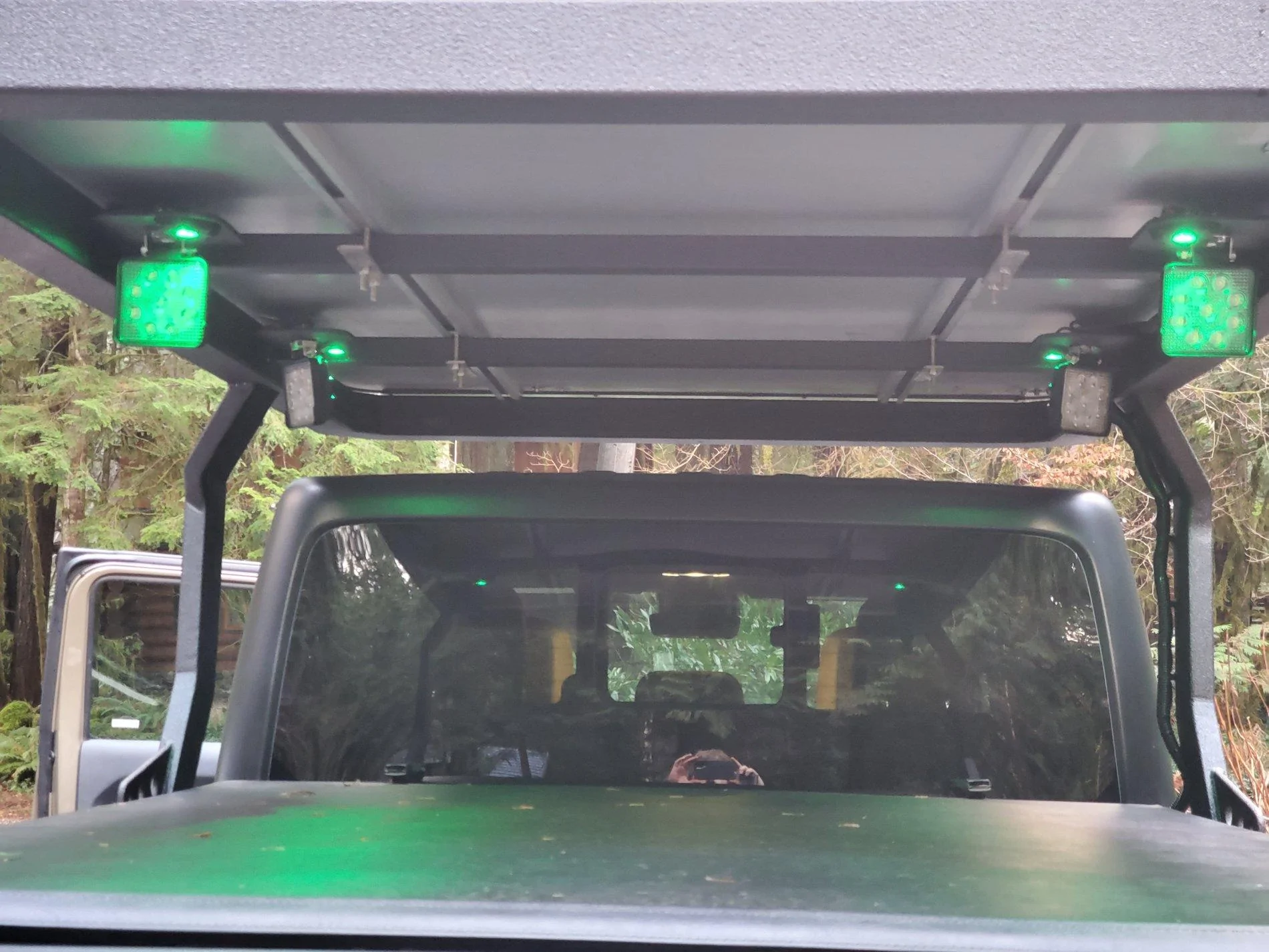

Added some Oracle rock lights to my bed rack a while back just to give more down lighting to the bed when it's dark out and I need to more bed lighting. They are the underbody rock lights but they seem like good lighting for this application. They are color changing but I usually leave them on either green or white. Although the white is not truly white for some reason. Need to ask oracle about this.
Jeep Gladiator GlacierGladiator's Wayout Gladiator build 20200202_163856
Jeep Gladiator GlacierGladiator's Wayout Gladiator build 20200202_164030

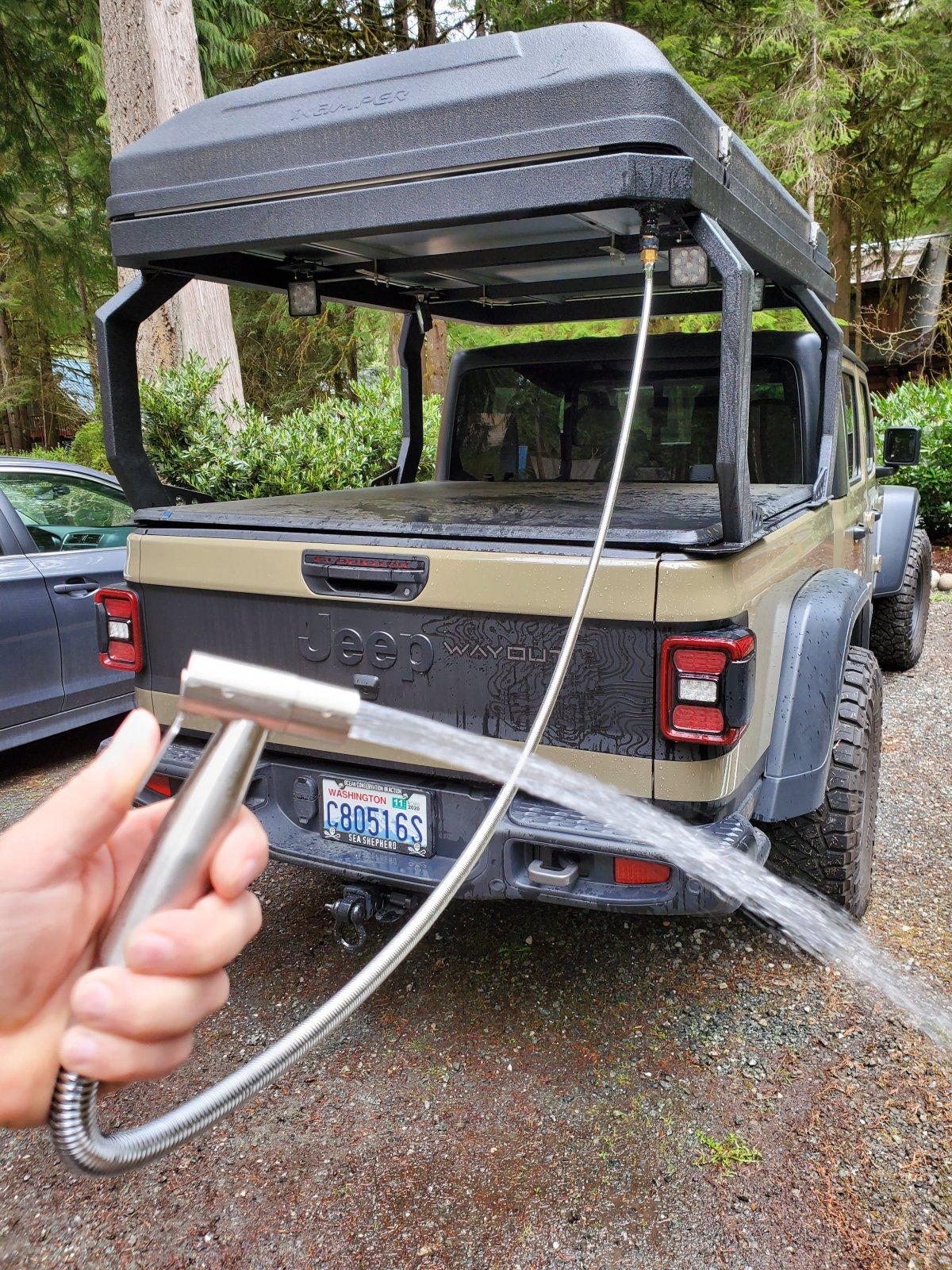

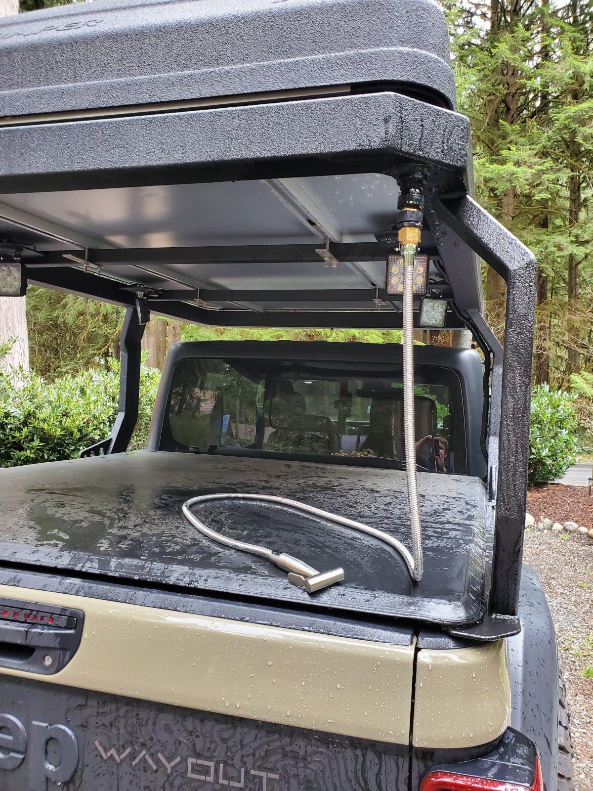

I was able today to finally test out the water storage system built into my rack. It holds right around 10 gallons of water. Without needing to pressurize the system with air, I was able to run my shower sprayer for 12 minutes. I'm thinking this should be enough for 4 quick showers.
Jeep Gladiator GlacierGladiator's Wayout Gladiator build 20200424_161857
Jeep Gladiator GlacierGladiator's Wayout Gladiator build 20200424_162506

Super cool build...have the same tent and a very similar set-up...how do you fill your water in the rack?
GlacierGladiator
GlacierGladiator
Sep 25, 2019
32
623
860
98244
2020 Gator Gladiator Rubicon, 2018 Subaru Legacy, 2012 Mercedes Sprinter
Just hook a hose from the house right to the quick connect one way valve. Fill it up and disconnect the hose and the water stays put. Then just connect my shower attachment to the quick connect when I want to use it. There are close up pictures of the fittings a few pages back.
I'm think for overlanding fills I will carry a collapsible bucket & small pump. Just plug the pump in at the bed and fill it back up with river water or rest stop on the road.

A couple of comments about your "water tank"
First, without some sort of vent on top at the highest point, you'll never get it filled with water. If the air can not escape, it will not be compressed by the water and will take up volume that you intend for water.
Second, the outside air temperature has nothing to do with your water temperature in the daytime. Aluminum, which transfers heat easily, coated black will heat up to a higher temperature in direct sunlight than what the outside air will ever reach.
If you fill with water from a hose bib (appx 50 degrees) in the morning and then go wheel all day in direct sunlight, by mid-afternoon the water temperature is much higher than you think AND the pressure inside the tubing has increased greatly.
You may want to consider installing a bung on the topside somewhere where you can install both a manual vent and some sort of safety relief valve.
GlacierGladiator
GlacierGladiator
Sep 25, 2019
32
623
860
98244
Thanks for checking out my build & giving some input.
I have to disagree with you here. This set up was based on versions already in production like the Yakima road shower. I have already filled it so I know it fills up to almost completely with water based on the calculation of volume that I did. The air becomes compressed, yes, and helps to pressurize the water. Yes some volume is lost but very minimal and if I wanted to bleed it off I could do it thru the Schrader valve I have installed. I calc'd it out to be about 9.5 gallon capacity and when I filled and released all the water thru the sprayer set up at half throttle (.75 gal/min) it took 12 minutes. So at the most there was a half gallon taken up by air.
I'm no expert in how water heats up when exposed in a aluminum tube, but again there are commercial versions of these in production & people making their own versions out of black ABS so if the water heated up to a point to scald people then nobody would be using them. If I lived in the desert maybe yes but wheeling or driving forest roads here in WA you are mainly always under the tree canopy. Anyway I'll find out this summer but I'm 99.9% sure the water will never heat up past 120 degrees for sure.
After looking at the road shower more closely I do have to agree that pressure combined with some heat may be an issue so I will be installing a relief valve so I don't cause damage to my rack.
I already have a second port with a Schrader valve so I will either get rid of that for the relief valve or T it off and add a relief valve. From my test this far I really dont think I will ever need to add pressure to the tank as there was plenty of pressure from just filling with a hose. Now if I fill in on the road with a bucket & pump I may need to add some air pressure but I won't know until i try this method out.
